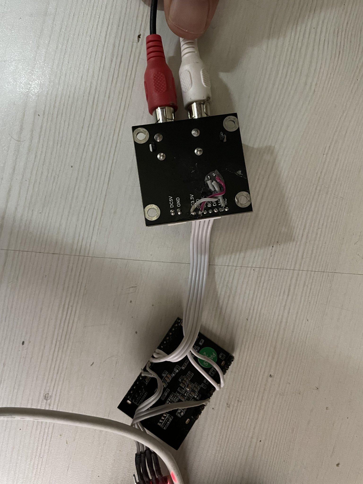

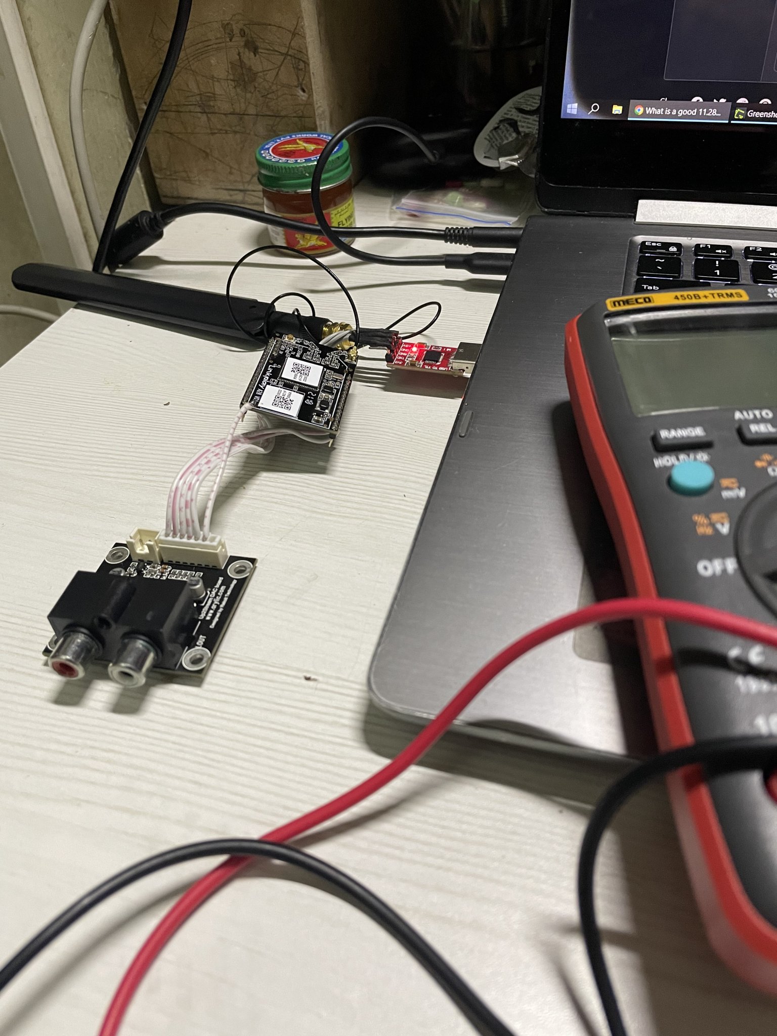

Well that ref clock pin #37 didn’t work, I will see by giving it a pull up later in the weekend.
I currently tried a 50MHz txco connected as seen in the image and I have audio
infact the linkplay device announces “connected to your Wi-Fi” 😬.
During airplay the volume changes are sluggish. I feel the bass is a bit low but that might be the ESS9023 dac may be.
It is Arylic’s DAC board.

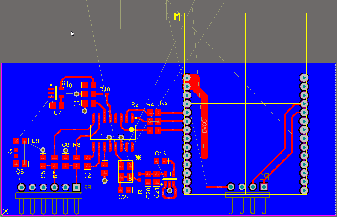

This the PCB i am working on for the adapter and need input from experienced builders.
the board has been divided for the chip as per my understanding of the digital and analog side, its a ES9023P.
i have kept the wifi module hanging a bit off as thats where the antenna are are located.
I will be running the module directly from 5volt and the 4 pin socket is Vcc Dgnd Rx TX
the connect on the lower left of the pcb is the analog supply of 5V, Agnd, Agnd , Right out and Agnd , Left out.
the Blue stuff is the bottom copper pour and red tracks are the top layer.
R9 and R10 will be 1uH inductors.
i know there would a lot of issues on this board so i m hoping for some constructive inputs to correct it.

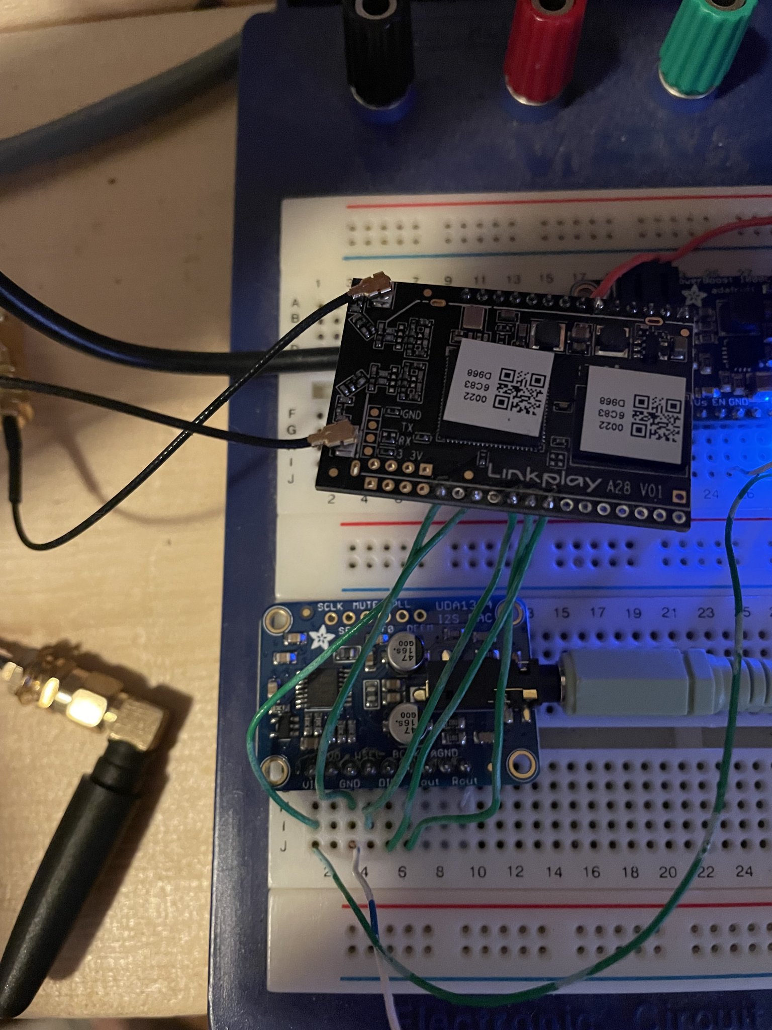

So I finally had time to test my board. Photo is attached here:
I'm able to successfully connect the A28 to wifi, can see the webpage at its IP and am sending successful GET requests. However, I have no audio out of my DAC. Everything is connected correctly and the DAC I'm using does not require MCLK, any thoughts as to potential issues?
Thanks!
Thanks!

Please check if your DAC is hardware mode compatible ie it will send out audio without configuring any registers

I'm fairly confident that my DAC doesn't support I2C control at all. I've connected it to a Raspberry Pi Zero and successfully output audio using just the three WSEL, BCLK, and Data lines. I've linked the UDA1334A datasheet below:

I would recommend you try updating the Firmware on the board to work in slave mode - I sent you a pm.@aditya thanks for the reply!

I jumped to the conclusion that it has i2c because of the SCLK marked pin on the top left of the image.
I apologize, I genuinely did not dig much deeper into the board you are using. - it was past midnight when I saw your post and was forcing myself to finish something that is still pending.

The UDA1334A seems to be a similar chip to PCM5102 since it doesn’t need mclk where as the Arylic DaC chip ES9023 needed the 50MHz clock on the MCLK pin to work.@aditya no problem!! It was a fair suggestion, forced me to delve deeper into the UDA1334A datasheet which is never a bad thing!

Immediate success!!! @aditya and @psmith001 you both have saved me. It's a shame Parts Express isn't including the API documentation and the firmware tool when they sell these.
