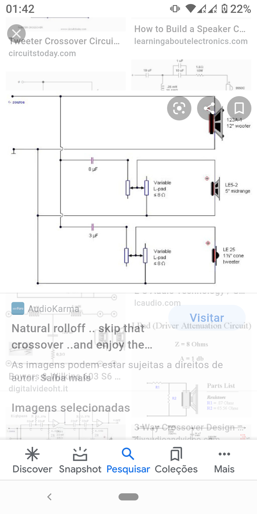

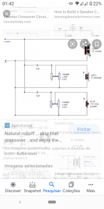

Some speakers have a simple crossover with 2 caps and a L-Pad for the magnitude where you can adjust the level. It might help.

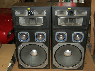

I have repaired "consumer" products, think Sony-Aiwa-Sanyo, etc. , boasting of , say, "4 way", and actually housing a "woofer" , (at least it was the largest one and had a foam edge) connected straight to cabinet terminals, 2 "midrange", actually cheap table radio or PC speaker quality ones, sharing a single 10uF capacitor and a cheesy "tweeter", actually a PC monitor 2" or 1.5" cone speaker with a metallized plastic dome glud to cone just for (cheesy) looks , through an 8uF capacitor.
WTF?
Cabinet impedance must have been around 2 ohm at higher frequencies. 😱 since all are wired in parallel
Killer futuristic look, cabinets seemed to be made by NASA or sometyhing and OBVIOUSLY sold on "looks" , not performance.
So I am not surprised by what you found.
As a modern example, just imagine the HORRORS inside this one:
Boasting:
* 360° Sound !!!!
* 360° Lights !!!!
* JET BASS!!!!
* TAIKO DRUMS!!!!
* MEGA BASS!!!!
(and you are surprised mid bass overpowers EVERYTHING ELSE?)
Not a modern world aberration, look what they made and sold 30/40 years ago!!!! 🙄
[attached below]
Don´t worry about the ultra complex crossover, because there´s none of the kind, they probably managed with a grand total of 3 (three) capacitors. 🙄
