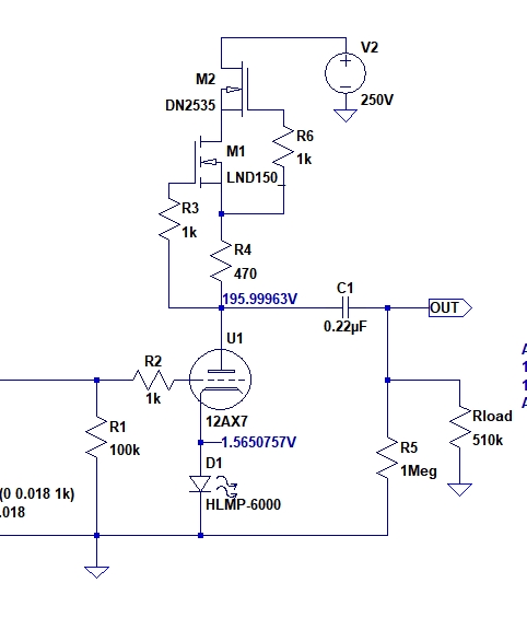

If a cascode of about 1mA is desired, one way to increase the Vds of the lower device is this:
Replace the upstairs device with a part that requires more negative Vgs at the operating current. This is easy - the DN2540 will require more than 2V negative in this situation; compare the LND150, which requires almost 0V for the same current.
So try this: DN2540 upstairs, LND150 downstairs.
The thing to do is make a cascode CCS with a DN2540 on top and an LND150 in the bottom. About 50V needs to be dropped across the DN2540 for it to turn on hard enough to reduce its interelectrode capacitances to reasonable levels.

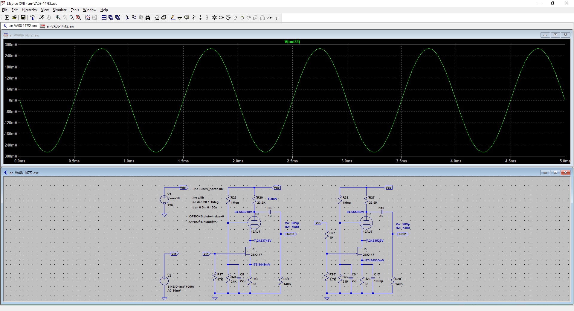

Would you please post a schematic of your JFet-Triode cascode?
Sure.
A few things:
  • This is not easy to reproduce because it's based on the super unobtanium 2SK147, plus it requires the selection of Rs for the desired Id and noise. You may get away with paralleled 2SK170 or equivalent
  • This is an early iteration of the gain cell. I'm currently fighting some ground loops (of course), so I have no idea how it sounds. If it works, remind me to post the complete schematic.
  • You'll need to rename z.txt to z.lib and put it somewhere LTspice can find
  • The gain is 280, thanks to the high Gm of the 2SK147, H2 is -80dB, open loop, so maybe it's worth the trouble
  • z.txt
    z.txt
  • an-VA08-147f2.asc
    an-VA08-147f2.asc

No, I just SIM the hell out of it before I commit to the soldering iron.
The major difficulty is to guess at what would make the JFet happy (operating point), then decide on a Rs that could achieve this, then measure the physical JFet with that Rs to confirm, then plug the measured Gm (Yfs) back into the simulation model, then try a bit higher/lower, adjusting Rp (load resistor) all the while, until you're bored silly. 🙂

Rod Coleman's recommendation from six years ago... (see attached illustration)
- The cascode of DN2535 and LND150 drops about 50V
- It seems to work well with current of only 1mA
