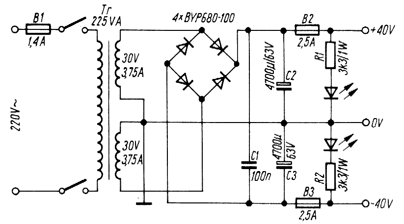

simple bipolar power supply
Hi
how can I use this eschematic (or a simple one like this) to work with a sec. 24-0-24V, 5A transformer and give 30v (bipolar)?
I can't find a schematic to give 30-0-30. I hope someone can help me.
thks all
