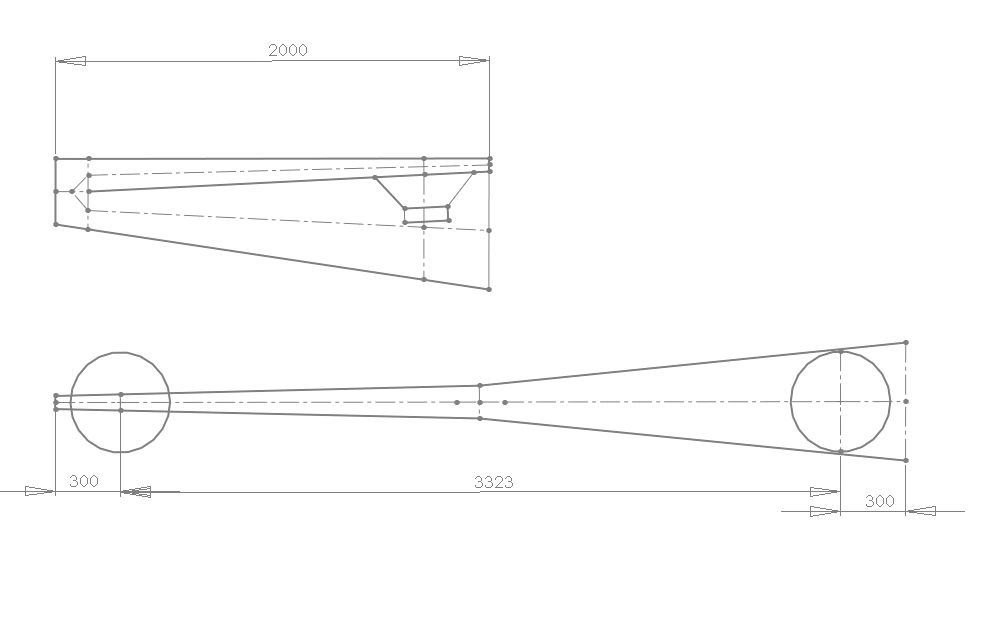

Hello,
Im planning to build a big horn subwoofer that is as easy to build as possible. Space is not really an issue and i pretty much want to put as little effort as possible to get the most sound. In a way i want as few folds as possible but still a decent size.
Im not familiar with hornResp or the other programs so if someone could help me out it would be nice.
Im planning to use the eminence Omega Pro 18C or 18A, depending on how many i will build, but if there is another speaker out there that gives better value i would like some recommendations. (It would be good if Thomann Cyberstore have them).
I made a quick drawing and wonder if you could build them like this or something similar. The only requirement is that they should be about 150 cm wide at the opening and 180cm long.
So in summary and easy build, but hopefully a big sound.

I like the Trapezoidal shape for a tapped Horn layout as you have drawn it.

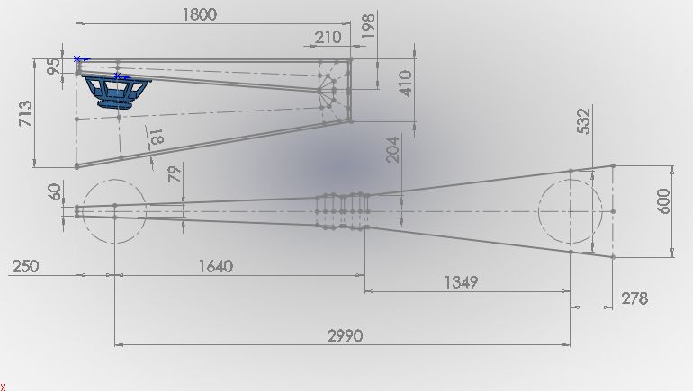

It is still a fairly simple cabinet but has the added flexibility of being able to vary the taper of the horn half way along its length This would probably give you enough flexibility with the layout to acheive a reasonable response with a variety of drivers🙂 Did a quick sketch to show what might be possible..... I would keep the side panels parallel to simplify construction
Regards Xoc1

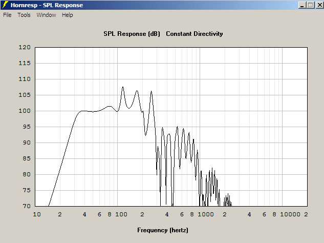

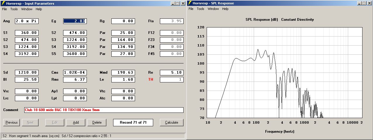

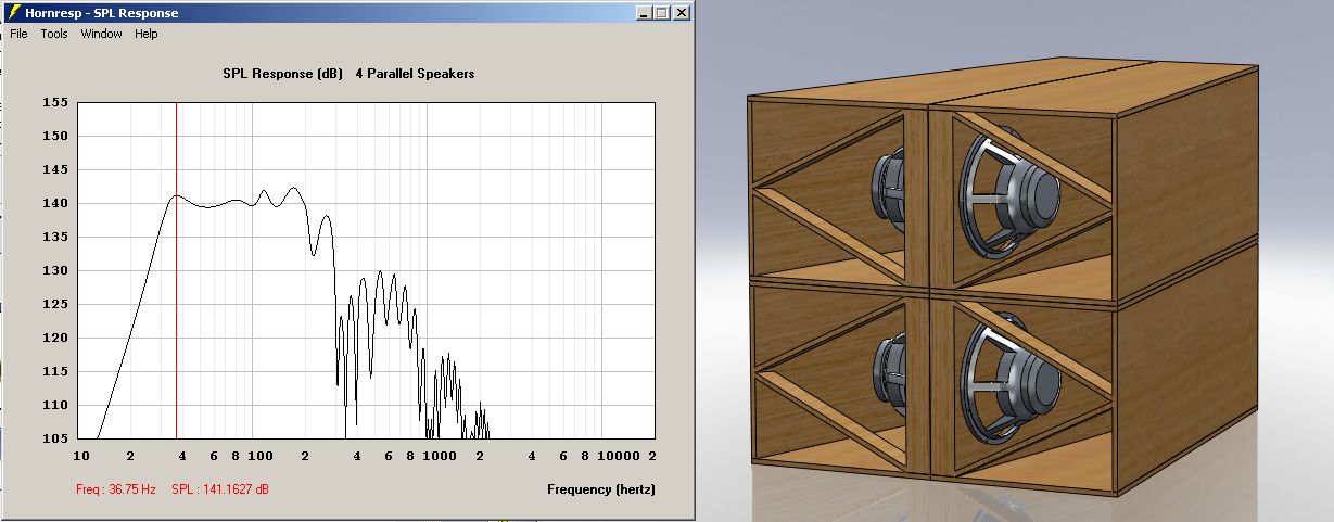

Modeled up a single speaker cab. First attempt! TBX100 and 600 wide internal.
As TB46 suggested Download Hornresp and have a go! Looks quite good in multiple cabs!😀
Regards Xoc1

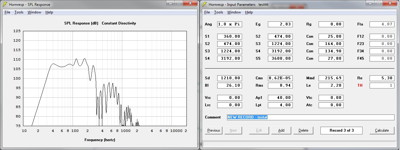

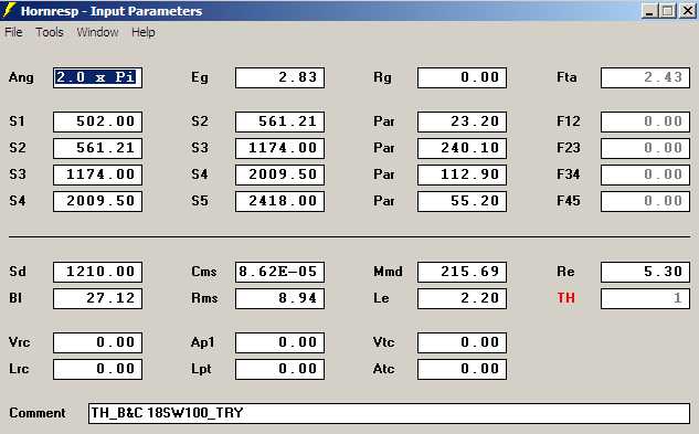

I put the 18sw100 with the same design and got the result shown in the pictures. Looks better than what i could come up with after a few attempts 🙂
Not sure if i got the speaker parameters right though, i think hornresp calculated some and the rest was from the manufacturer, so if someone could take a quick look on that it would be nice.

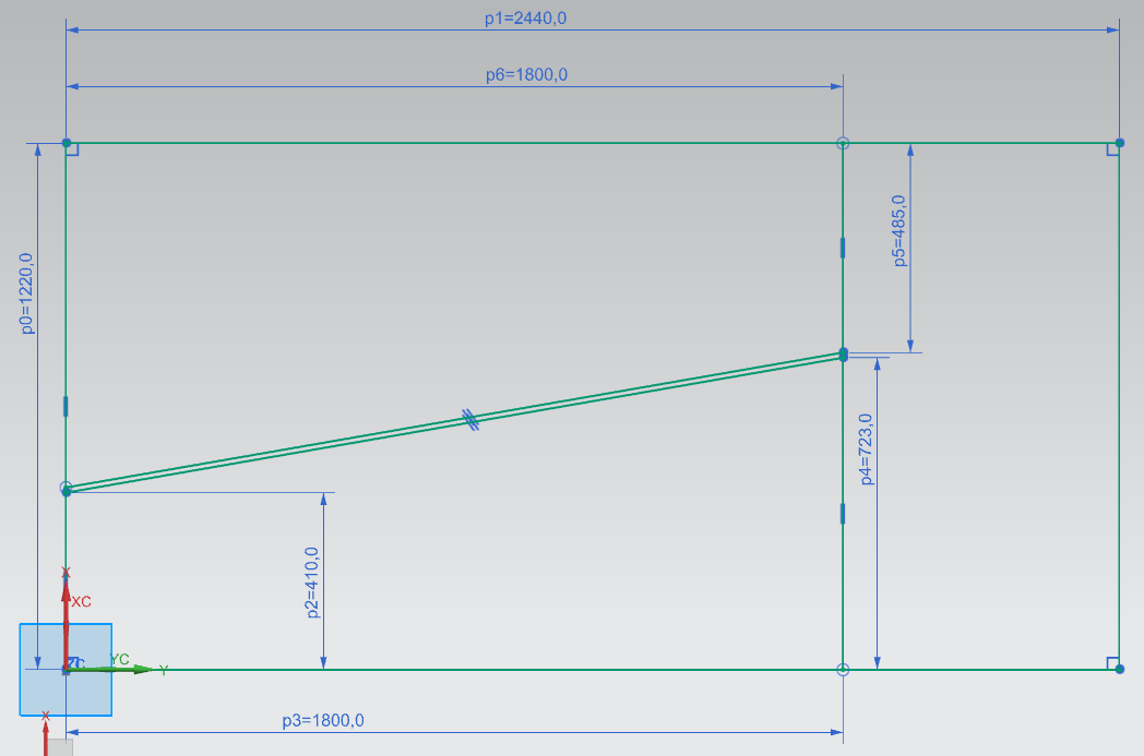

The raw material im going to use to build is mdf board 1220 X 2440, so making the double horn wont me possible with that one, but doing that design and just putting them together afterwords will just make movement easier.
So than maybe design to have as little spare as possible, for example making the dimensions so the 410 + 713 would end up as 1215 together, and maybe modify the with so its 610 so its just to cut the board in two to get the pieces needed. Just adding an example picture so you see what i mean.
I will try some more with hornresp tomorrow to see if i manage to get any results myself.

Hi elleman,
Your Hornresp Input for the 18SW100 looks basically fine to me; I end up with a slightly different Bl using Hornresp to calculate the value, but nothing major. Without Vtc/Atc you don't need Ap1/Lpt (but I think Hornresp just disregards the values in your example?).
By the way, if you double click on Sd (while in the Edit mode) Hornresp will show you the calculated T/S parameters. The Ang value should be set to 2.0 x Pi for general comparison purposes.

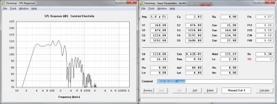

I'll attach the Hornresp Input (using the 18SW100) for another one of Xoc1's designs, this 6 Fold from wood1y's thread (this one was perfect for the 18TBX100) http://www.diyaudio.com/forums/subwoofers/170749-15-tapped-horn-rcf-10.html Post #98.
I'll also attach a quick simultion for a 25Hz TH, with the SPL for a group of four. Gets to be a big box fast. 🙂

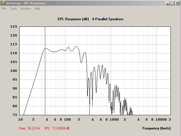

Hi Elleman
I had a little play around with the parameters in Hornresp but failed to come up with any real improvements. All speakers are a compromise between many differing requirements, and it is finding the right balance for your application that is important.
Increasing the width to 610 will have very little effect, but if you add bracing to the cabinet then this still leaves the 600mm internal dimension nearly correct. If you have offcuts then use them to brace the panels as due to the simple design the panels are very large!
The cab really needs the driver to have a big Xmax. Lower excursion drivers would need limited amounts of power to avoid damage
With the 18SW100 with its 12.5 Xmax, Xmax is reached at about a theoretical 77.46V (750W@8R) so doubling up that for thermal losses makes probably 1.5KW + per cab practical, with the correct hi pass filter.
Sim of 4 cabs at 12.5mm xmax and pic atttached😀
Regards Xoc1
