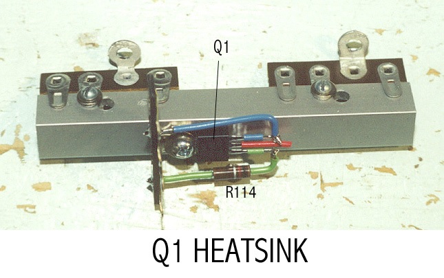

I'd still be interested to know what's going on with C104 & R113 on the cascoded MOSFETs. Doesn't look right to me, Q2 is going to end up dissipating nearly all the heat?Complete Article published in AudioXpress Magazine 2004.
OK Merlin, the cct does not defy the Laws of Gravity or deny Kirschhoffs Laws of electricity.. At switch on C104 forces equal voltages across R111 & R112 so that Q1 & Q2 share the full voltage drop from the rectifier stack to the load.
As you have pointed out, Q2 will eventually drop nearly all the excess voltage & dissipate most of the heat. That allowed a large Wakefield heatsink on Q2 & a much smaller heatsink on Q1. That formed by a simple piece of extruded Aluminum.

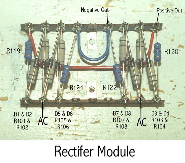

Some folks may wonder what so many rectifiers & resistors look like in one place. For a 'One Of' build it hardly makes sense to cobble together a PCB. That coupled with the fact I'd never done a PCB, a very simple solution in this case uses a pair of terminal strips. Temporarily mounted on a wood scrap, all the parts are put in place & solder applied. A simple & slick solution. I've often used that technique with very good results.🙂
