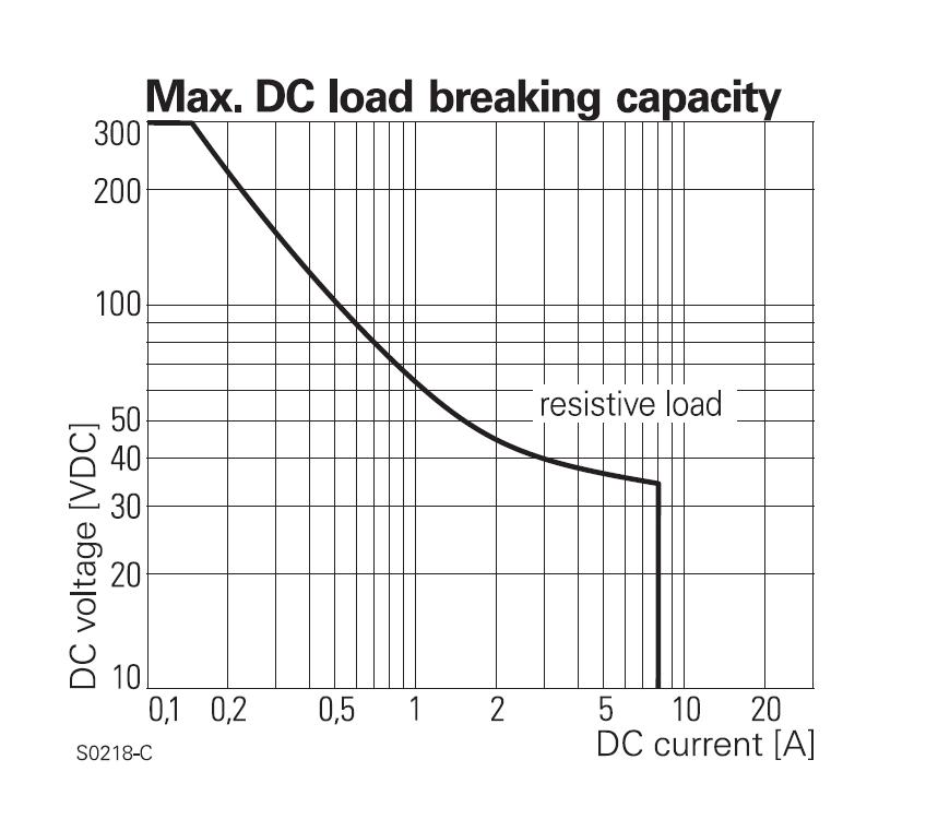

Other issues with relay contacts include (1) contact bounce, (2) arc quench on contacts opening, and as pointed out with respect to voltage rating, voltage/current rating.
As the voltage goes up the current rating goes down, rapidly. Most of the small relays I've seen suggested or used are overstressed.
A relay with a general purpose rating of 100,000 cycles at 10A 250VAC (8A 30VDC)may only be good for a couple thousand cycles when pushed to 300VDC where the current rating drops to 100-200mA.
Here is a chart showing a typical derating curve Notice the current at 300VDC drops to 150mA. This relay can not be relied upon to quench much above 300VDC. Contact life is very short. :

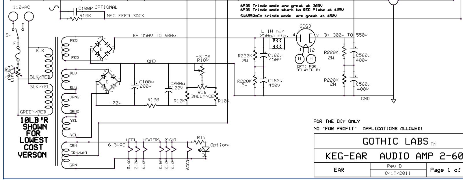

Pass - regulator for B+ and shunt regulator for bias are connected in series and powered from the same rectifier sharing the same current. Load for B+ is connected in parallel with output of pass regulator, that means current that goes through shunt regulator charges it's capacitor, and speed of increase of this voltage is proportional to current through load. That means, while tubes are cold increase of voltage is very slow, but as soon as tubes start drawing current speed of increase of the voltage increases.
It causes also proportional increase of B+ voltage supplied by B+ pass regulator, since it gets it's reference voltage from shunt bias regulator.

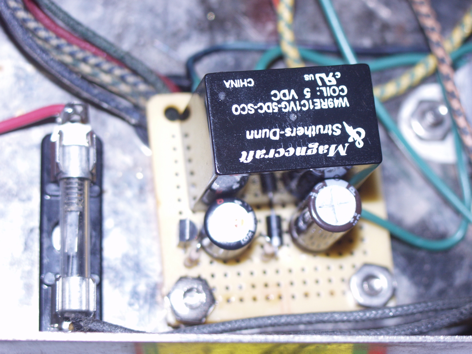

I took a different approach. I had an issue with the operating voltage on the filter cap and changed from a 5AR4 to a 5U4 which dropped the voltage about 25v. The problem was that the 5AR4 was indirectly heated and the voltage at turnon was about 534 before settling back to 503. With the direct heated 5U4 the voltage spiked to 568.
So I devised a relay that is placed in series with the filament of the rectifier, is powered by the filament voltage, uses 5v relay and 10v caps for small size, and delays the power up of the rectifier by 20s which gives ample time for the output tubes to heat up and present a load plus the slow ramp of current from the tube. Doing this kept the surge at startup to less than 490v. Simple cheap and no special circuit, just a relay, diode, filter cap, RC timing and Transistor to drive relay. Resets in 1/2sec when powered off.

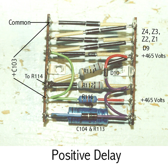

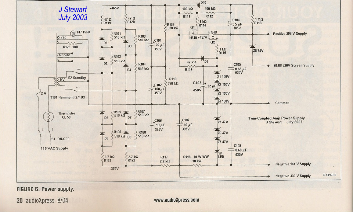

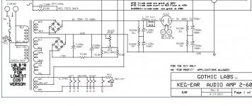

Delay I Used in Crowhurst's Twin Coupled Amp
Complete Article published in AudioXpress Magazine 2004.
All put on a pdf with added information a few years ago.
The line up is a 2-stage diff amp, 6SL7 & 6SN7 followed by PP 6LU8s.
More than 35 watts at clipping & easily scalable for more power.
Delay controlled by R116 & C103.🙂

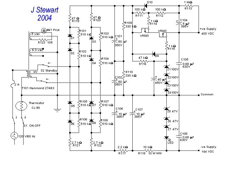

WARNING!Complete Article published in AudioXpress Magazine 2004.
This schematics connects one leg of the mains to chassies ground !!
Equivalent to a "hot-chassies" design.
I think the connection could be removed without any problem.

What's the purpose of C104 & R113 on the cascoded MOSFETs?
Correction
THX to Peter who actually looks at the stuff I post!!. Last night I simply searched my archive for that schematic, this one popped up. It is a preliminary drawing that never got to the publisher.😀
Yes, this one is safe to use, at least regarding isolation from mains.THX to Peter who actually looks at the stuff I post!!. Last night I simply searched my archive for that schematic, this one popped up. It is a preliminary drawing that never got to the publisher.😀
