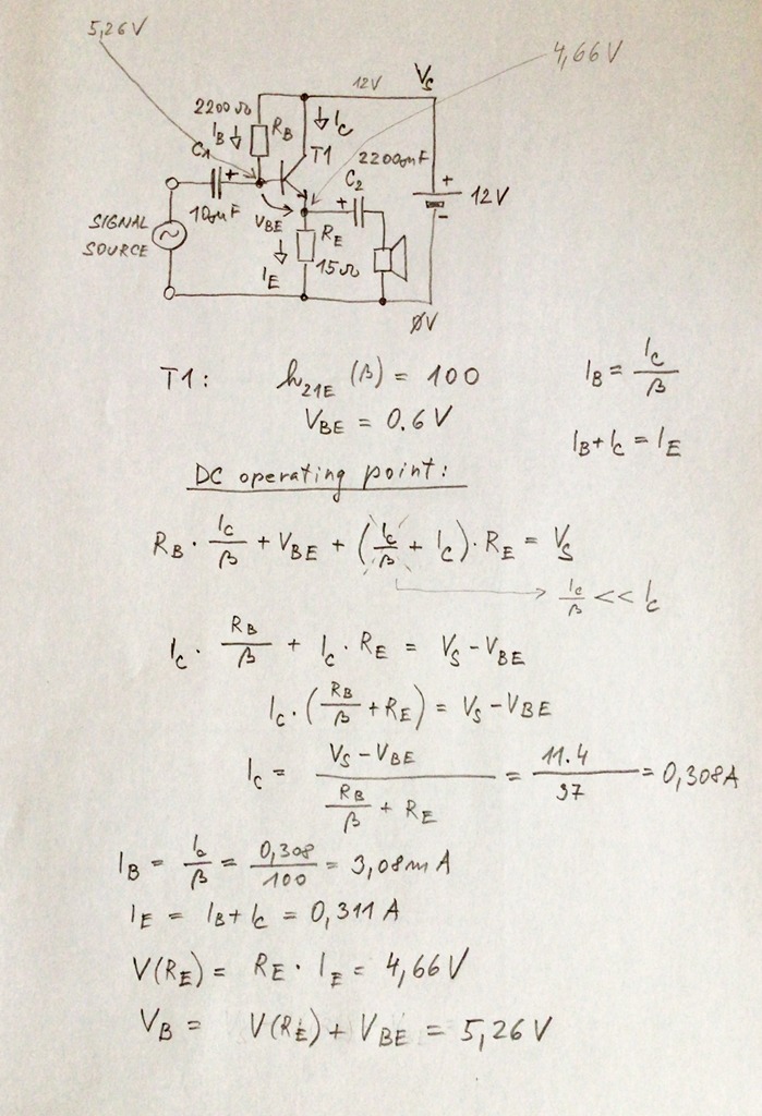

It is a voltage follower. Voltage gain in the configuration I have shown is about 0.85 x. It is still good if you drive it from CD output or mp3 player headphone output. Input impedance is 500 - 700 ohm, depending on transistor h21e. Output impedance is 1 - 4 ohm, depending on source impedance. The lower output impedance of the sound source, the lower the output impedance of the “amplifier”. Anyway, this one-transistor amp would be an ideal start to understand transistor behaviour, if you are willing to learn.

Hi Hugo, starting with DC analysis, I hope it is understandable.

How do you initially select Rb and Re?

I do the choice of Rb and Re based on my professional guess 😀, then I verify by calculation or simulation. You may use the equations that I posted, Ic and V(Re) and h21 (beta) will be your input variables and you will calculate the rest.

I am sorry, but the linked calculator cannot calculate amplifier's input and output impedance and how the load impedance of the BJT follower affects its input impedance and how source impedance affects follower output impedance. You need to use either two-port analysis with Y or H matrices, or full description by circuit equations, or circuit simulator like LTSpice or MicroCap, which is the fastest way. Shortly, input impedance of the follower circuit is approximately (h21 * Re (or Rload)) // Rb resistor.

Sorry, have not seen your image before.
I realise that in this simple circuit the in- and output impedances are too depended on each other.
I presume this is not or less the case in more advanced circuits.
For the input impedance of this circuit we would then have +/- 100*15 // 2200 which would be 900 Ohm.

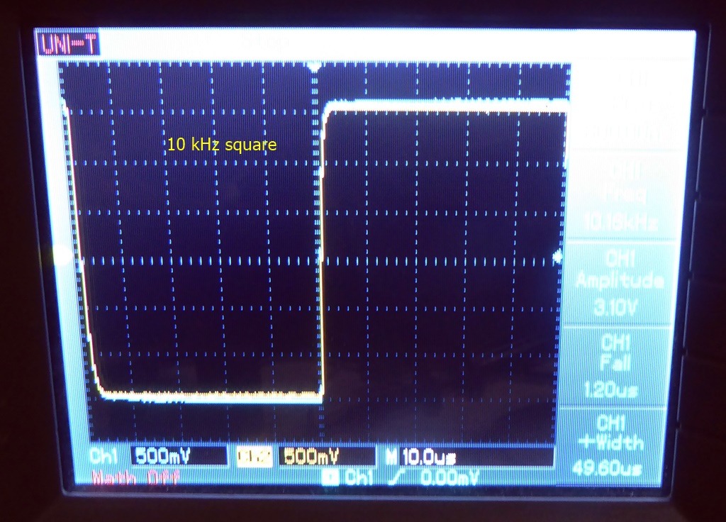

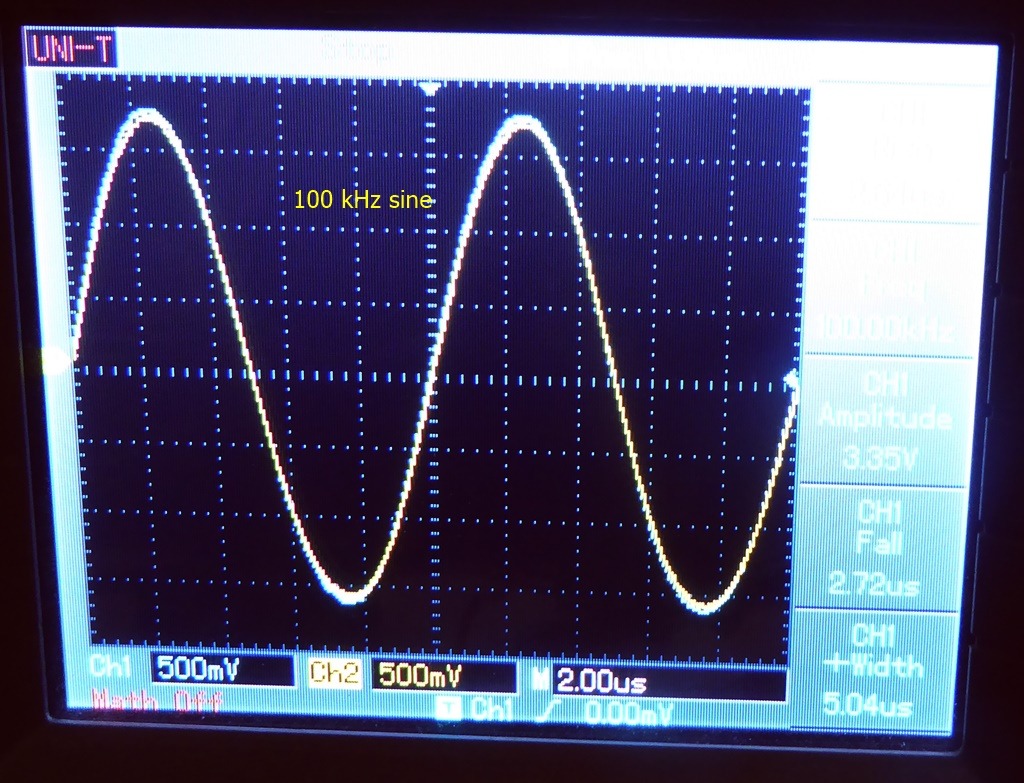

I like playing with these super simple circuits. Below is a response to 100kHz sine and 10kHz square. Both input and output (10 ohm load) shown, input is CH1/blue, output CH2/yellow.
