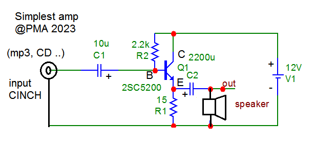

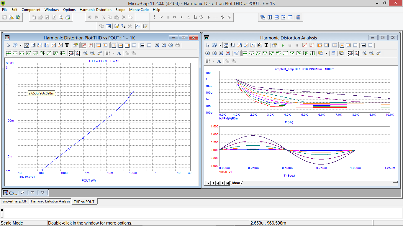

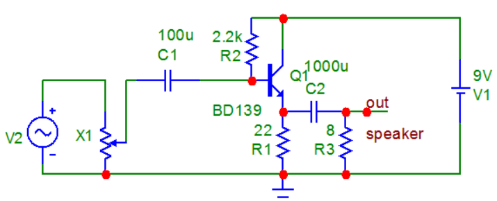

Of course it would help, the question is a degree of complexity he wants to accept. The easiest way to increase input impedance is to use Darlington at Q1 position, like TIP131, and to increase R2 base resistor. Output impedance is good even now, I have just measured 0.35 ohm.

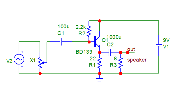

Instead of using Darlington, we could expand the circuit to 2 transistors:
BD139 + Power transistor, making it a Darlington follower.

Usually the typical textbook example on how to properly bias a single common collector gain stage uses a resistor divider between Vcc-base-GND, with just one resistor between Vcc-base the DC operating point would be more temperature dependent due to the temperature dependent hfe.

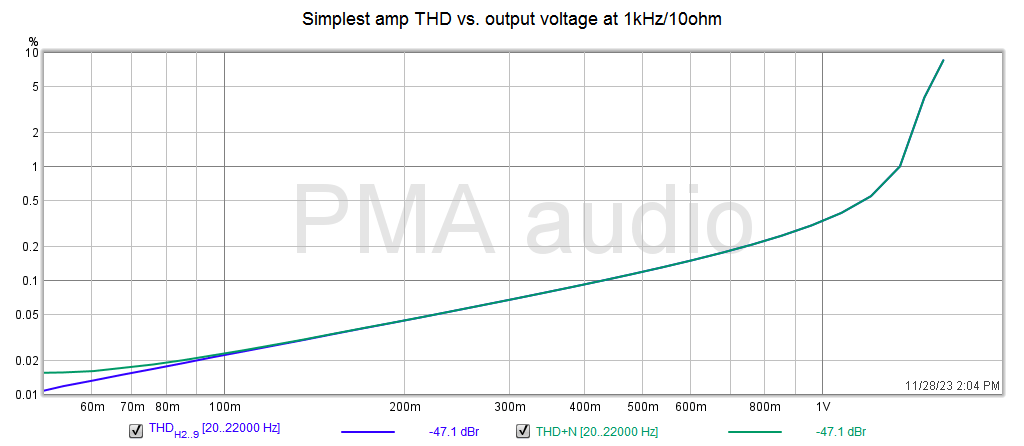

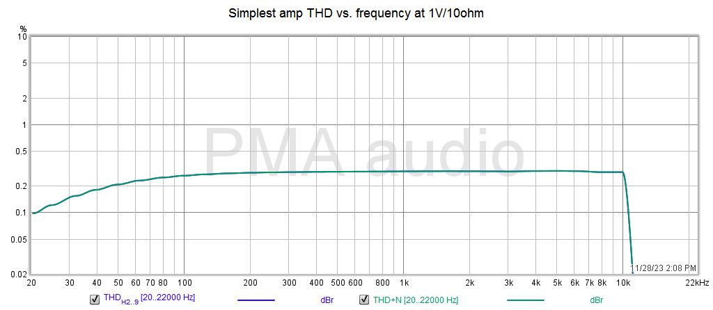

Good point, but, these are the real life results: idle current starts at 295 mA for the “cold” device (room temperature 22C) and rises to 312 mA after the heatsink temperature has stabilized at 43C. This is, to me, unimportant. Using a divider instead of a single Rb resistor would lead to inevitable decrease of input impedance, which is quite low even now. We need base current of some 3mA to keep emitter current at 300mA. Emitter current cannot be further decreased, the usable output voltage/ power would be TOO low. Base divider would eat a part of base current, or, if made with smaller resistor values, it would decrease input impedance. This would be too high price for marginal improvement of idle current stability, which is not very important in a class A buffer.

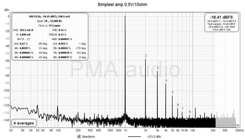

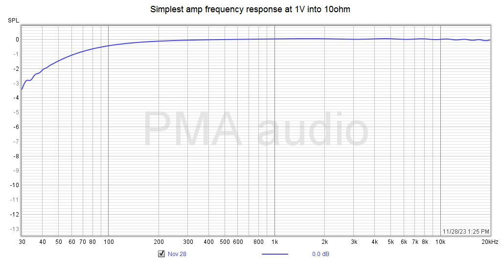

The input impedance here, depending on load, is plotted below. This is with a single 2k2 base resistor. This is just at the limit to be driven from 50 ohm generator impedance. So maybe it is not only an obsession. If the base bias divider was used, with resistor values that would bring some useful temperature stability improvement, the input impedance would fall to a half of the current one. You were right in your post #1 in general, however, we always need to take the real circuit values into account.

Input impedance affects low frequency cutoff of capacitor coupled cutoff stages. Reducing input impedance from 10K to 1K would raise the frequency ten times; in other words if the low frequency cutoff was 10 Hz into 10K then it would be 100 Hz into 1K.

Yes, but I was talking about simplest possible 1-transistor power buffer, that would be able to feed the speaker. Such task needs low output impedance and reasonably low distortion. The new thread is here:

Regarding Rod Elliott pages, I published Project 83 (Mosfet power follower) there in 2001. It was designed for huge heatsink. It has had much higher input impedance than the BJT power follower, but it was more complex (CCS). The goal now has been Simplest Possible, but with acceptable parameters. This resulted in 2 resistors, 2 capacitors and 1 transistor as necessary components.
