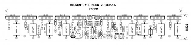

someone know this schematic ?: MC 741E driver for 1000W detex amp

here is it
No, it's not.
That's not a schematic but the silkscreen layer from a PCB.
Of course, if you have an actual schematic, please feel free to share it 🙄

I just try to find out exactly schematic 741E, because it is just diffirent with simple schematic 741A(01 pair 2sc5200&SA1943). it is show have 4 x4148 to bias point.
offcouse i know they dont want ..for sale it.
just only i dont want lose to much time to test ...

I see two issues with this circuit right up front. One, if you disconnect the input when it's on and hooked up to a speaker, the positive input of the op amp has no path to ground, so the op amp output could oscillate or fly to one of the rails and stay there. Two, correct me if I'm wrong but by tying the feedback 100uF cap and associated resistor (820R?) to the negative supply instead of ground, I would think you'd get a rather severe positive going pulse at the output at the moment the amp is powered up, while the 100uF cap charges up. Either of these issues could be very hard on the speaker.
If you were to go with a 5534 in place of the 741, you need to know that 5534's aren't unity gain stable (5532's are). I think I heard that they need a gain of at least 3-4 to be stable (free of continuous or sporadic oscillations above the audio frequency range - physical layout will affect this significantly - also power supply bypass caps near the opamp). Tl071 should be a good replacement though. A kid playing guitar wouldn't notice a difference, but an adult using it for Hi-Fi may well. Hope this helps.
