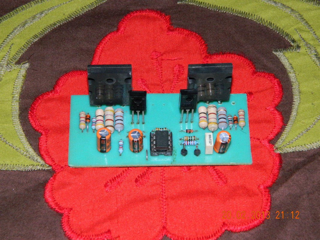

if its the original 741 op amp, this is not suitable for audio, there are much better ones, for little money. Makes one wonder how any designer could use a 741 for audio these days.

I think you must have made something else, because this amp, as is, is terrible.
It has +/-35V rails but the Op Amp can not swing more than 12V peak each way.
You are wasting 20V each side.
It's also overbiased and not compensated, so it will self destroy thermally.
Plus other small details.

The nice sound may come from the complete amp or topology, not from the opamp used. CFP amps tend to sound nice, and they are not so stable. You cannot drive an existing CFP with the fastest opamp hoping to get improvement.
Indeed, there is a classic CFP design using a very slow uA741, and it sounds nice. Well, why not show me your favorite simple CFP driven by 5534 or better opamp?

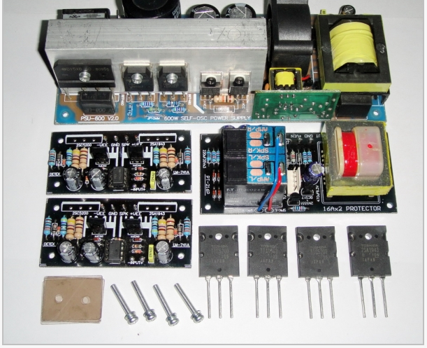

Well, YOU say so.Detex Audio 741 ic based low component count NICE SOUND
warm regards
andrew lebon
No schematic, just a picture.
No specs, no PCB, ZERO info.
Do we have to take your WORD for it? Why?
Agree. No way to confirm what Andrew Lebon says.if its the original 741 op amp, this is not suitable for audio, there are much better ones, for little money. Makes one wonder how any designer could use a 741 for audio these days.
Can't see how its a nice sound, have you listened to it?
Yes, pictures don't lie.pictures dont LIE hottest selling kit now
You are showing another kit, not the one we are talking about.
So, who's lying?
So we are talking about a "simple" amplifier with 2 ( two) output transistors, and you show a 24 output transistor, fan cooled example? 😱Trying to finish 2sc5200 version with enitter resistors

That's exactly the design concept error I pointed at in the schematic shown in post #5 .
The output can't swing more than what the Op Amp can (in fact, even a couple volts less each way) and the Op Amp itself is limited to around +/-15V .
So no use for a +/-35V supply.
Actualy the output can swing the full voltage provided the output stage
is a CFP with a gain of about 2 to 3 , i ll propose the option in the 5534
based amp , although i m not a fan of these kind of topology but i got it
to work in the simulator at the expense of a little more THD given the output
stage is less linear if it has voltage gain.

Oh my. Can't you read the schematic from the PCB picture in the first post??
Anyone familiar with amplifiers topology will be able to read quickly because in amplifier topology there is nothing new (under the sun).
