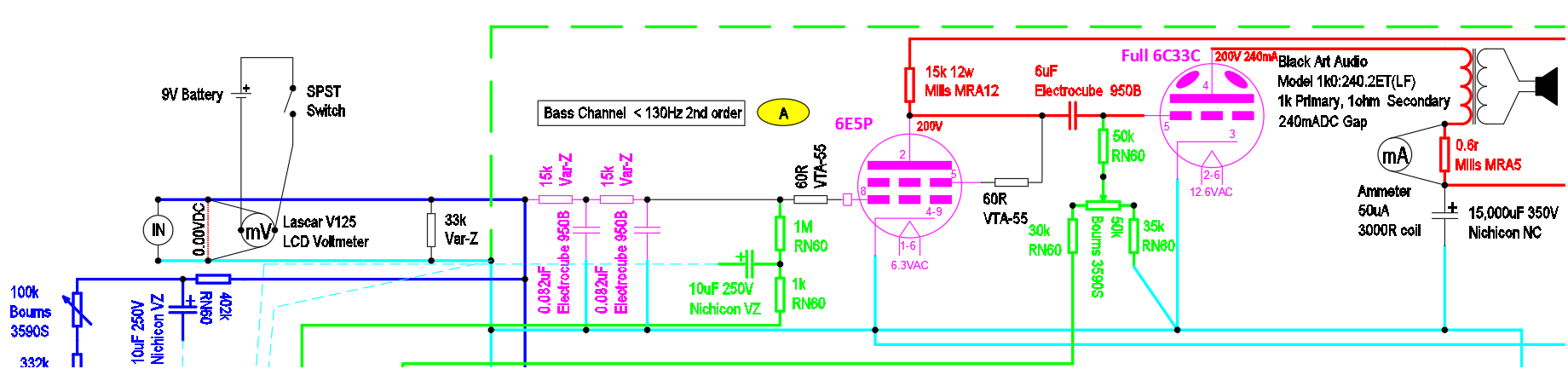

Today, this has happened again (with probably another 6,000hours on the amps in the meantime) about six hours into the days playlist and I believe it is more than bad luck with a tube failiure, it is now a design flaw. But I am having trouble trying to figure out why this is occuring.
Filaments are floating although the transformers are centre tapped so could be elevated if necessary. The 6c33c plates are 200V/240mA and 190V/150mA depending on whether the tube has one or two triodes heated. Cathodes are directly grounded (no caps or resistors to ground) and the amp uses a 150V bipolar supply to generate an adjustable grid bias (and eliminate the input capacitor). See attached snippet of schematic. In the schematic Dark Blue is signal positive (+150V from bias supply), Light Blue is Signal Ground, Dashed Light Blue is connected to 0V in the bipolar bias supply, Signal Ground, Green is -150V bias, Dashed Green is connection to chassis ground, Red is B+. The 6e5p's have a heater supply separate to the 6c33c.
This is not quite your normal SET amp arrangement but the sound is glorious, so when repaired I would like it to not fail this way again so am calling for help. Any ideas for why this amp melts heater wires from time to time?
Measured during build and testing with a few tube compliments at 6.6A, right on spec. The transformers are custom wound, low heat gain EI core that normally run quite cool... only 10 degrees celsius or so above ambient.

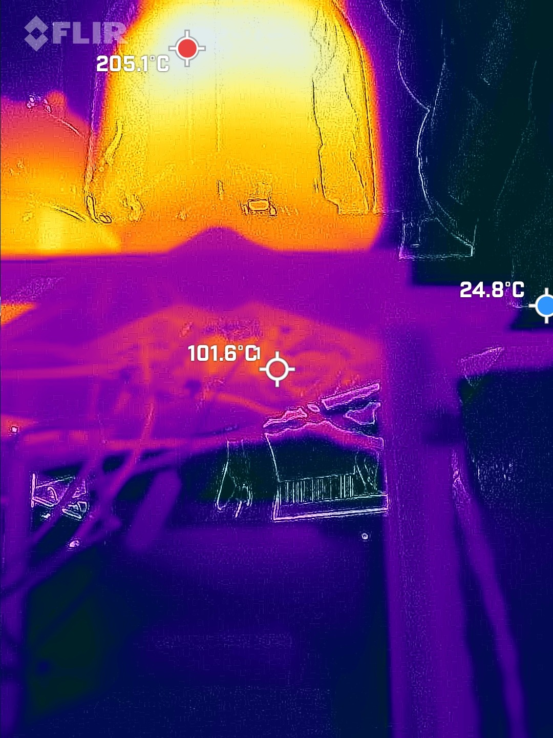

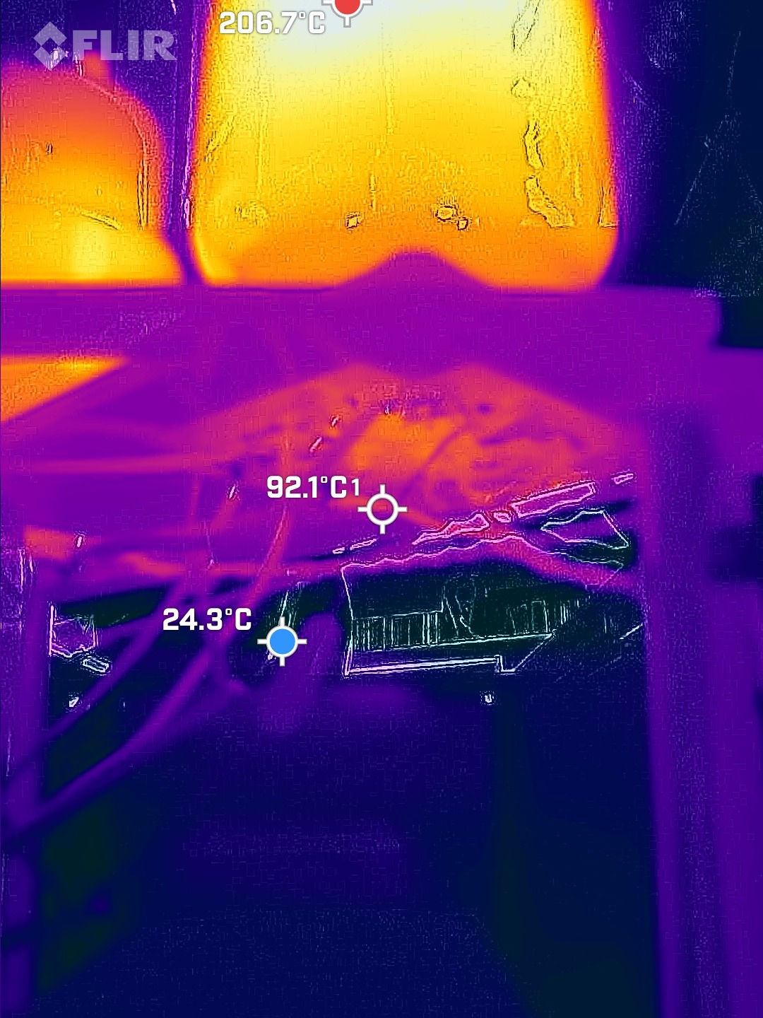

The heater wiring is 18AWG solid core copper wrapped in mPPE insulation. I went for that insulation as it is very thin and the resulting twist ends up with the two conductors very close together providing some cancellation of AC fields. The wire is rated to 105 degrees celsius. So I pulled out the FLIR thermal camera to take some readings on the other amplifier that has never failed and the bottom of the 6c33c with both filament/triodes connected has these readings:
...that is pushing the limits circa 100C on insulation rated 105C. I think that these two failures have been caused by some condition that pushed the temperature enough that the insulation failed close to the valve socket. Would not have to be much according to the specs. The plan is to use larger diameter wire with PTFE insulation within the amplifier. In addition I'll add a thermostat on one wire that when it trips turns off the entire amplifier (easy to do assuming I can get the thermostat to trip at an appropriate wire temperature).
