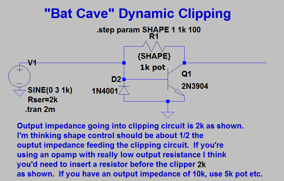

Hi all, thought I'd share this circuit
and get any feedback you want to offer.
In electra type distortions, there
are 2 diodes going to ground at the output to clip
the signal. I got the idea to use a transistor
to clip the signal, but let the signal also perturb
the transistor through the base and when the signal
is high to allow the top of the wave to depress
and go towards ground from collector to emitter.
In other words the signal itself changes the clip.
There is a shape control resistor when raised,
causes the voltage at the base to increase and the
top of the signal caves downward.
I haven't seen this done before so I thought I'd
share it.

Why not build it and see how it sounds? Usually extremely "pointy" waveforms like that sound extremely harsh and unpleasant.
By the way, 1N4001 diodes are quite slow, and not well suited to rectifying audio signals. A 1N4148 will do a much more accurate job; whether that means it will sound better, worse, or the same, I cannot say.
-Gnobuddy

Yes that pointiness I think may sound thin. Because in part of the audio has the frequency doubled too. But that's where the shape control comes in I suppose I was thinking you could vary by ear as a distortion shape control. I need to give it a whirl and get back to you after I do. I was travelling and just got back so I'll have to build something and let you know. Thanks for looking!

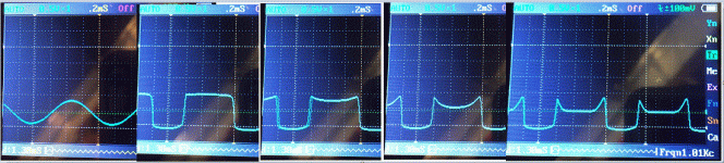

I tried my pocket oscilloscope out for the first time and tried a circuit. I hooked up this at the output of a little class A amp that had a midrange band pass filter on it. The most I can say at this time is it works. It basically sounded like a high midrange hard rock or metal type distortion that thinned out with the control. It had too much midrange, but some of that was coming from the bandpass I think.

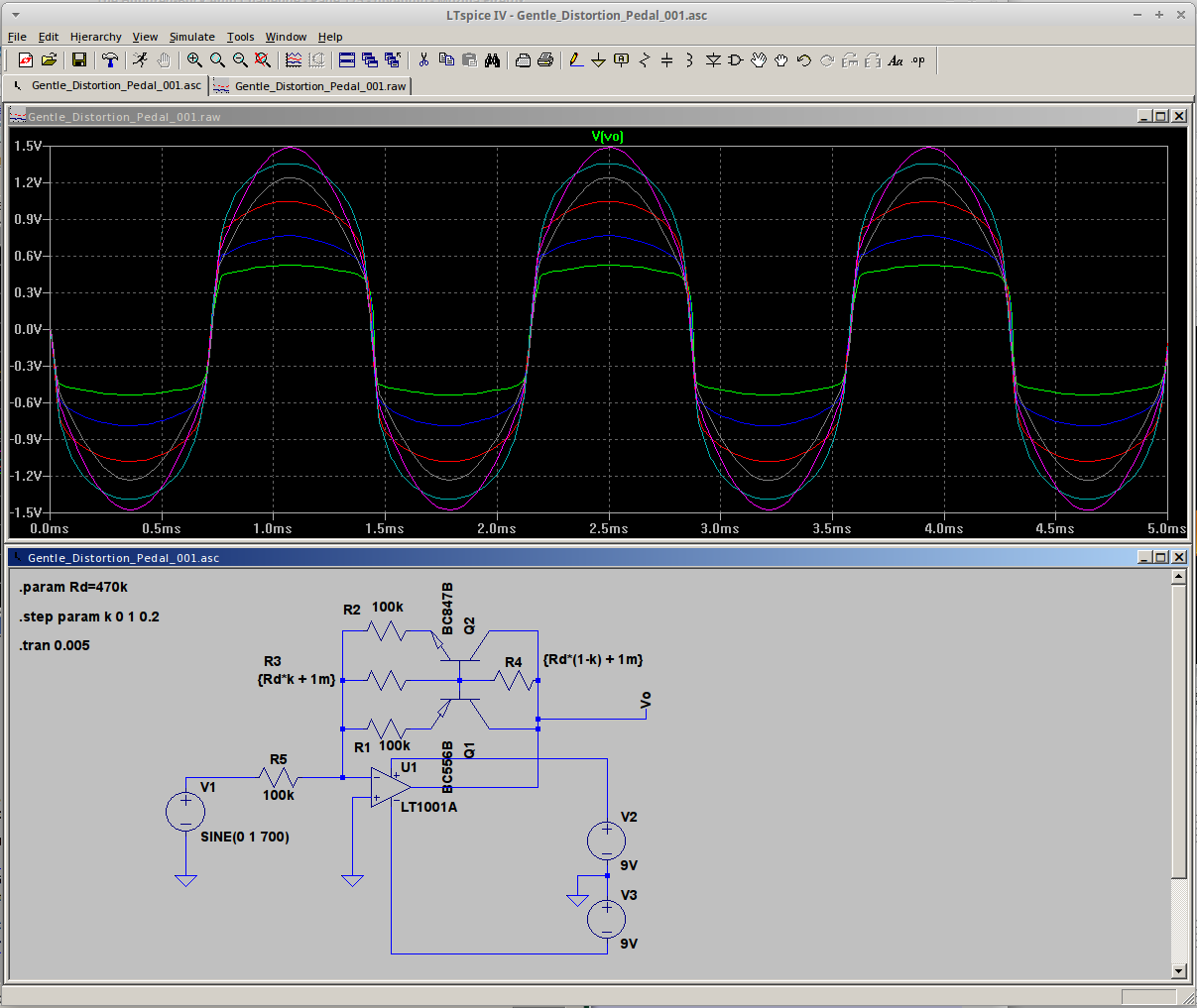

What fun! It's always nice when something you imagined actually works, and that too, works just the way LTSpice predicted it would work.It basically sounded like a high midrange hard rock or metal type distortion that thinned out with the control.
The 4148s will be faster and more accurate, but who knows, that may actually sound harsher. The slower 4001 may be adding a little lowpass filtering to the sound, and smoothing it out a bit.Want to try the 4148 also instead of the 4001 also.
Once again, I think a quick trial on a breadboard is the way to go. A few minutes listening will tell you all you need to know!
This is the sort of analog circuit I still enjoy - creative, non-textbook stuff that uses the non-linear, imperfect nature of the devices themselves, and turns that into something you can make music with. Very cool!

I drew up your circuit in LTSpice (using similar components and a dual rail supply) and did a little virtual experimenting. LTSpice thinks that using a 470k pot instead of a 2.2M one will make the distortion control's action smoother (more uniform over the pot's travel). The attached image assumes 1 volt (peak) input signal at 700 Hz.

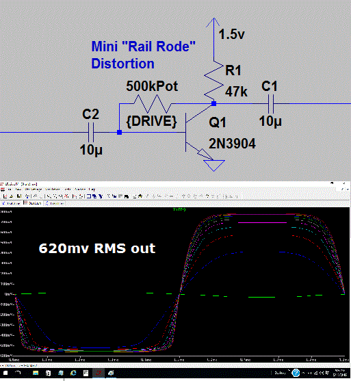

NOT the best distortion, but perhaps the simplest.
I'm just fooling around trying to find the simplest possible distortion circuit, and I came up with this. Thought I'd post it and move on to another project. (Of course there is the "Black Ice" type distortion which is passive distortion with Schottky diodes, but it simply doesn't work if your pickups aren't hot enough).
This circuit sets the transistor next to the bottom rail and it clips at around .7v and the other rail is set by the power supply, which is only 1.5 volts (Must use 1.5v battery or supply).

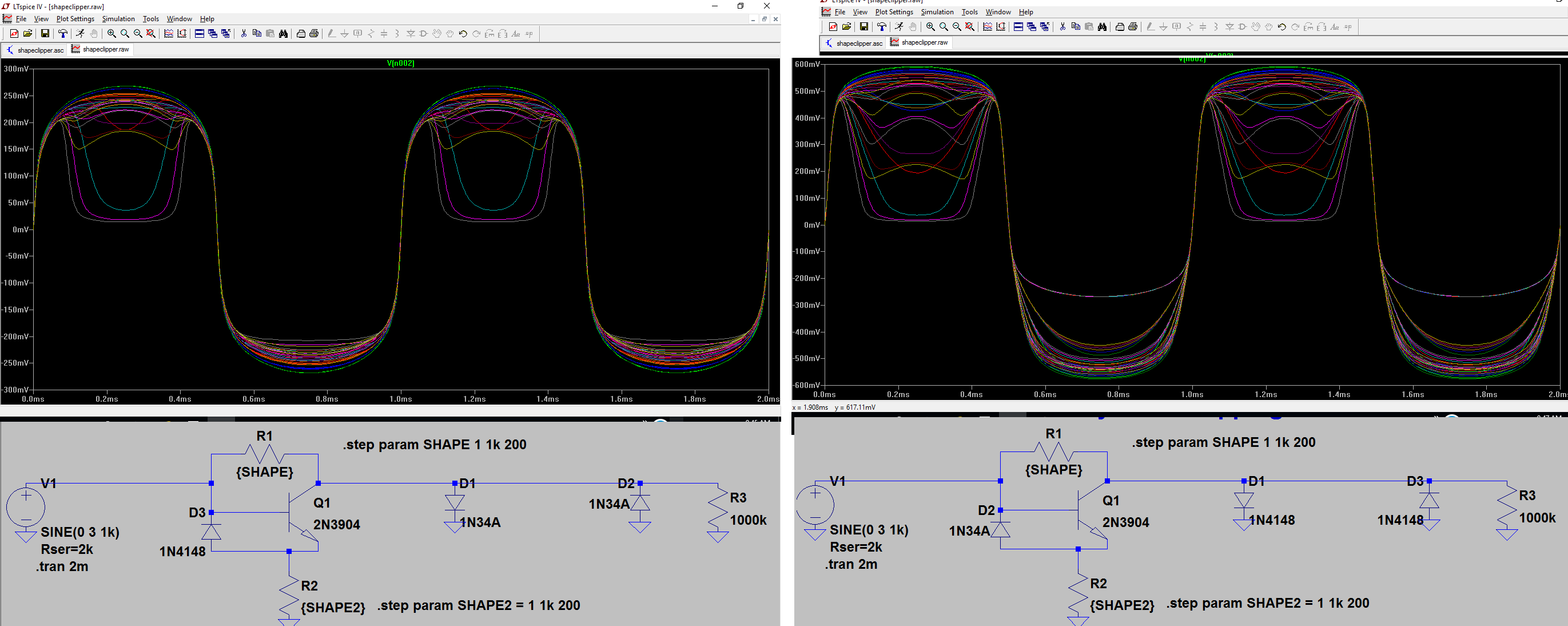

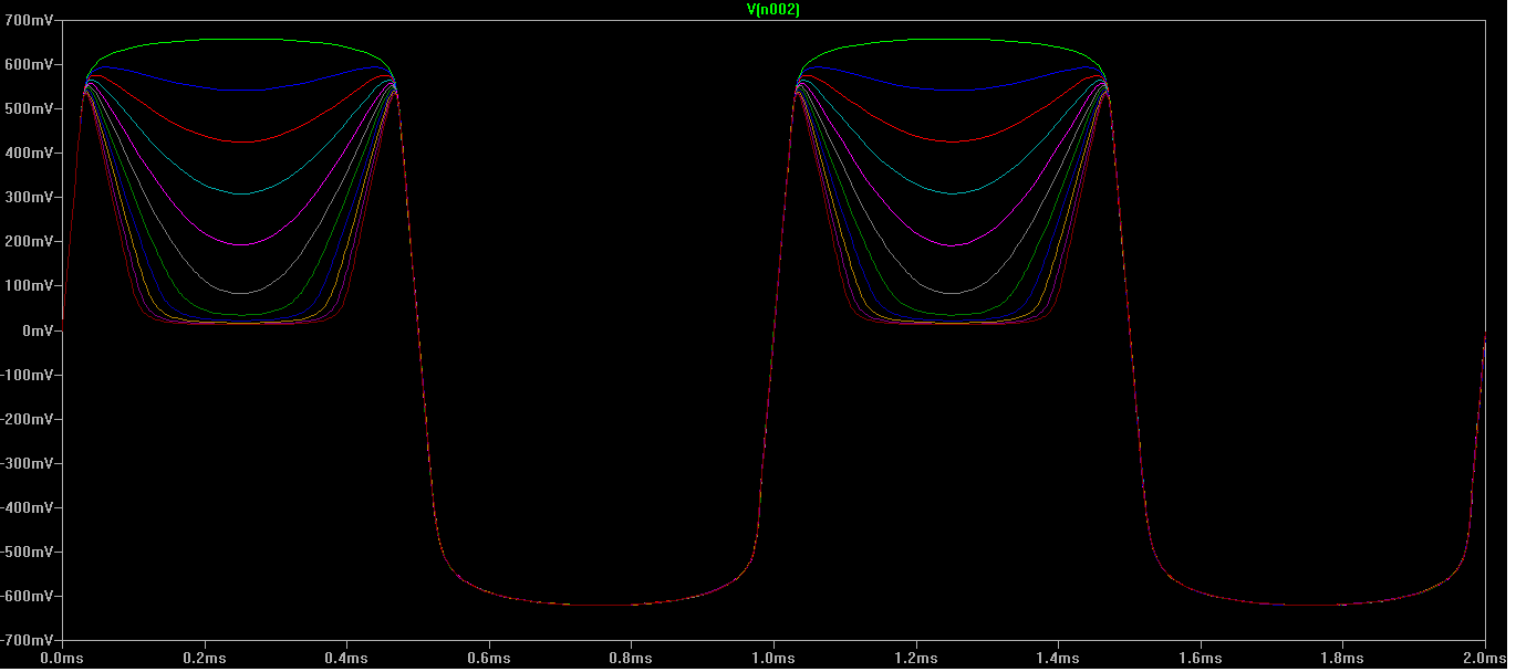

"Softer" Version with second "shape" control.
I got a softer looking form with raising the clipping threshold with a 1k pot, but of course it gets louder, so I put another clipping pair afterwards. I used a 4148 and 2 1n34 to limit clip and then vice versa. Looks like it would help it not sound so harsh, but will just build and listen🙂

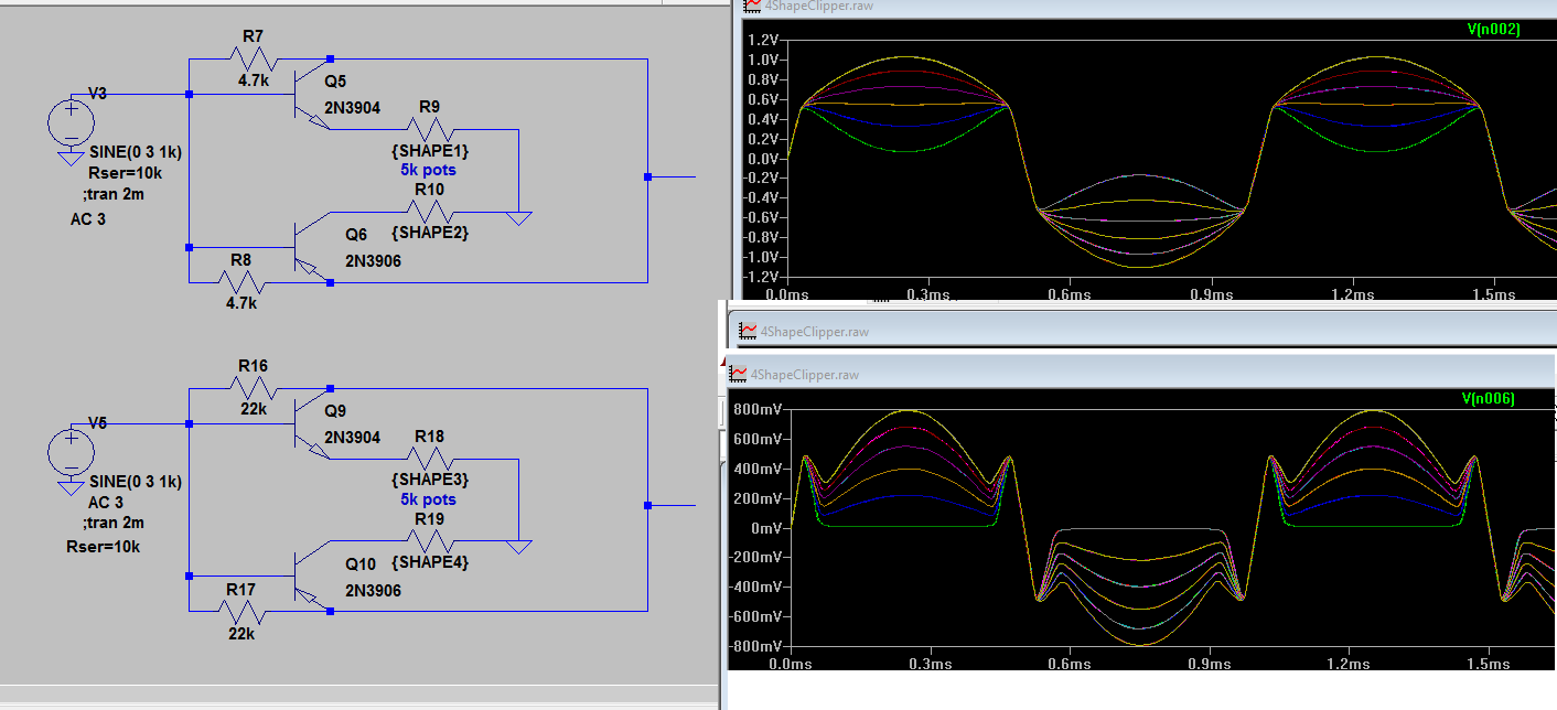

Another variation with a 2n3904 and 2n3906
Hi, I looked at Nigel's circuit and sort of played around without, looking for something to put after amplification, not in the feedback loop. This is what I came up with. 1st shape control is whether or not top of wave is concave or convex, 2nd control controls the bottom part of wave. I think you could also put 2 more pots to get a crown like shape, not sure what that would sound like. But I cannot model more than 3 parameters at a time in ltspice, so 4 shape controls are hard to model.

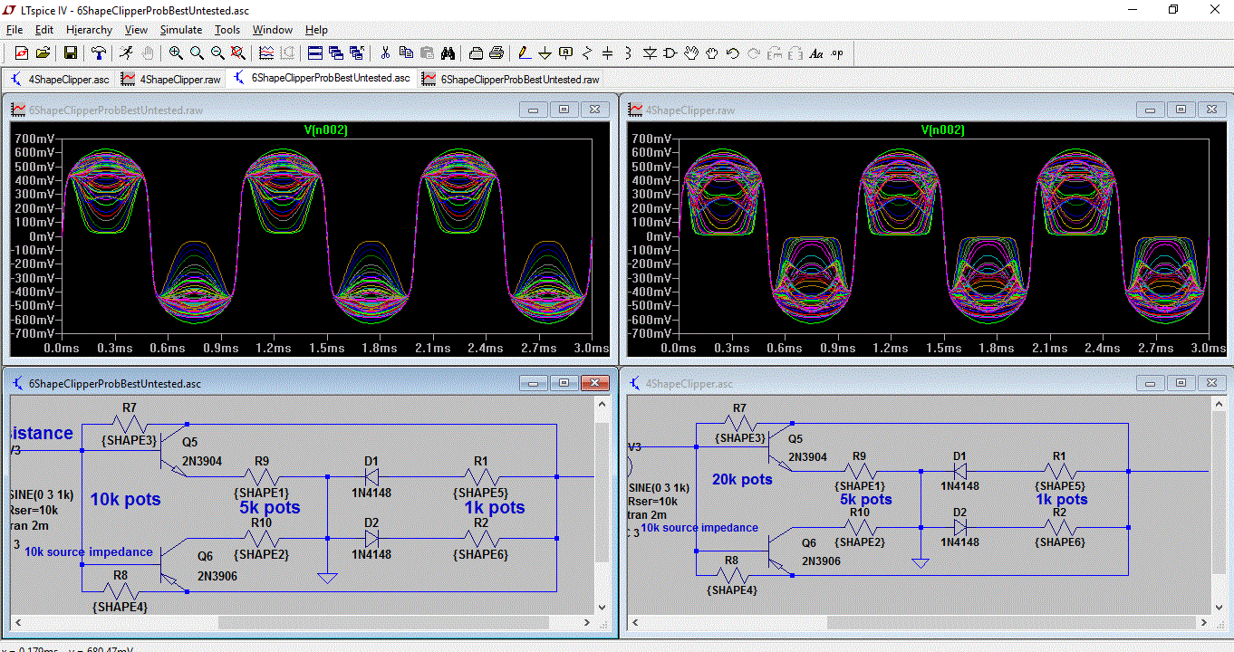

Going to build this and give it a try, 6 shape controls
I'm going to hook my oscilloscope up and watch the waveforms and listen as I tweak these 6 controls. I doubt I would need all 6 controls and some will likely get combined, but I'm going to try and figure out which forms if any sound pleasing/ok and then simplify this circuit a little. It'll probably just be the soft clipped ones, but maybe one of these asymmetric forms may sound good. Anyhow thought I'd share this one I came up.
