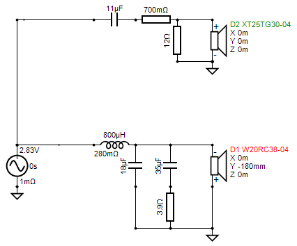

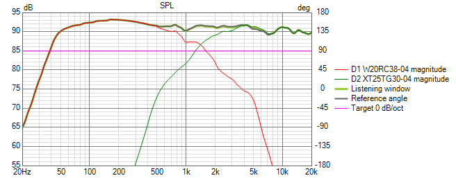

W wlg Member Joined 2017 2023-08-31 12:35 am #21 2023-08-31 12:35 am #21 Second attempt at a crossover. I wanted to reduce the cost therefor reduce the amount of components. I'm wondering if the x-over point is now too low for the XT25?
