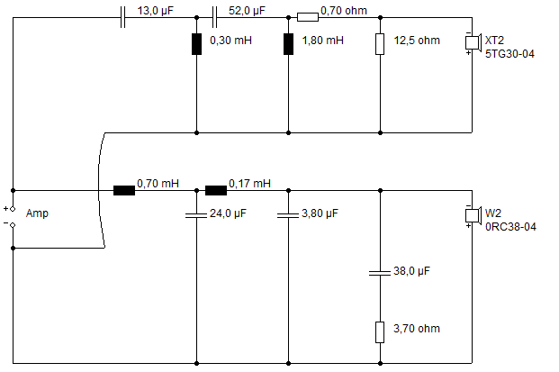

I am working on my own crossover based on the DM945, i.e. a single cap on the tweeter. It's difficult for me as I don't have any measurements of the silver flute. For the tweeter I am utilising Heismann's waveguide test results.

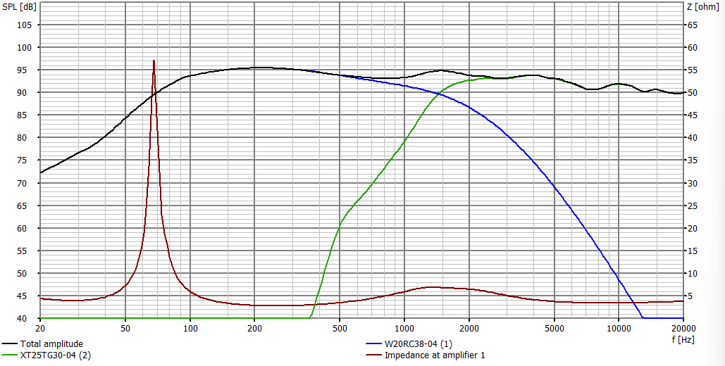

Ok, here's my first attempt at a 2-way crossover of said SF and XT25 with WG-300. Simulated 16 liter enclosure tuned to 30 Hz. LR4 x-over at 1800Hz.

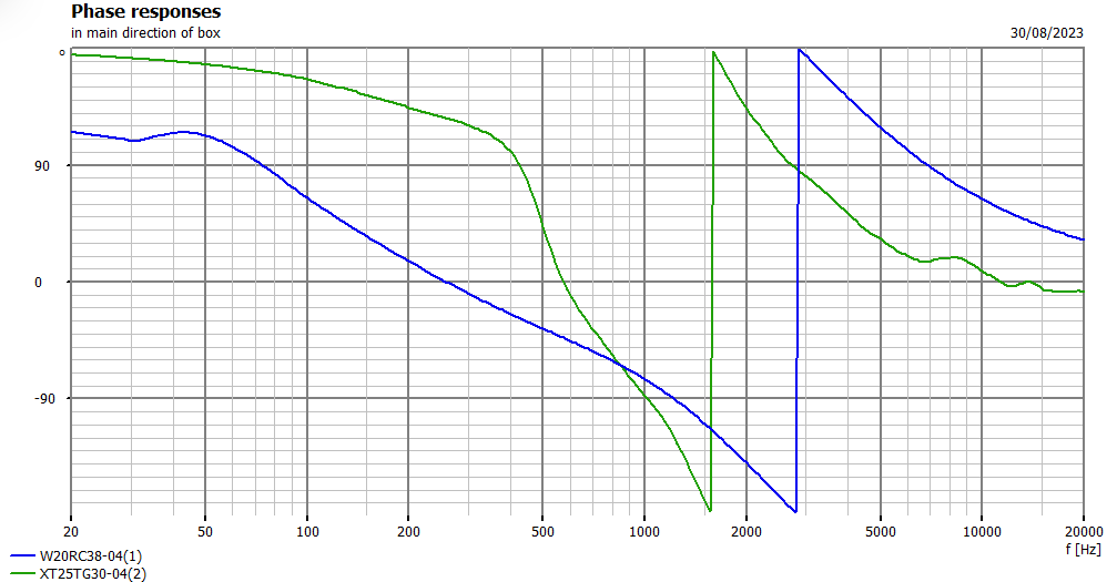

Phase is out by ~1500Hz, not sure how to fix that?
Am I on the right track?
