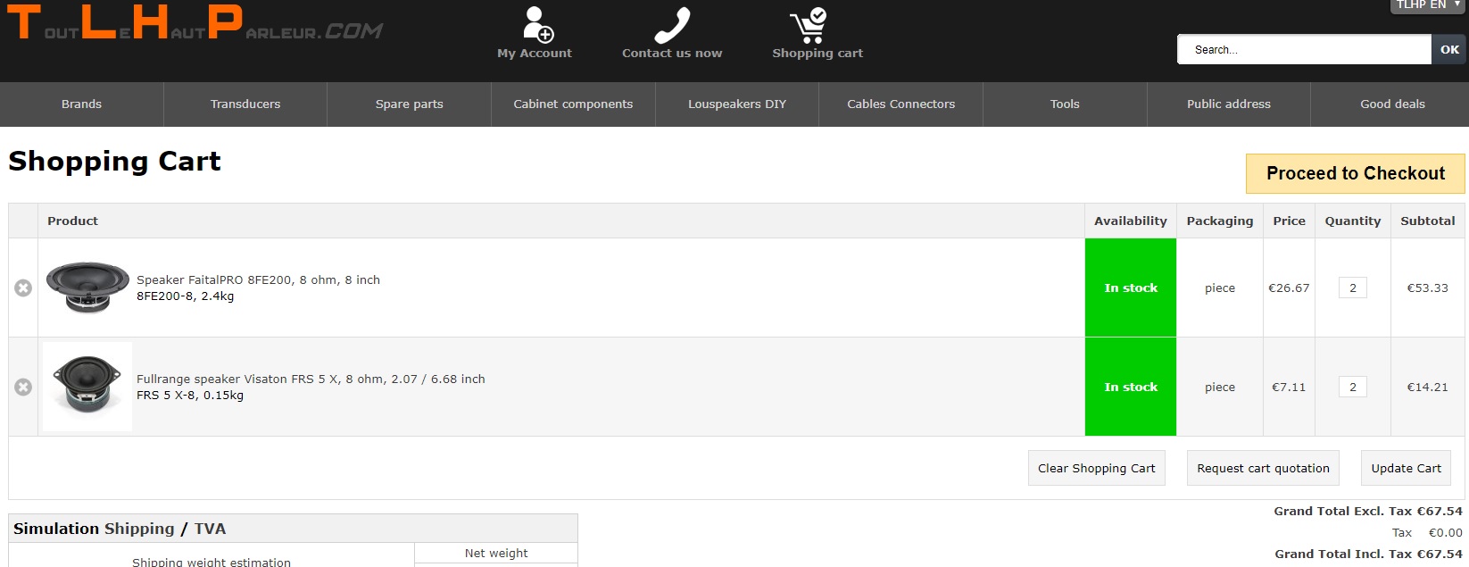

I have never thought of this before, but almost seriously starting to consider Faital 8FE200 together with Visaton FRS 5 X.
This is very difficult!

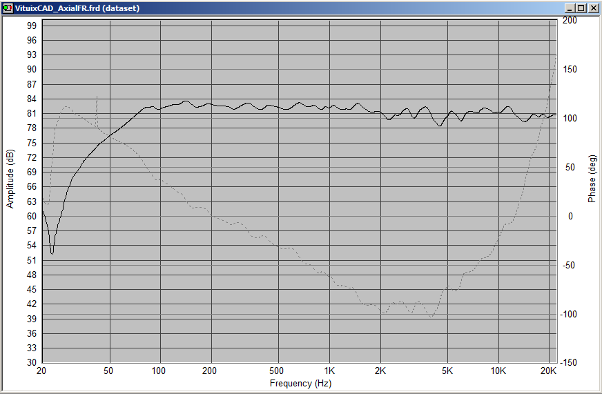

Thought I'd post what I've done so far. Not giving away the exact drivers, but it is a peerless and a visaton. As I said my entry will be a non-qualifying simulation only. Total driver cost is a tad under $22 US leaving me with $8 for crossover components, which I haven't checked on the cost yet but should hopefully be doable.
I think off axis would probably be a bit ordinary, and power handling pretty low, but within the constraints I think coming along ok. Note That this sim fully accounts for the baffle as well.

Different schools of thought around this. One is to have flat on axis (anechoically) and use EQ to make a room curve for the specific room.
Another is to bake it into the crossover, though that is more appropriate for a particular room and may be too much or too little depending on the room the speaker is used in.
I put a slight down slope in the one I posted above, but I have in the past gone for flat on axis. The other thing that can happen (which would be exacerbated by down slope from 20 hz to 20Khz) is that due to room modes and speaker placement related room gain, you may end up with too much bass.
