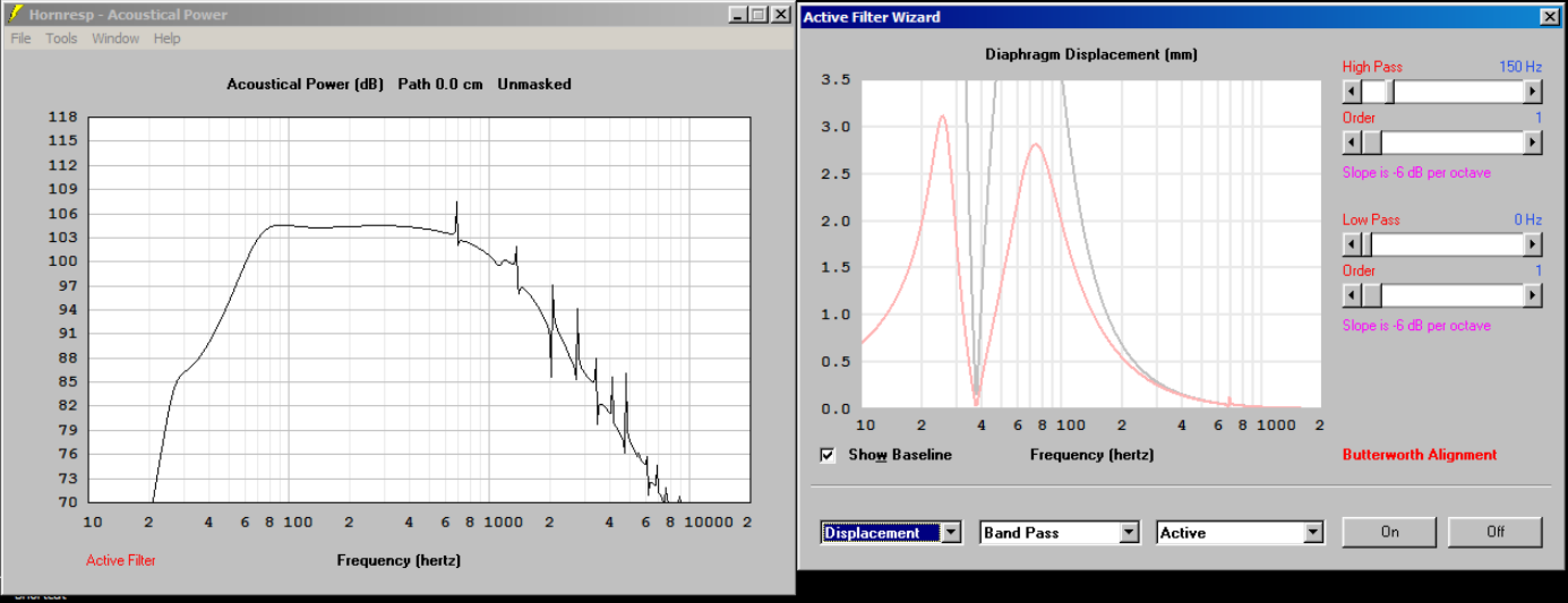

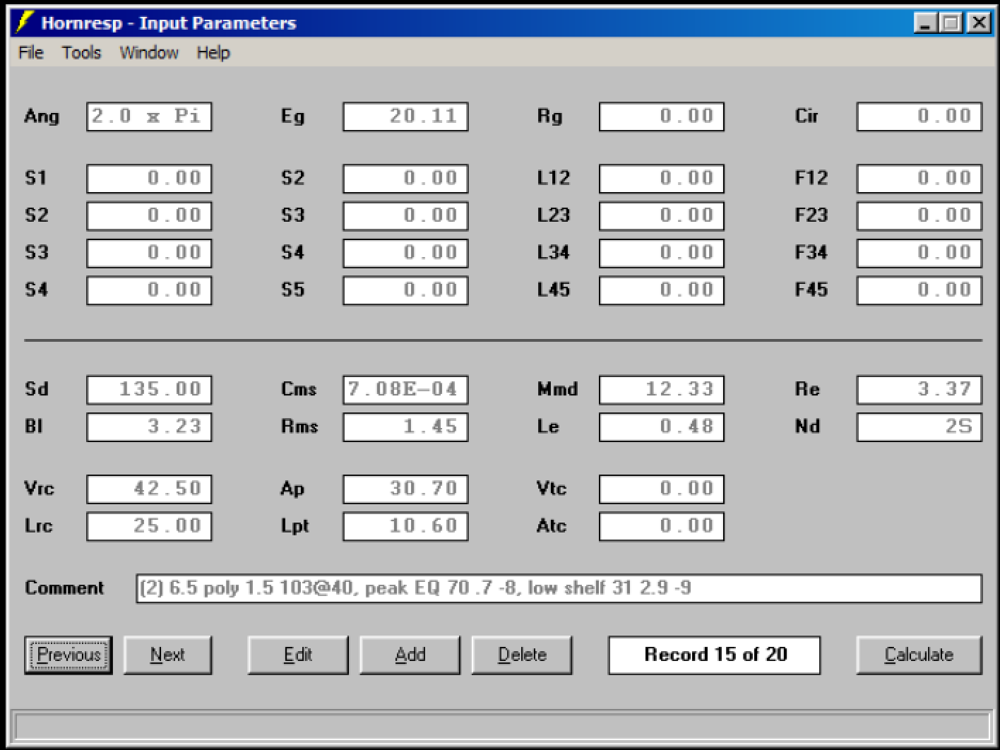

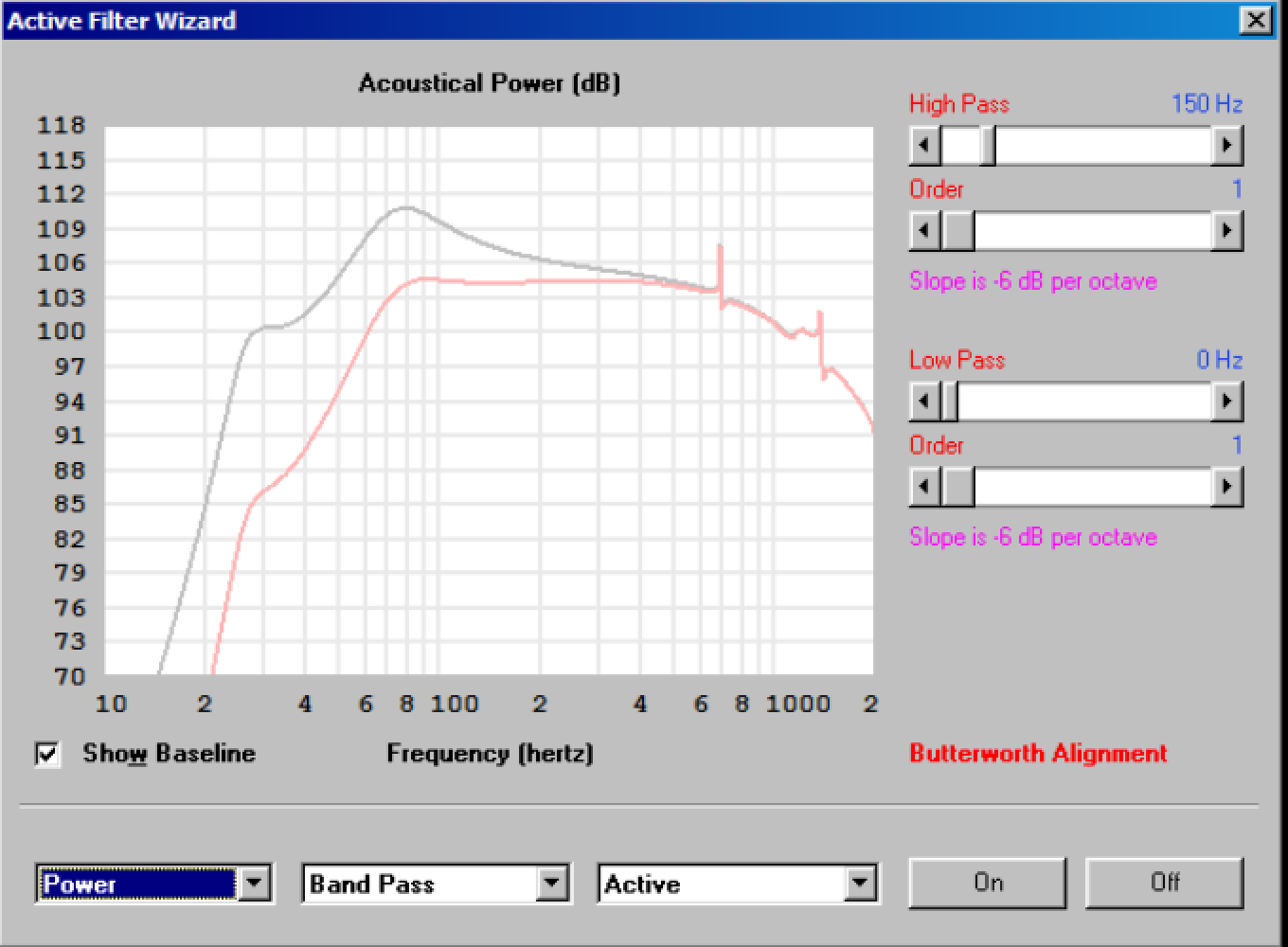

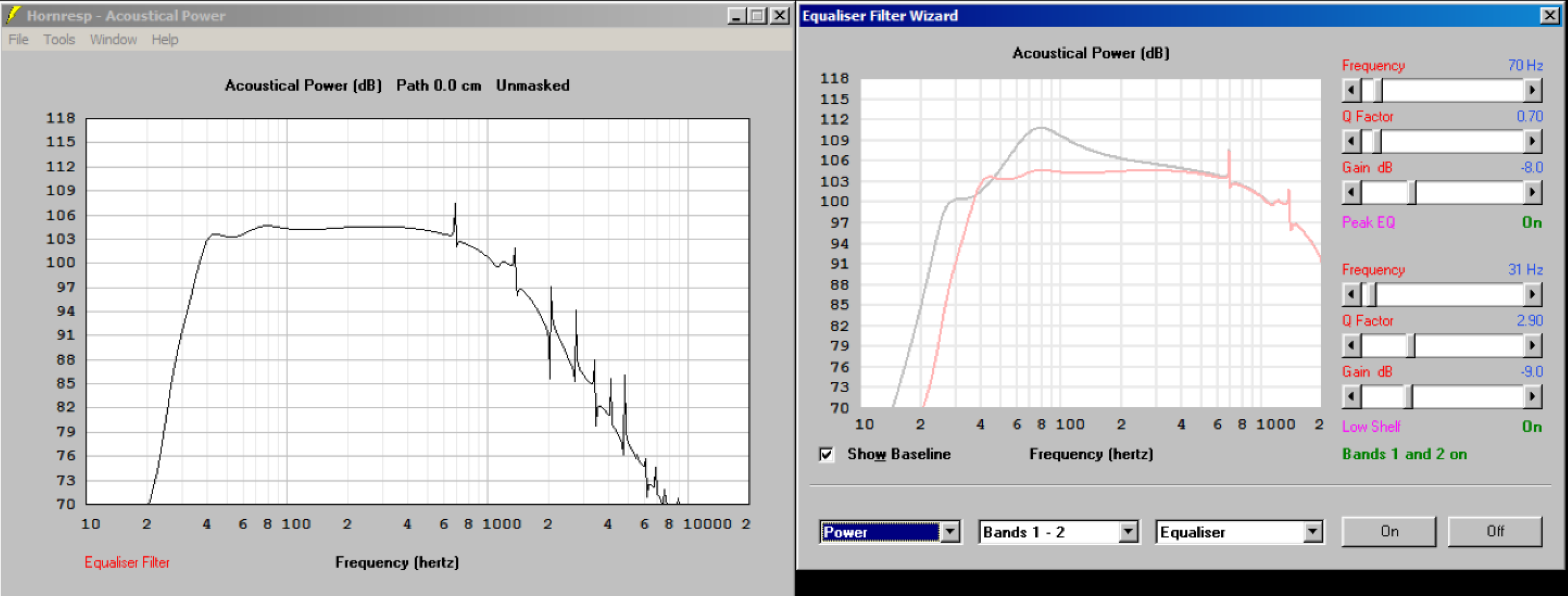

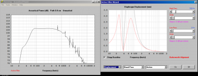

So where are we going to put submissions, in this thread? Just to get some creative juices flowing, I have some sims for the two variants I am toying with. I would expect each of our projects will be plenty of posting back an forth, so this thread will get noisy fast!
***************** Initial Idea***********************
For the initial $20 budget I was thinking like this:
(2) $5.88 buyout 6.5 (is it a buyout if they have been selling for many years?)
(1) $2.90 GRS tweeter
misc crossover components out of the remaining money. Since the target is now $30, I would have 30 - 5.88 - 5.88 -2.90 = $15.34 left to do a passive crossover. In order to tame these drivers in a box size that is reasonable for my home, I came up with a first order high pass at 150hz which really kills the low bass, but does cheaply handle the ugly hump. This high pass also controls the excursion to the 3.5mm limit for these drivers. I modeled at 30watts, which is about what I would have available for them from the inflated 50x2 rating on a TPA3116d2 clone.
*******$30 per speaker active idea
I realized that by being very careful with my budget, I could actually attempt to do some DSP for this system. Adding to the (3) drives above,
I bought this:
ADAU1701 Audio Control DSP board Digital Signal Processor Adjust Gain Bass | eBay
and bought even more of these since they rock:
TPA3116D2 50W*2 Digital Power Amplifier Audio AMP Board Module Dual Channel FA | eBay
and am now waiting for the slow boat, hoping it gets here early enough to pivot from the passive crossover to a 2 channel input DSP, 4 channel output to (2) of the TPA3116d2 amps for a bi amp setup, using the DSP as an active crossover, and for any DSP features I can learn in sigmastudio. I have an old transformer from a UPS with dead batteries I dumpster dove for that can power the amps but I am not sure how to value that. In any event this is a stretch and maybe not even in the spirit of the competition as I have to split the cost of the DSP between two speakers.
(4) woofers @ $5.88
(2) tweeters @ $2.90
(2) amplifiers @$4.89
(1) dsp @$18.90
= $58.00 leaving $2 for a transformer I pulled from the trash?
ruling on 30 / speaker being the same as $60 for a pair ?
Anyways, I have attached the sims for both configurations for the woofer side of things using hornresp. I do not know of a mac program to try and merge tweeter and woofer responses, or to design a crossover at all yet other than the really simple online calculators, so that is as far as I am. I also have on hand a few sheets of plywood so if it is ever not 100degrees in the garage I can cut some wood and begin.
