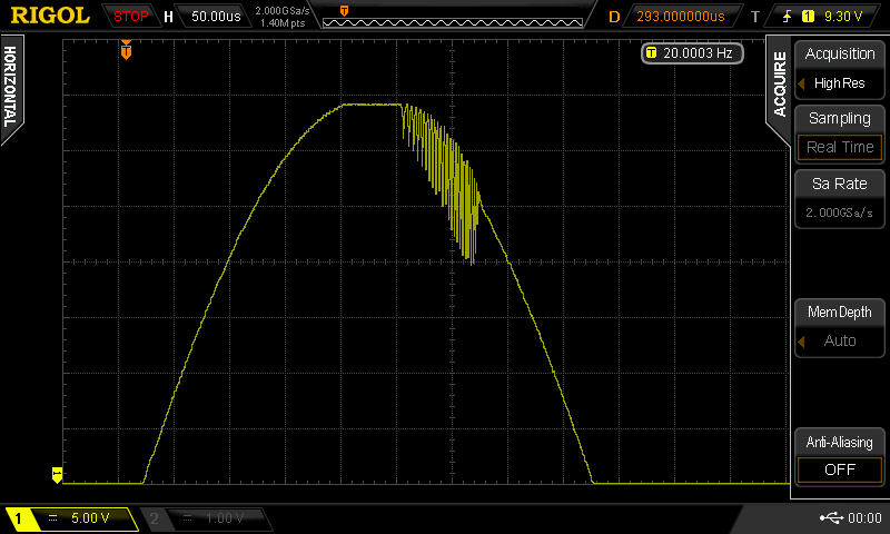

Was going to start a new thread but forgot I had l aready posted in this one. Anyhoo.. i was feeling a bit bored with being cooped up in the house so I attached a function generator to the amp and scope to the output, both of which I didn't have when I built the amp, and connected an 8 ohm resistive load. Drove it with a 1kHz single cycle tone burst every 50mS to check max output. managed 49 volts peak at the onset of clipping, but as it comes out of clipping, even if only clipping *very* slightly, there is a burst of oscillation. Screenshot is offset below bottom of screen. I'm a but surprised at this - I would have thought that this kind of thing would have long been sorted out before the design was published. so, what might be the cure for it? Amp details in link.

See here for some info that might help you Fast Voltage Amplifier Stages for Audio Power Amplifiers
The oscillatory behavior you see often happens in amplifiers when driven into clipping.
The amplifier schematic shows no clamping on either Q8 or Q9 or indeed across the current mirror collectors

The diodes are the cheap s d easy way to do it - Ostripper and dadod showed slightly more sophisticated techniques.
Another point is that in amplifiers that use heavy compensation (like the ULD amp at 100pF) and fast VAS stages, they are more likely to oscillate coming out of hard clipping than if they were more sympathetically compensated - just an observation from playing with this stuff.
Of course, using slow devices like MJE340/350 also leads to serious rail sticking (and distortion) and this type of parasitic oscillation.

Just to add that this diode should be with very low reverse polarized junction capacitance, to prevent to high increase of HF THD.
