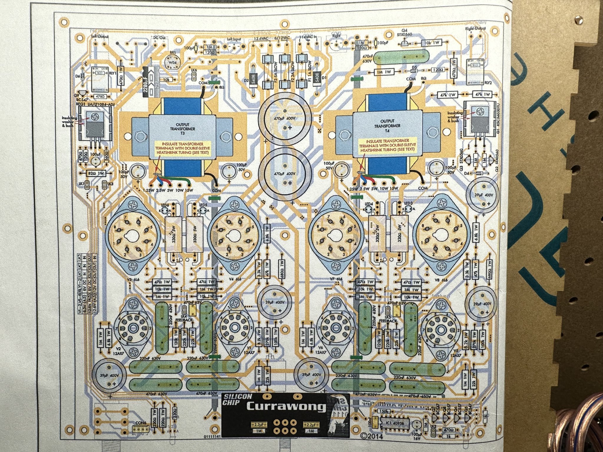

I recently built one of the currawong amps. It come up a treat and sounds quite good. For the price and ease of assembly it’s a good bit of fun.
But I have come across an issue with the biasing resistors? The 330ohm 5watt resistors get so hot they smoke 😂 the voltage going to these bad boy’s constantly rises to excess of 63v. The book says there should be 22v across them?
I’m struggling to find out what’s causing this, any ideas would be greatly appreciated!!
Cheers guys
Hard to know what the problem is if it sounds OK.
Do both channels have the same problem? If they do, it suggests a wiring error that is common to both channels.
Does the HT remain around 308V while the voltage across the bias resistors increases? Are the cathode bypass capacitors the right way round?
Check that the connections to the output transformer, both primary and secondary, are all correct. If the output is back to front the amp would become an oscillator but then it wouldn't sound good.
If the bias resistors are carrying 190mA the output valves won't be very happy either.

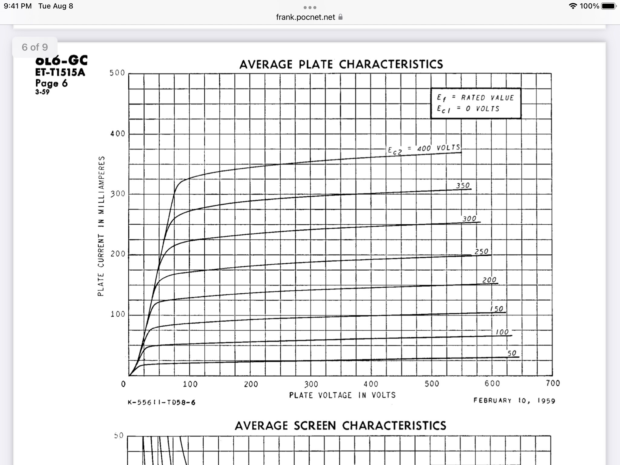

300 mA in EACH output tube? That’s about all you can get a 6L6 to pull without a driver transformer. It smells like g1 completely floating to me. Even with too high a g1 resistor it would stop short of 300mA if you’ve got cathode resistors.

300mA per output tube?
Fix the amplifier!
An AB1 amplifier with a 6000 Ohm p-p output transformer . . .
When one tube is cut off (AB1) then from center tap to one end of the primary is only 1500 Ohms.
300mA x 1500 Ohms = 450V (if the B+ was 450V, and IF the plate could go to Zero Volts, which it can not; so you will need a lot more than 450V B+).
Don't try to do this!
These are output vacuum tubes, not saturated NPN transistors with the Collector jumping through the Base, on its way to the Emitter (Base at 0.75V, Collector at 0.3V, and Emitter at Zero volts).

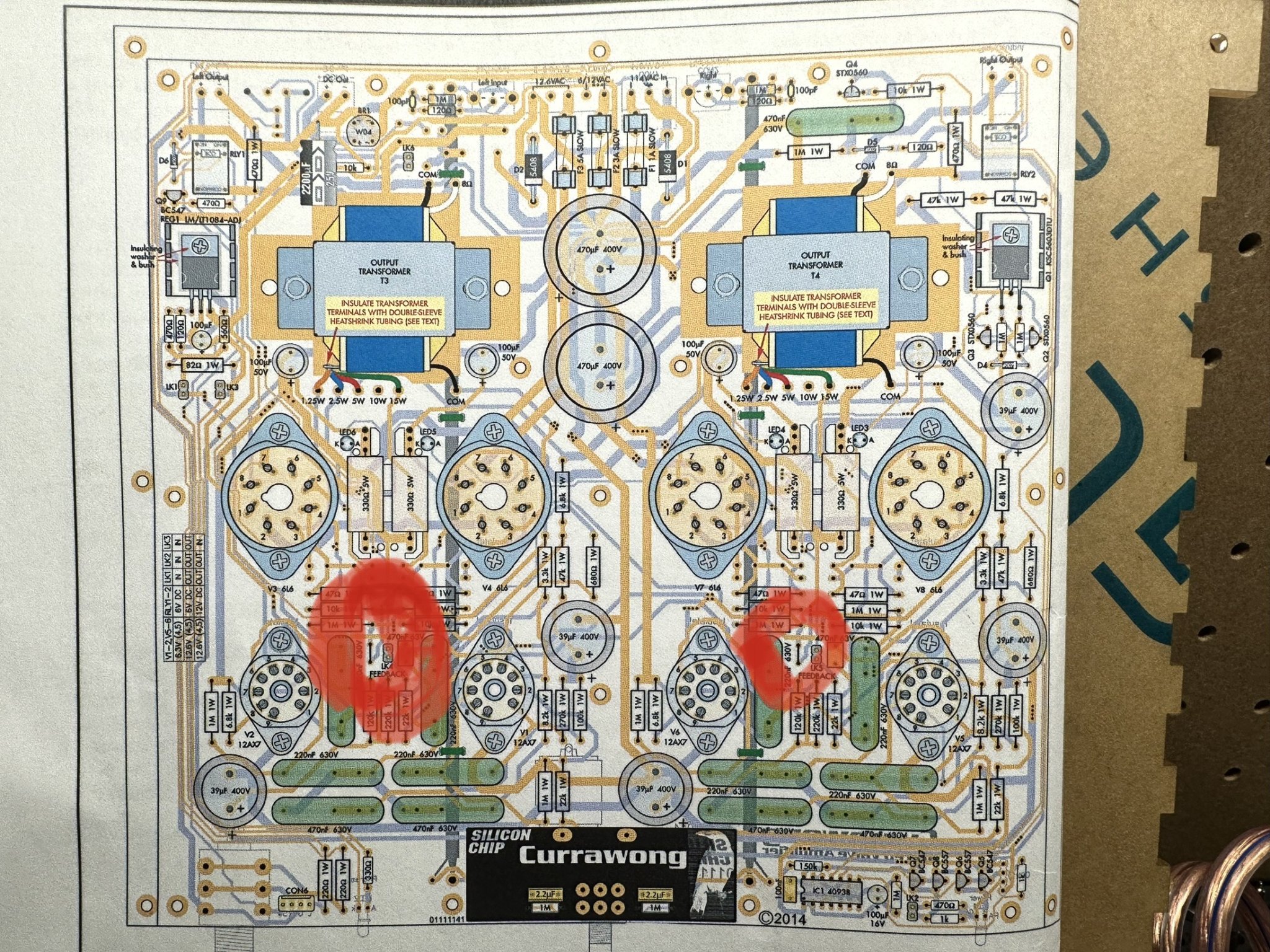

Looking at that PCB layout it sure looks like 330 ohm cathode resistors to me. And you’d pretty much have to lose g1 control altogether to get it to draw that kind of current.

Sorry, I’m still a bit of a novice 😂 What do you mean by G1 floating?
G1 should be connected to ground through a resistor. These are shown as 1 Meg in the layout but as 6A3Summer says in post #68, they should be no more than 500k. Try replacing them with 470k and make sure you measure 480k (470k + 10k grid stopper) between G1 (pin 5) and ground.
Reactions: Liamc
Never mind guys, found the issue…. Sometimes it pays to triple check your work 🤦
Forgot to add these links in, they were never mentioned in the drawings but when I was tracing it out I found them 😂
