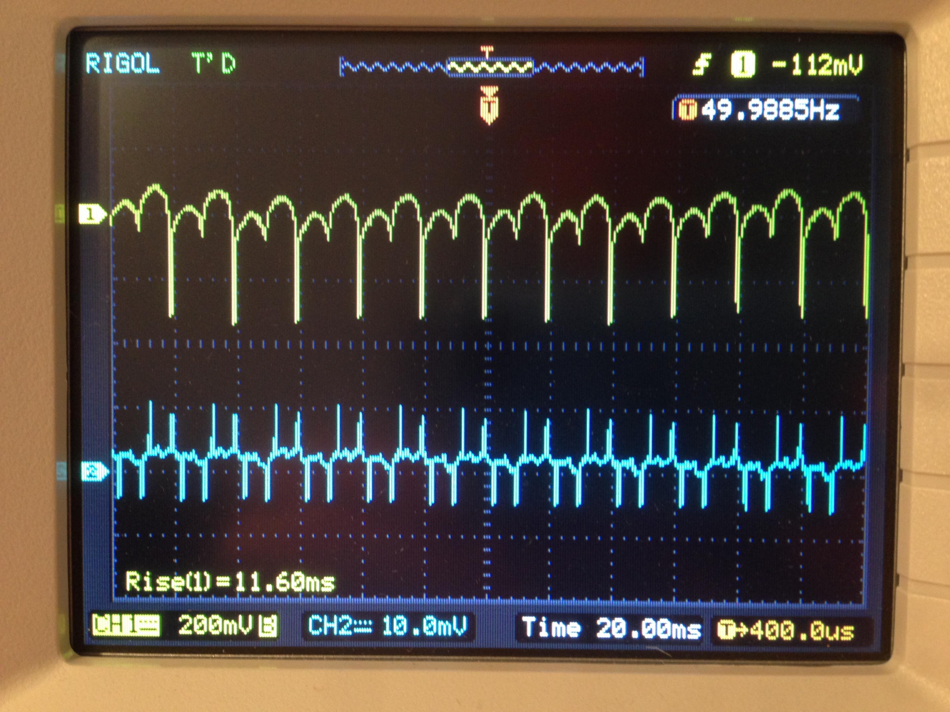

I have built one but can't give you a critical appraisal due to an unacceptable level of motor-boating noise from both channels.
The attached image shows +HT and one output.
The spikes in the output look to be +/-10mv. The ~200mV spikes in the HT could be a concern.
Still trying to track down the source.

Only partially. I found that if I ran the amp with the board out the front of the plinth there was no hum. As soon as I slid it back into its slot the hum returned.
Redressing all the wiring to make it exactly the same as in the picture made no difference.
So I put a thin sheet of earthed steel between the transformers and the board and that improved things somewhat in one channel but made little difference to the other. Eventually I'll try enclosing the transformers but the amp is an expensive ornament at the moment.

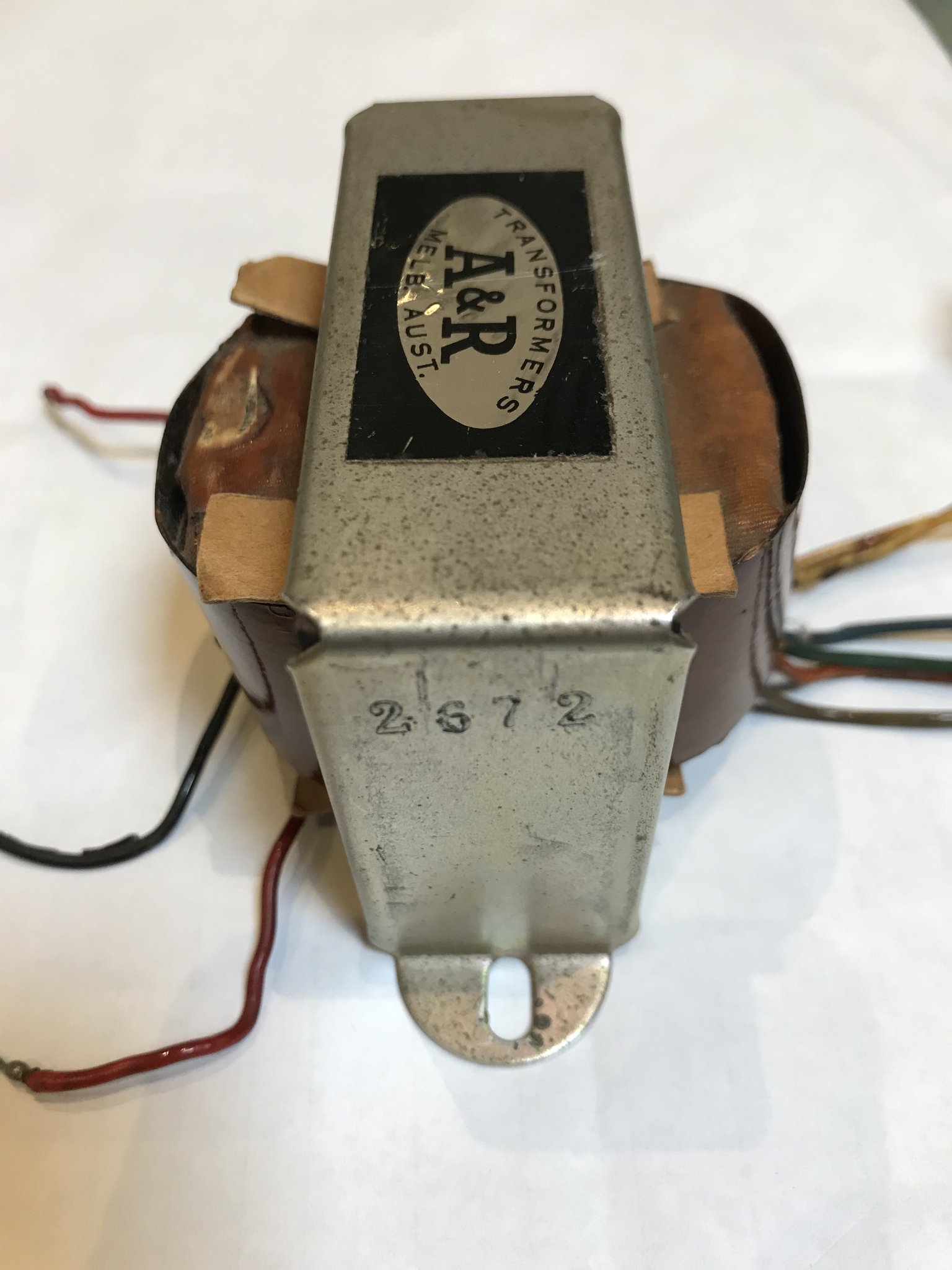

Can you give me some information/specs on the A&R 2672. I have one but can't find any info? Cheers
That is coz it is A&R Tranny. <snip>

My OPT is a 2672, which doesn't appear to be listed in the Ferguson Cat. It was sold as belonging to a cannibalised playmaster. Maybe I got duped 😕
I have an A&R 2672 transformer. I don't have the specifications and don't know the colour codes. I've done some turns ratio calculations and I can get around 3.75K to 16 ohms using the green - orange secondaries. Do you need it- I bought it as a used component? Cheers
Would you have the specs for an A&R 2672 transformer? I have a used one but can't make out the specs - can't find it listed in the A&R catalogue!That is coz it is A&R Tranny.
Keep going down that linked page and you will get to the A&R pages. You did'nt get duped.

Definitely 2672. Primary Red, Black (CT) Red. Secondary Yellow, Yellow, Blue, Green, Orange, Grey. About the same size as a Rola B29 O/P (10K P-P to 15 ohms) around 10 watts.Hi Bernhard,
2672 or 2627?
