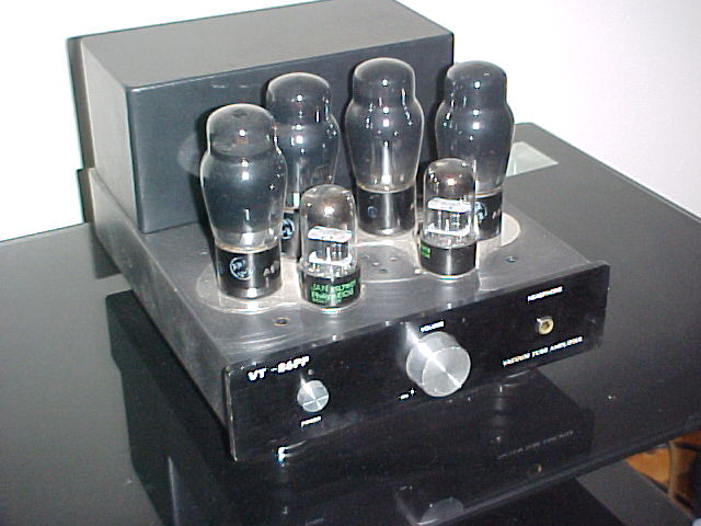

My everyday home amp is an enhanced version of that design, (fixed bias outputs, mosfet source follower buffer between input diff amp/splitter and the output tubes).
Post #602 schematic here:
http://www.diyaudio.com/forums/tubes-valves/72536-el84-amp-baby-huey-61.html
Power Supply is post #603
Post #604 is a variant I later abandonned.
Picture attached, I'm using 6V6G from the Sydney AWV factory with 6SL7 front end. The chassis is from MabelAudio too.
