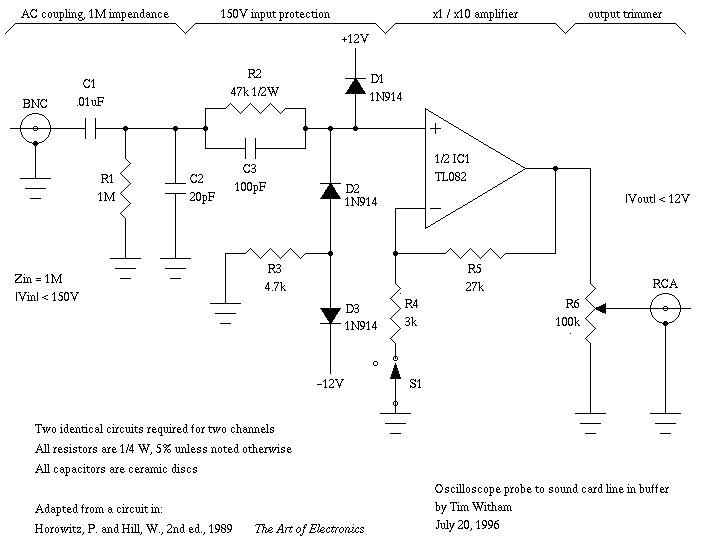

I'm very keen to do some of my own measurements at home, both of this amp and the chipamp that I plan to build. I've found some good software (Visual Analyzer), and I've gotten hold of a suitable sound card (Asus Xonar Essence STX: input THD of 0.0002% and output THD of 0.0003%; 192kHz/24bit).
I have bought the parts to create a dummy load, as described in http://www.k4eaa.com/dummy.html (except of course my dummy load will be 8Ohm rather than 50Ohm).
So the plan is to feed the amp's signal to the dummy load, and then on to the sound card via some kind of buffer or voltage divider. I've seen some suggestion that just a voltage divider is adequate, but most approaches I've seen use an opamp, such as this one (from http://xoscope.sourceforge.net/hardware/hardware.html):
I'd rather not use an opamp if possible, since I believe it'll add to the THD I'm trying to measure. Since I only want to attenuate the input signal, not amplify it, is the opamp necessary/useful?
Am I going about this the right way? Or should I be doing something else entirely, such as connecting directly to the signal before it hits the output devices?
jp_howard said:I'm very keen to do some of my own measurements at home, both of this amp and the chipamp that I plan to build. I've found some good software (Visual Analyzer), and I've gotten hold of a suitable sound card (Asus Xonar Essence STX: input THD of 0.0002% and output THD of 0.0003%; 192kHz/24bit).

The measured thd result can depend significantly on the measurement bandwidth. SC usually quote a 80KHz measurement BW which may be considerably less than you used - unless you have changed the input filter from the original values.
I would break up the dummy load into a 0R5 and 7R5 in series with the 0R5 near 0V and tap off the voltage between the resistors. The low output impedance will ensure the lowest possible THD from your sound card

Thanks for the advice. Can I just make sure I understand what you're recommending? What you're suggesting is to use the dummy load as a voltage divider, and use that voltage to directly connect to the sound card, without using any other circuit or components in between?VHF man said:I would break up the dummy load into a 0R5 and 7R5 in series with the 0R5 near 0V and tap off the voltage between the resistors. The low output impedance will ensure the lowest possible THD from your sound card
If so, perhaps even better would be to put a few 0R1's in series with the main dummy load, and use a dial to allow the effective gain of the voltage divider to be adjusted as required, by adding/removing those 0R1's. 🙂
Would you expect much/any noticeable impact on distortion of such an approach?
Your understanding of what I was trying to say is 100% correct. My recommendation to use the 7.5 + 0.5 was simply to retain the 8 ohm load with an approximated (best guess) attenuation, but you could change total R by 20% without any significant change in THD. Yes, you could use a few resistors in a ladder and tap from the most optimum point after trial / error but I would not recommend the use of any in line switching because even a small amount of contact resistance can increase measured THD. Your typical Jaycar selector switch would be terrible at these currents.
If you know what the voltage gain is ((R1+R2)/R1) then you can calculate the dummy load resistors for the correct attenuation so that the amplifier gain is 1 - which should be what you want.
Hope that makes sense.
That makes perfect sense, and has the benefit that it's even within the scope of my limited capabilities. It'll be a good little project for me to start on tonight whilst Evelyn is off playing tennis. I've even got a spare heatsink I can stick the resistors on to in order to allow a higher power for my dummy load (which I think is a bit easier to modify later than the mineral oil bath suggested in the link I provided earlier).
