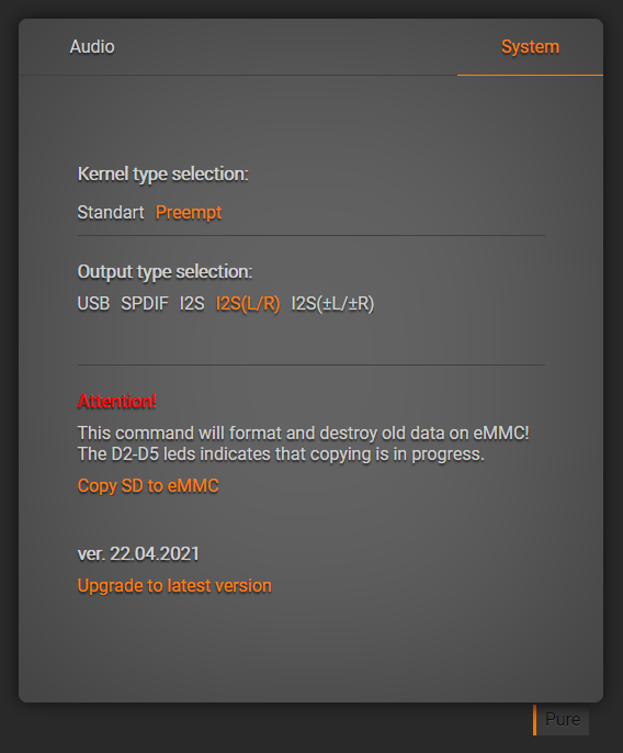

In the latest update for the Pure firmware I added the ability to connect old multibit DACs.
DATA0 - 30(P9)
DATA1 - 41(P9)
you are a legend ! 😀
do you recommend running preemptive or standard kernel ?
audio-wise, what are the differences ?
