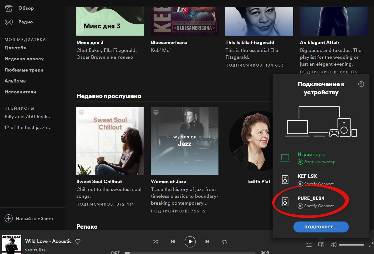

I'm probably a niche user that use the audio system by multiple sources ... So I would like to have the possibility to see the main characterestics of received audio stream on a small OLED display and how Pure is configured (naa/Airplay/upnp...) on the OLED too.
Another useful featurette will be the possibility to rename a BBB/Pure system uniquely in order to be easily identifiable from sources (es: BBBkitchen, BBBmain...)
Have a nice day and keep you safe
In the latest firmware, most players show the name PURE_XXXX. XXXX is the unique BeagleBone number.
If there are several Pure on the network, then the web interface is available under the names Botic7.local, Botic7-2.local, and so on.
Adding a small display is on the way, but with a very low priority.
I see the new names available on latest firmware .. really useful!
