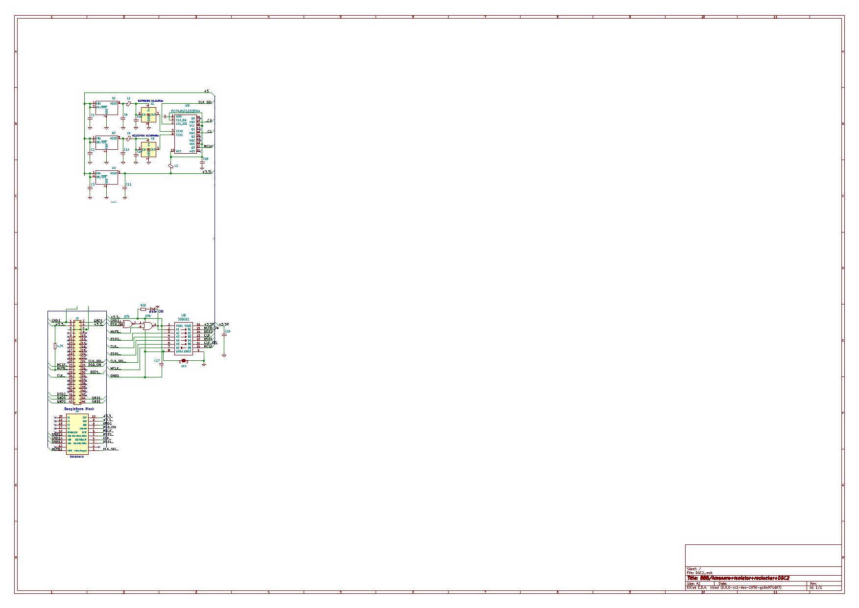

Just finished my dsc2,. I have a little noise issue in one channel, but I am going to sort that out.
Two things to comment.
1. There is apparently no connection from Amanero ground to ground before the isolator, meaning the ISO chip does not get power on its primary side. Easy rectified by a wire on the back side.
2. Why specify 5V at J1 when there is a 5V regulator onboard?

Hi Felipe. Everything is on Pavel's website (DIYaudio member ppy).
1. on previous gerber version there was an error on gnd connection on the header of the amanero. i fixed mine by scratching soldermask and the bridging the pin of the header to it.
the gerber version you can download today is fixed.
2. same question i have made to pavel... no real answer received. i am using with 5v to the BBG and 6v on the reclock and 7.5v on the output.

It's looking good with the second attempt at building one of Pavel's isolator/reclocker boards. I've mounted it on a BBB and have been running it as an HQP NAA with a DSD512 stream.
HQP works correctly, switching between 44.1KHz and 48KHz data so I must assume the oscillators and associated switching are working correctly and the Masterclock output is getting through the isolator to the BBB.
I've also checked DSD-on and Mute; both 3.3V when there's nothing playing and 0V when there is.
I can't connect check the data outputs from the reclocker as I don't have a dac board handy without a significant amount of dismantling of my DSC2 project, nor an oscilloscope until next week but it's all looking promising.

You could check whether a raw DSD data output indeed produces DSD data by filtering its output signal with some makeshift low-pass filter, a 1 kohm-10 nF first-order RC-filter for example, and then AC coupling it into an amplifier input using a capacitor of a few microfarads. If you hear music, then it is OK.
Don't turn up the volume too much, though, as ultrasonic residues might damage your tweeters at high volumes and the noise floor will probably be quite high anyway.
