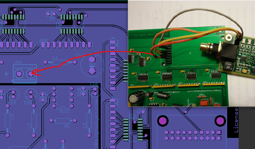

Good tool! I am very interested to see what will happen after this:
In this picture there is still missing PSU feed for IC1/IC2 that is normally coming from the Amanero +3.3V output...
I tried to make a clarifying picture:
(the DSC1 PSU board has suitable 3.3V output for the purpose)
Yes, I understand you point out. Perhaps the power circuit and the signal circuit should be consider in next layout. Expect Dsc-2.0.
I think I can add separate power connector for the 3.3V, but for the signals I prefer to have a direct plug-on daughter card for the interface instead of wires... I was thinking to add place for JLSounds OEM or I2SoverUSB board too. Or maybe just two PCB variants.
