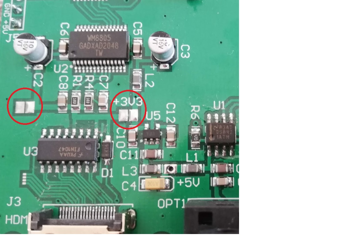

Hi Paul, I know that I2S_1 / I2S_2 jumper must be in position I2S_1. But do the 2 jumpers (red circle in the attached image) have to be shorted or free for our configuration ?
Hi all, just to let you know that everything works great, there seems to be some problem at 44.1 and 48 kHz, I'll analyze that along the way. In the next phase I will connect this same CD player directly via I2S to run at 384 kHz (now plays great with 24/192).

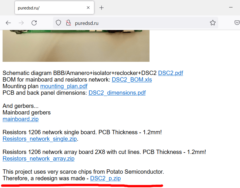

After a very long time, I'm finally getting back to this project, to build a DSC2
Just placed a Mouser order for most of the stuff, and also some connectors from proto advantage. Had to substitute a few ICs because couldn't find the potato semi stuff, but I think I found suitable replacements.
