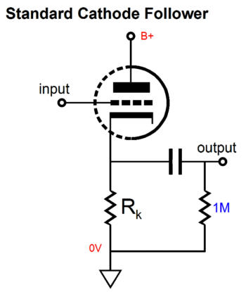

If i take a normal tube preamp design for instance an anode follower and i take the signal instead out of the cathode of the tube will i get a cathode follower ?
with a dc blocking cap of course.
Because this is the case with bjt ... if i take the signal from the collector i have Vgain .. instead if i connect the emitter i will have a buffer.
I mean ... is the collector like a plate and the emitter like a catode ? i am quite confused
Anyway i am very willing to try a buffer now. Thanks again.
You also move the load from the plate to the cathode. Usually a cathode follower has it's plate connected to B+ directly, and the "plate resistor" gets put under the cathode instead.

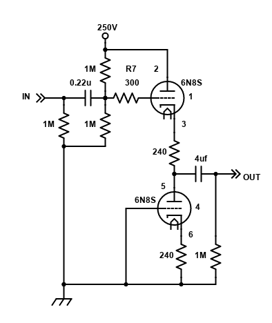

Here's a schematic of a buffer I built for a member on here named Kingsley. The bottom 6N8S replaces the normal resistor load for better linearity and it also moves the heat out of the chassis (if you mount the tubes on top like I do).
Thanks again. I think i have found the most basic schematic and i am attaching it. I will study cathode followers for sure. They could be the best option for me indeed.

So to sum up in a CF the plate can be connected directly to B+
So in the end i have only to calculate the value of the cathode resistor and then take the signal between the cathode and the resistor and it is done ? :eek:
That seems doable also for me ...
I will study more seriously the issue. I think i will try the basic CF first
Maybe it will be enough for my needs.

... Here's a schematic of a buffer I built for a member on here named Kingsley. The bottom 6N8S replaces the normal resistor load for better linearity and it also moves the heat out of the chassis (if you mount the tubes on top like I do)
Good morning. Since I have great difficulty in understanding electronics any complication, even trivial, becomes a big problem for me.
I would just like to understand better what better linearity means than the much simpler solution with the cathode resistor.
Better frequency response? Lower distortion? lesser Zout?
Thanks again for these extremely useful lessons.
Better Linearity = lower distortion
Imagine if the system is perfectly linear, the output signal is a perfect duplicate of the input signal, but with greater amplitude.
This is in reality limited by the finite ability to respond to frequencies that system can reproduce (frequency response or bandwidth) I.e. nothing can be infinitely fast. That limitation can give rise to other distortions, because the output cannot respond fast enough to input signals.
Output impedance, is determined by many things, the valve used, the use of feedback, and the cathode circuit.
