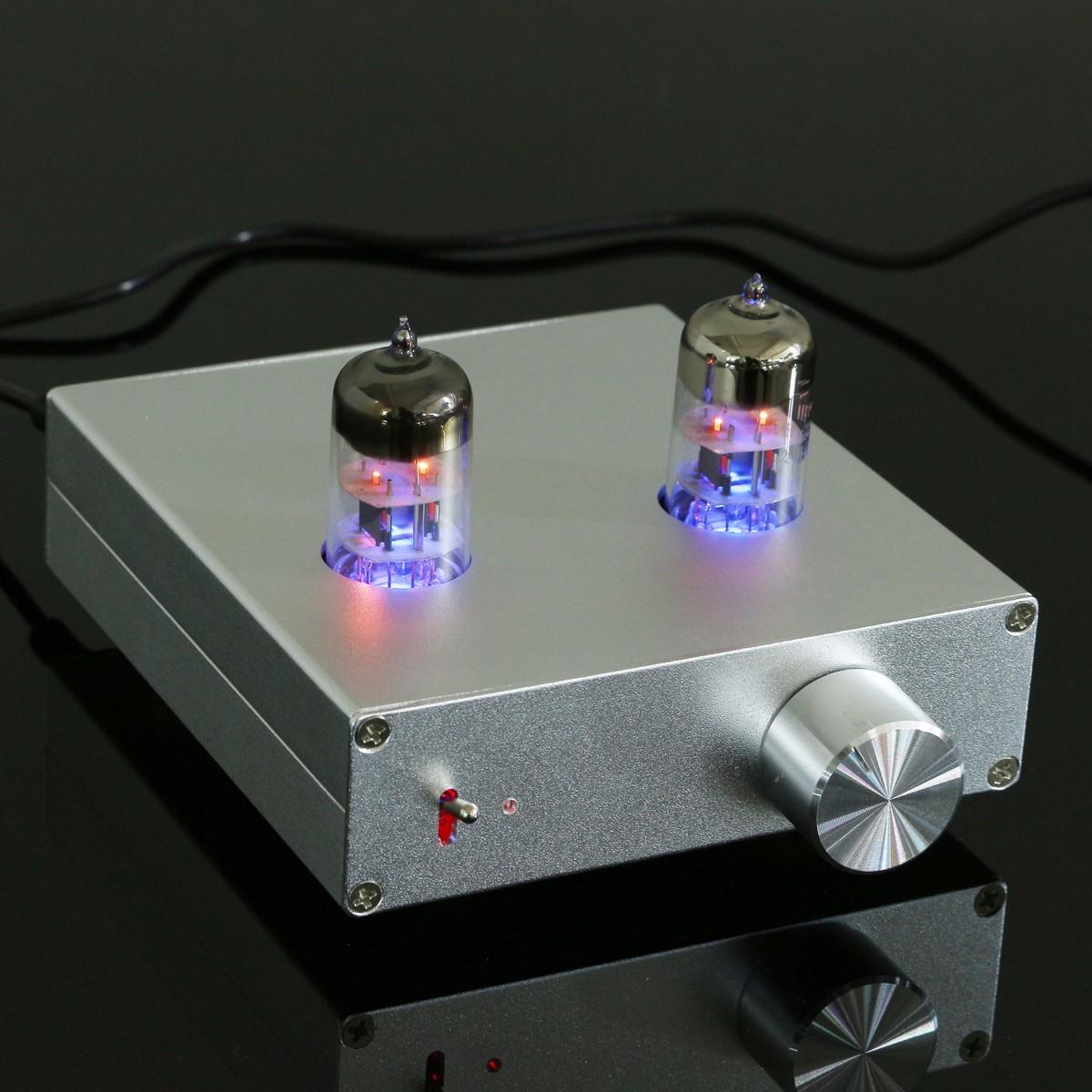

Good morning everyone, in the ambitious and maybe even silly attempt to extract blood from turnips ... I need some advice.
It happened in my hands dumped by a friend who buys cheap things and then throws them away (me ) a little preamp working with 12VDC with an internal a step-up dc dc converter to generate the anodes voltages.
The original tubes are Chinese 6N3s.
It works but I have some doubts about the sound quality

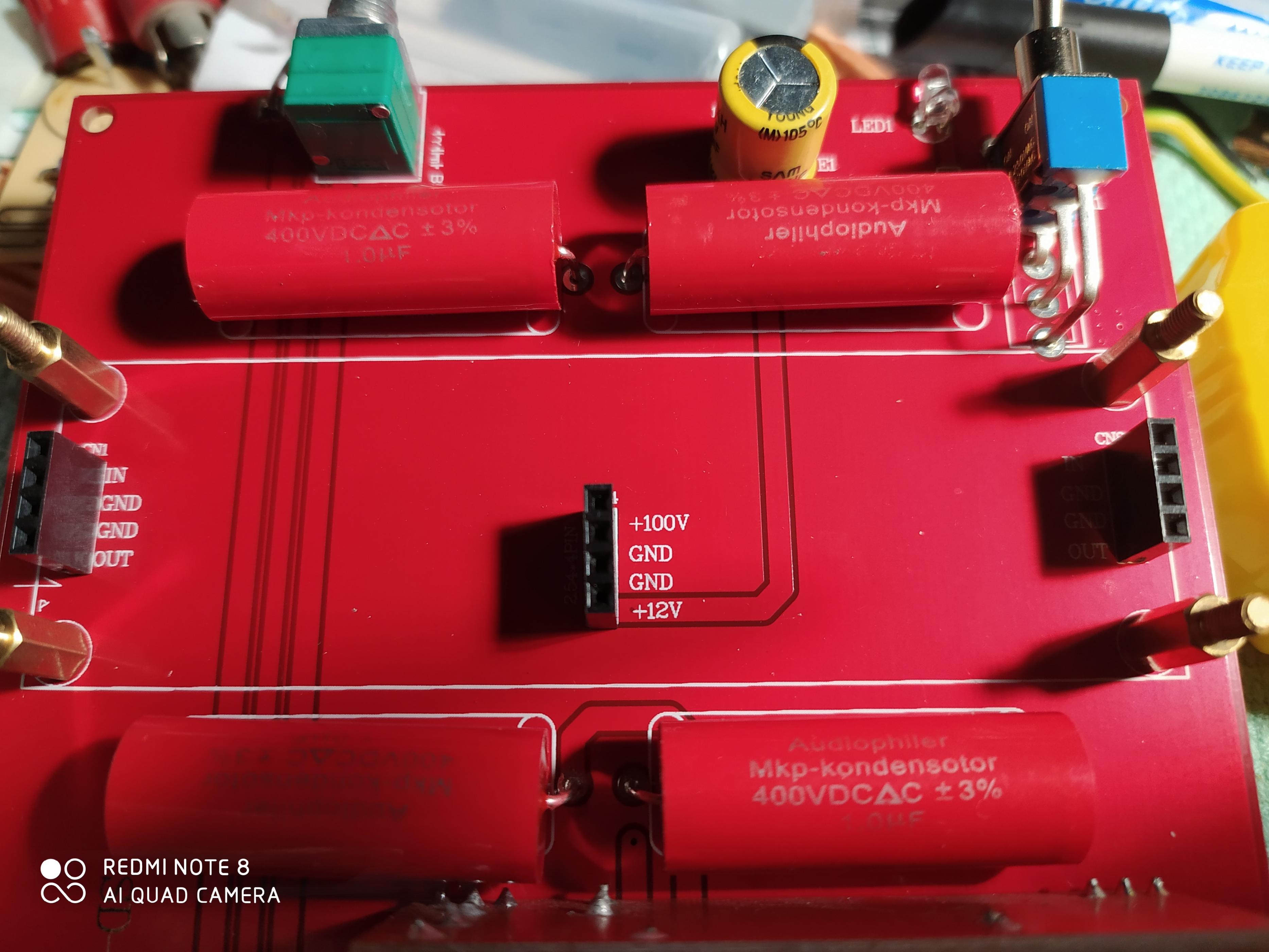

Looking inside I saw that it has a high voltage of only 100VDC I think the anodic one ... in absolute terms very low compared to the usual and recommended 200-250VDC.

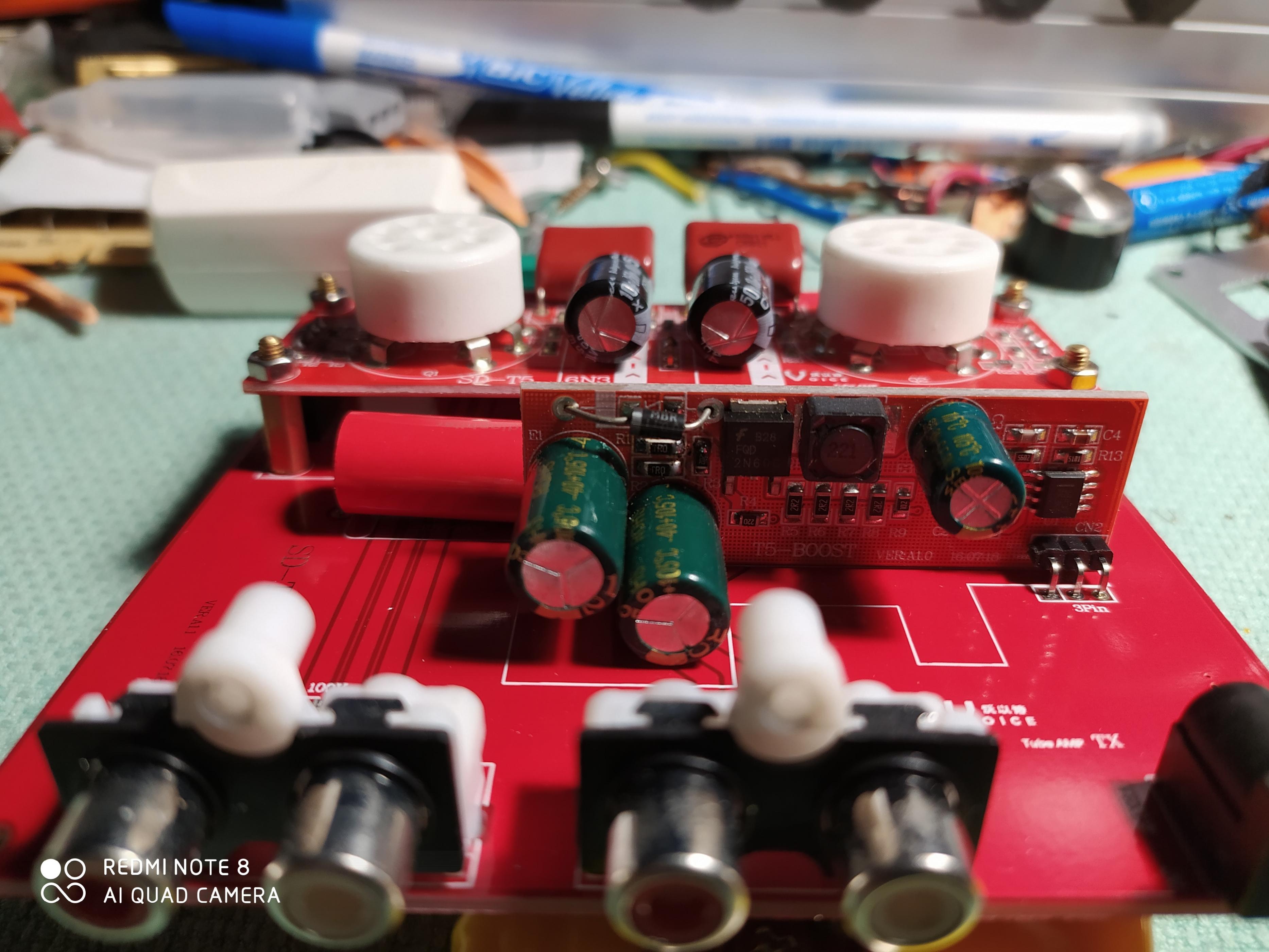

Through another friend I learned of the existence of converter sockets with bottom 6N3 and different tops that allow the use of a very huge variety of double triodes such as those of the 6922 family or of the 12au7/12bh7 family.
The question is ... is there a tube that works particularly well even when supplied with voltages this low ?
I would be willing to try it without much pretense with its relative socket converter. For example ... at low voltages a 12bh7 may be a better choice than a 6N3 or would the differences in sound be minimal in the end?
Let's say that these devices have introduced me to the sound of the tubes that I am starting to rather like, even if only for a hybrid system with a solid state power amp.
In general, this preamp already makes the sound more relaxed, fluid but with a good overall transparency. It is a little lacking in the highs and above all in drive ... in the sense that if i put a Toto track with a lot of drumming the drums do not come out from the speakers like i would. Probably it is a matter of not so low Zout ? i do not know. I have not been able to recover the schematic unfortunately. But i am willing to try in the next days.

The 6922 will work well with that 100 VDC B+ rail.
Hi ! thank you very much indeed for the very kind and precious advice.
Now the search is on for a pair of decent 6922 ...
Thank you very much again

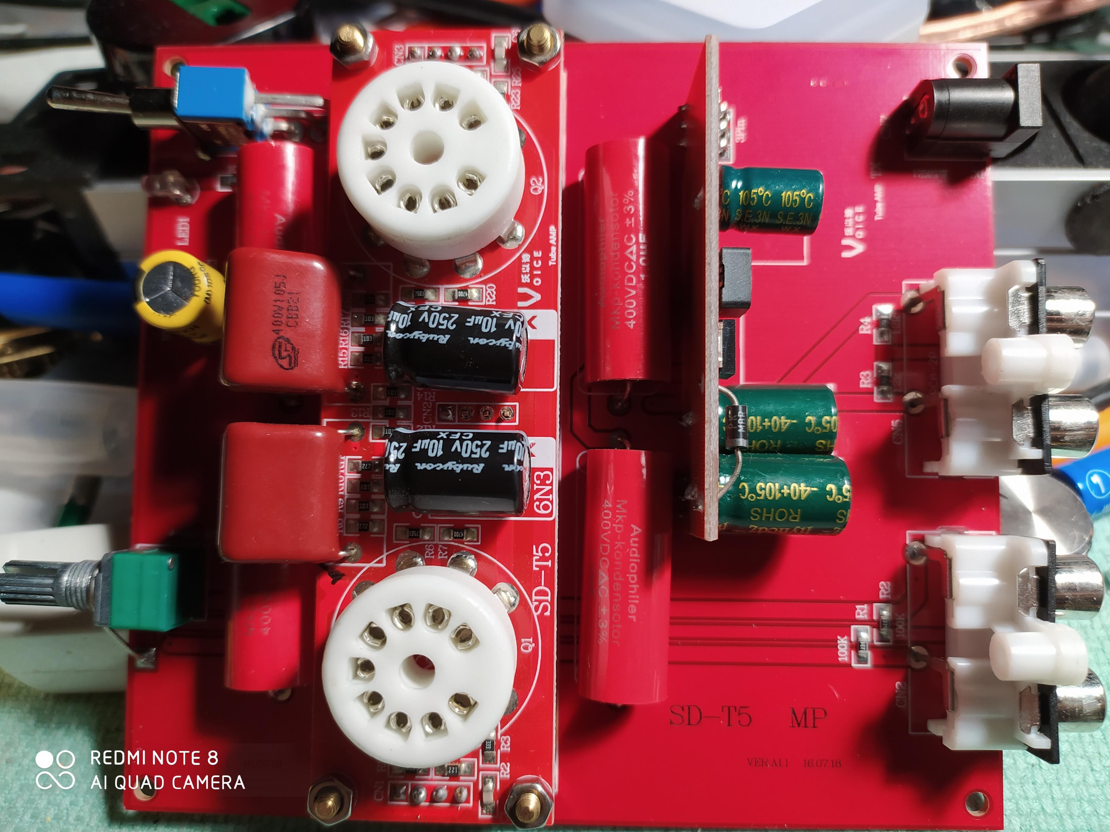

Every capacitor is fake on that board , if you want something good you have some work to do , anyway changing the tubes without changing component values for proper bias and so on is useless in my opinion ...
I tend to agree. The signal PCB really needs complete replacement. The PSU PCB might be useful, as is.
If (as is likely) the Chinese 6N3 resembles the Russian 6H3Π (6n3p), it's OK enough. The 6922 offers higher gm and lower RP at roughly the same μ.
The OP's remark about blood from a turnip is likely correct. People expect miracles from Chinese guano. However, dung remains highly malodorous.

Hi thanks a lot and yes ... i understand i have to buy genuine parts
And to act without even a rough schematici is like driving in the dark without lights on

it is very sad that a schematic is not available for analysisThe OP's remark about blood from a turnip is likely correct. People expect miracles from Chinese guano. However, dung remains highly malodorous.

I guess what you have is this:
T5 Tube Pre-Amp Matisse Buffer HIFI Audio 6N3 Tube Preamplifier With 12V Adapter | eBay
You can google for Matisse schematics. Some may be close to your clone.

I wonder if measuring the voltages on the tubes pins can be of some help to understand if the tubes are working in conditions very far from ideal
I could do that in the weekend ... while locked down

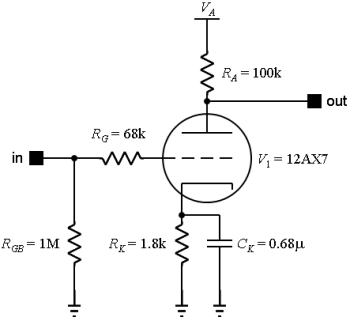

I would like to try a very basic schematic like the one attached ... but with the right tube for line duties
Lower anode voltages would be better ... like 150V more or less
People who say things like "cathode followers slow the sound" are the same people that think wire is directional or resistors need a run in period or that a golden power cord makes the amp work better. All horseschitt in my opinion.
The fact is, if you don't need any gain, a cathode follower is exactly what you're looking for.
12B4 as a cathode follower will work at 150V, so will 6DJ8. 6N6P will also work as will 6N30P but those are expensive... 6C45 is also expensive but would work.
FWIW, the 6N3P works fine at 150V plate (but you need to drop more voltage in the plate load).

The 6J1P strapped as a triode works pretty well at low voltages.
Even a 12AU7 CF wouldn't be terrible at 150V.

I have a quick question ... i am afraid a silly one.
If i take a normal tube preamp design for instance an anode follower and i take the signal instead out of the cathode of the tube will i get a cathode follower ?
with a dc blocking cap of course.
Because this is the case with bjt ... if i take the signal from the collector i have Vgain .. instead if i connect the emitter i will have a buffer.
I mean ... is the collector like a plate and the emitter like a catode ? i am quite confused
Anyway i am very willing to try a buffer now. Thanks again.
Since a small battery operated tube like the DL92 may run at 90V, I see no problem for any tube at that voltage.One must observe not to go over the max cathode current and anode dissipation.How much do you have to watch out for the fact that those tubes are rated at plate voltages of 30V max?
