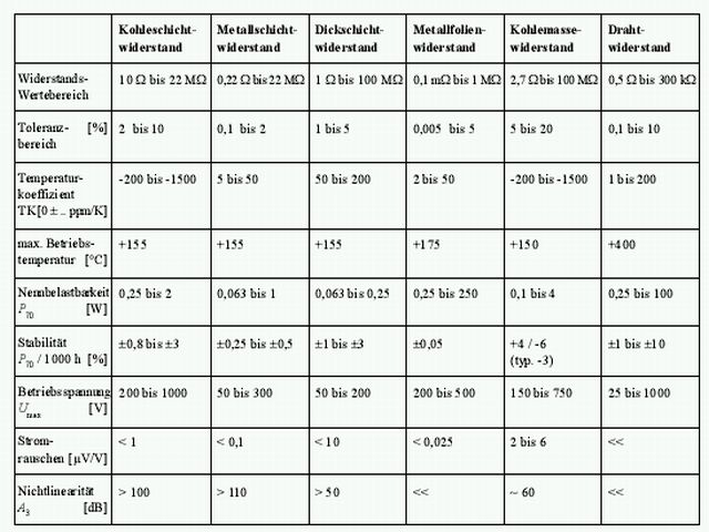

the best I found quickly on the net. There must be an article in one of the old Elrads somewhere, but the search program can't find it.
With voltage induced noise, I meant the current noise induced by DC on the resistor.
In the chart it is normalized to the resistance and expressed as uV/V.
regards
regards

see page 14 of the document for some VCRs
http://www.bbs1-kl.de/fileadmin/user_upload/schulformen/hbfi/Datenblaetter/widerstand.pdf
Thanks, Juergen. It would appear, though, that what I meant by size (physical dimensions) and what you meant (resistance value) are different; it's the ambiguity of language.
Given changes in composition for different resistance ranges, differences in coating thickness, and different trim geometries for different resistance values, it's impossible to determine from that chart what the current densities actually are. Contrariwise, if I pick a constant value of resistance and compare excess noise (from whatever source) between different wattages (and hence different physical size), the larger one will tend to have the lowest excess noise.
VCR is already english and means voltage coefficient of resistance, if I'm right.
Meßspannung means measurement voltage.
regards

Found an explanation for the A3 figure.
It's third harmonic distortion at a 10kHz fundamental.
The procedure is probably layed down in IEC 440.
regards
