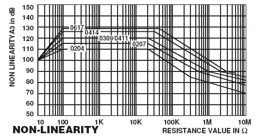

On the subject of resistor measurements, some manufacterers measure differences in “linearity” between different package sizes of the same metal film resister type (and off course different levels of current noise) and put this in their datasheets (see the Vishay Draloric example below). I would concur that you can also measure differences between different brands / models / types IF you have the know-how and the appropriate fixture.
This leads me on to my question: Is anyone aware of any sound differences for different sizes of same resistors? I know that Audionote in the UK propagate the use higher Wattage rated resistors of the same type in “critical positions” but this could obviously be a marketing ploy to sell more expensive components.
Thermal resistance between the layer and the air, thermal capacitance due to different volumes and areas of surfaces.
the differences can play themselves out in the transient tempco considerations. If the given resistor is identical, but higher wattage, then the change in substrate volume may keep them more linear under a given identical load.
Some say that such thing makes no nevermind, as the results, with regards to differences between the two are so incredibly minor-but they really then have to consider exactly how the ear really works. And how the ear works is entirely different than any measurement system that is used in audio-so the numbers found in measurement have very little bearing on how the ear hears a given item or component.
size matters!
I have trouble believing the thermal stuff in most cases (that's very easy to measure), but the effects of current density strike me as far more likely contributors- bigger resistors = lower current density.
Maybe Audionote is thinking in theory about what I believe in resistor manufacturing circles is called contact noise or as Mrupp said current noise.
Contact noise is dependent on both average DC current and resistor material/size. Since this noise is proportional to resistor size, the use of larger resistors will improve the performance over smaller resistors. Studies have shown a factor of 3 difference between a 1/2W and a 2W carbon comp resistor operating at the same conditions, dont know about other types.
The predominant noise in carbon comp, carbon film, metal oxide, and metal film is composed of contact noise, which can be very large at low frequencies because it has a 1/f frequency characteristic. Wirewound resistors do not have this noise, only resistors made of carbon particles or films. This noise is directly proportional to both the current flowing in the resistance and a constant that depends upon the material the resistor is made of.
If no current (AC or DC) flows in the resistor, the noise is equal to the thermal noise. The contact noise increases as the current is increased. This means that for low noise operation, the DC and AC currents should be kept low.
The material and geometry of the resistor can greatly affect the contact noise. Therefore, if you double the power rating of the resistor, which increases the size and area, you will reduce the contact noise generated by the resistor.

so you believe the charts are made with equal resistor temperature?SY said:I have trouble believing the thermal stuff in most cases (that's very easy to measure), but the effects of current density strike me as far more likely contributors- bigger resistors = lower current density.
