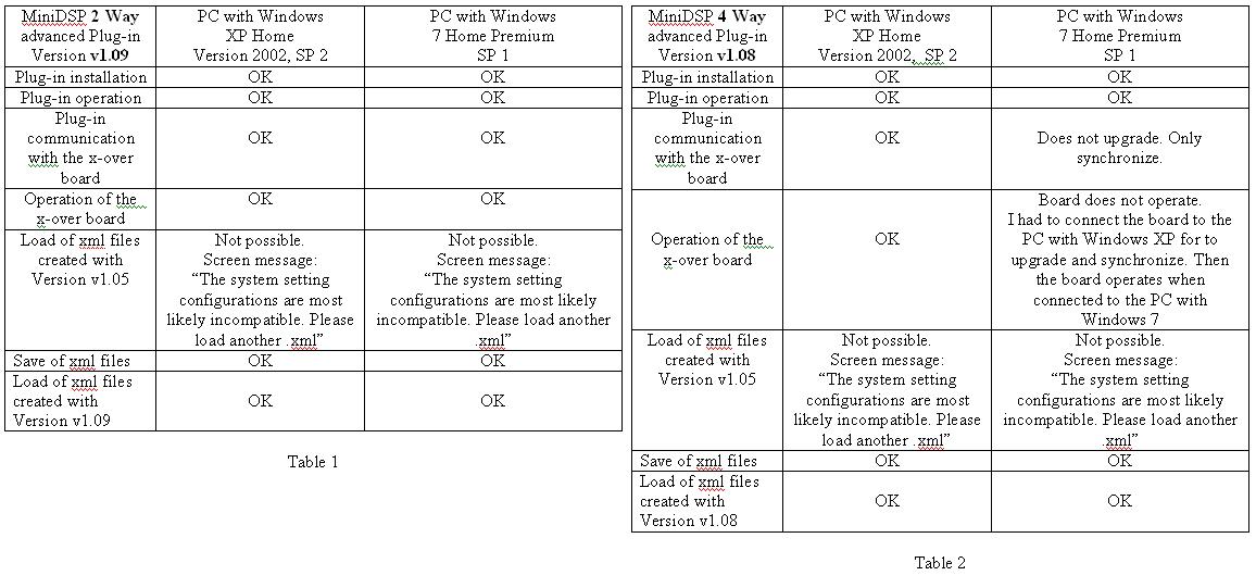

Report on using Beta version A. Behaviour of plug-ins ref. PC operating system
MiniDSP 2 Way advanced Plug-in Version v1.09 (Release date 12/3/2013)
MiniDSP 4 Way advanced Plug-in Version v1.08 (Release date 12/3/2013)
See attachment for details.
The problem is that the beta version does not load old configuration .xml files.
I used an .xml editor e.g.
Download XML Notepad 2007 from Official Microsoft Download Center to read my old .xmls and copy the settings into .xml created with the beta version.
George

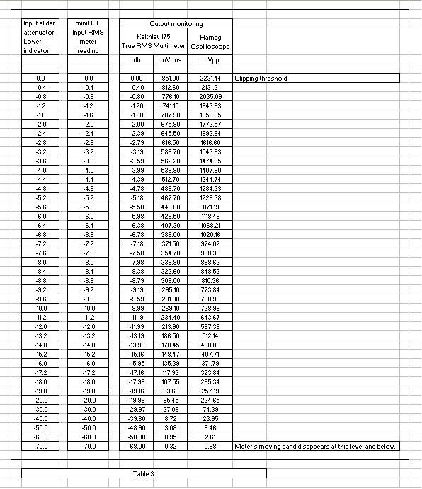

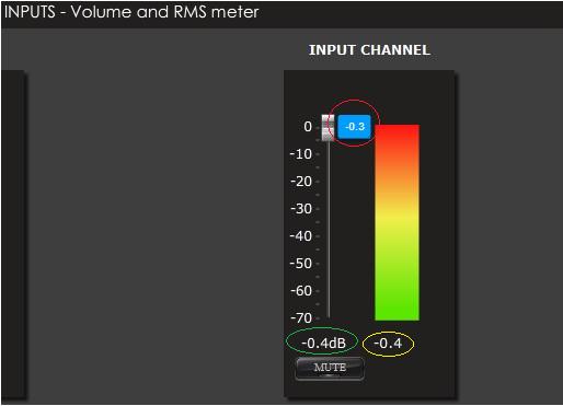

B. Attenuation slider steps. C. RMS Meter reading with sinusoidal signal
Each step of the input (and output) attenuation slider is 0.4db all along down to the maximum attenuation of –70db.
There are two numerical indicators for the applied attenuation in db.
One is just above the mute button always visible. This is the correct attenuation reading.
The other appears when we click with the screen pointer over the slider. This comes inside a blue frame and it’s indication is a bit in error, on some steps it read 0.1db below the actual attenuation.
Input and output RMS meters read correctly in db, following the voltage law [ db=20*LOG (V/Vref) ]
The Vref is the 0db of the meter which correctly represents the maximum signal before clipping.
For 2V boards:
0db at input meter corresponds to 2.173Vrms analogue input sinusoidal signal.
0db at output meter corresponds to 0.851Vrms analogue output sinusoidal signal.
For 0.9V boards:
0db at input meter corresponds to 0.981Vrms analogue input sinusoidal signal.
Now, the top of the moving band can be used as a visual level indicator as it fluctuates close to the attenuator’s db scale.
Meter’s moving band disappears below –70db signal level.
For precise signal amplitude monitoring, the numerical signal level in db appears below the meters moving band (resolution 0.1db).
The output meter correctly registers the signal level reaching the output, that is, it is affected by any attenuation setting at the input and any boosting by the filters.
As long as the cumulative boosting by the filters in any specific frequency band do not exceed 24db, the output meter reading below 0db can be reliably taken as an indication for undistorted analogue output signal, that is unclipped and unskewed signal.
If boosting in any specific frequency band exceeds 24db, signal waveform will be skewed and this distortion does not reflect in the amplitude, thus output meter may continue to show negative db numbers. The logic is a bit complex and I will explain if you want, but always remember not to exceed this 24db cumulative boosting.
George

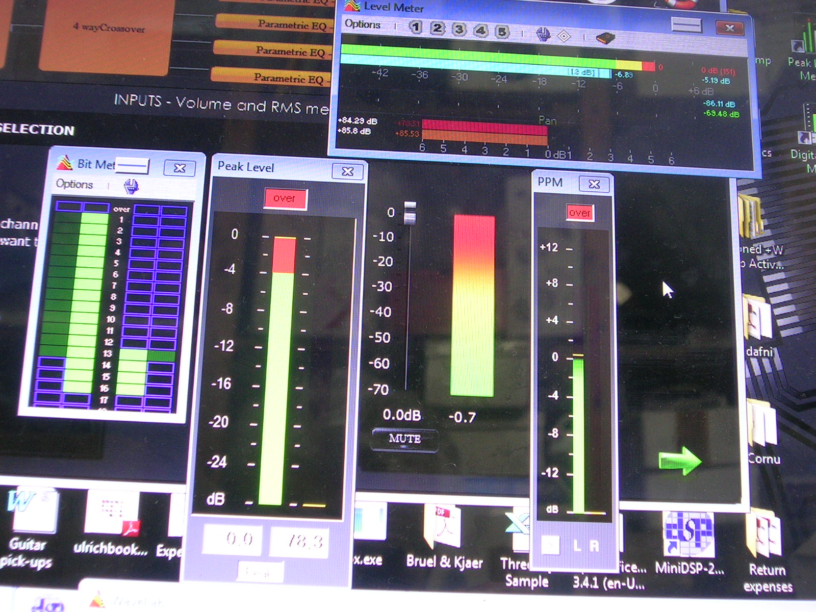

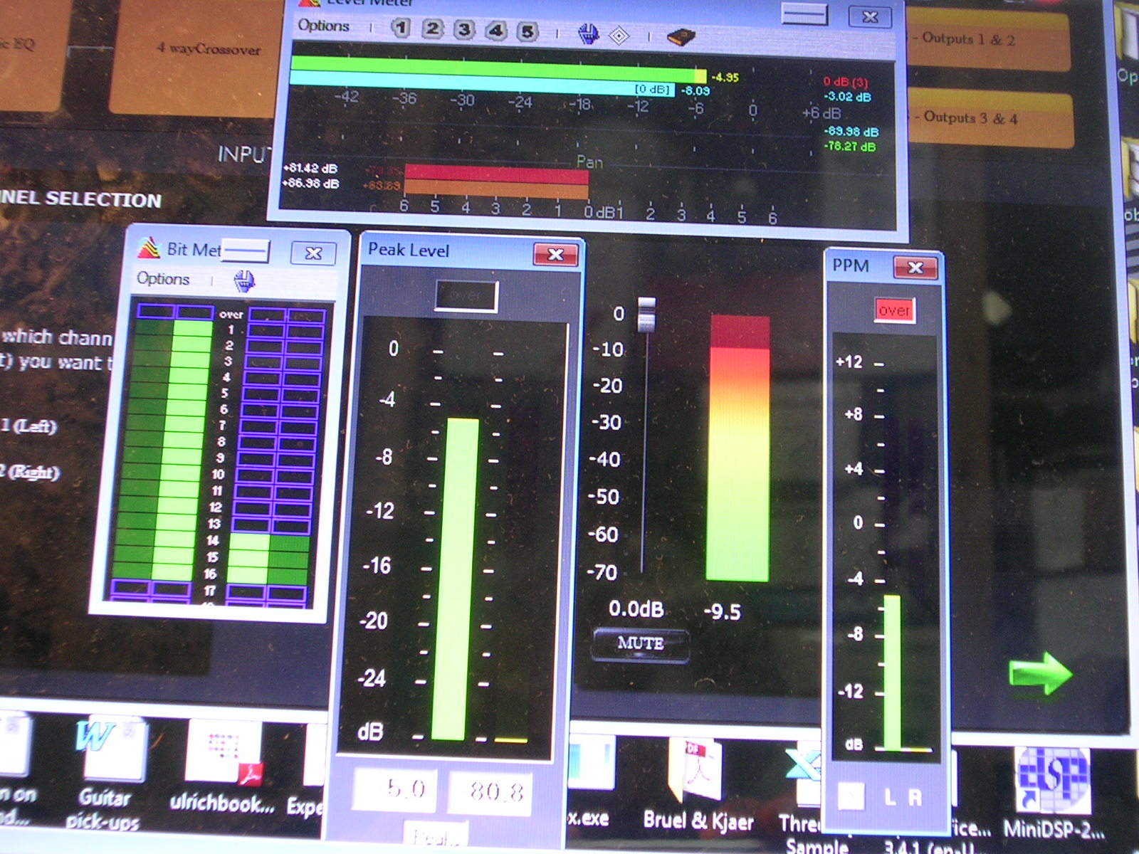

D. RMS Meter reading with dynamic music signal.
I find the RMS meters in this version to respond somewhat faster to dynamic signals than the meters in the previous version. But still, they do not have the ballistics of a peak meter.
A led indicator showing instantaneous peaks exceeding 0db (with holding time 1 sec) is still in need.
I spent some hours watching in real time and playing back pc screen video recordings, comparing behavior of miniDSP RMS meter to VU meter, peak meter, PPM and bit depth meter.
In case you don’t have a signal generator to set the 0db level and you don’t know the maximum output of your source, I would suggest:
For heavily compressed music, the input meter not to exceed –3db level (3db headroom). These recordings are close to 0db most of the time and have encoded already clipped material (good stuff actually for setting zero level if you don’t have a signal generator).
For relative uncompressed light music, the input meter not to exceed –12db level (12db headroom).
For good recordings (jazz, classic and opera fall in this category), the input meter not to exceed –22db level (22db headroom).
For live unprocessed takes, the input meter not to exceed –30db level (30db headroom).
George

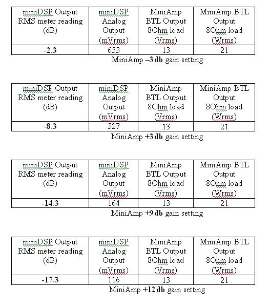

Doing the output measurements shown in Table 3 http://www.diyaudio.com/forums/attachments/minidsp/336300d1363385323-signal-level-minidsp-x-over-meter-attenuator-readings.jpg
I have to add two issues which are related to hardware, not to software.
1. The output noise of the miniDSP 2x4 board (Input shorted, open or with 50R across and no signal applied. Output loaded with 10k,) is 15mVpp 2MHz and harmonics.
2. Switch-off thumb:-200mV. Switch-on thumb: +2mV.
Duration of these thumbs depend on the capacitance of the psu that feeds the board.
Switch-off thumb is large and considering the gain of an amplifier connected to the output of the board, is a bad story for speakers. Always turn off amplifiers first, wait some tens of seconds and then turn off miniDSP board.
George

After dealing with the gain through miniDSP x-over board with the beta version of the 2x and 4x plug-in, I had to look at the gain of the miniAmp
miniAMP | miniDSP
This board is very handy during the experimentation phase.
As with the x-overs I had to check the gain of the miniAmp for to see the signal level up to overload.
Jumpers allow for –3db, +3db, +9db and +12db gain setting. They refer to I2S input signal level, so I had to find out what these numbers mean.
Feeding the input of the stacked miniDSP x-over with the 1281Hz sinusoid as before and having the settings flat, I was monitoring the analog output (10kOhm load) and the speaker output of the miniAmp (8Ohm load).
Below is the max levels as shown by the output RMS meters of the miniDSP x-over for max undistorted output of the miniAmp.
George
