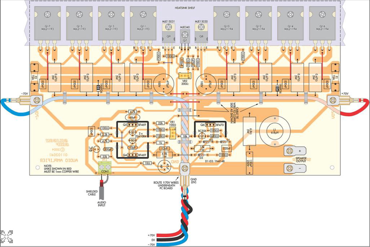

That's nice Mark - I think laying the power paths over the ground returns would be even better, but I understand you are showing the way forward here.
Here is a layout from a few years ago from a Silicon Chip design amp. Note how the ground and supply tracks are arranged. In this case, the designer ran the supply rails over the output bus to reduce the class B radiated loop areas. Because the transistors are not covered by the PCB, they missed an opportunity to further reduce the supply rail<>output bus loop area, but nevertheless quite good IMV.
Note this is a single sided PCB. With a double sided THP board (cheap as chips nowadays), the tracks would be on opposite sides of the board so no need for the cable gymnastics. Note the speaker output is also not optimized as we have discussed.
For a good example of a practical layout taking all these factors into account, see the Wolverine thread - the layout discussion is in the last c. 30 pages.

Try out the grounding scheme in simulation first. Put 1uH inductor and 0.1 Ohm in serial to all the power wire and ground wire, also add them to all the wires between the preamp and power amp.
Then use square wave to simulate. A good ground scheme should not cause extra overshooting at output.
You can also simulate power supply noise rejection using this method.

Here is a way to verify the correctness.
This is a good idea. I will try this when I have some free time.
