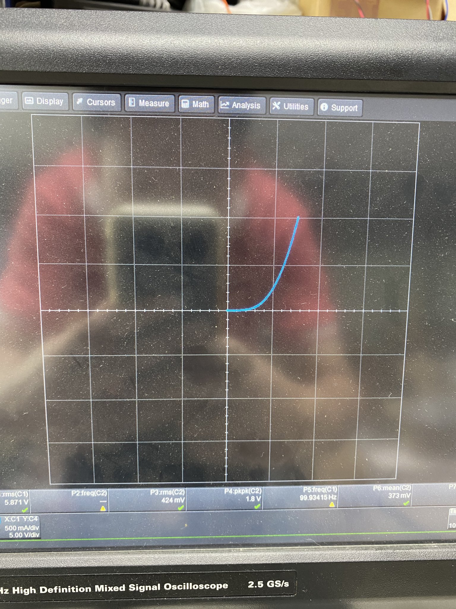

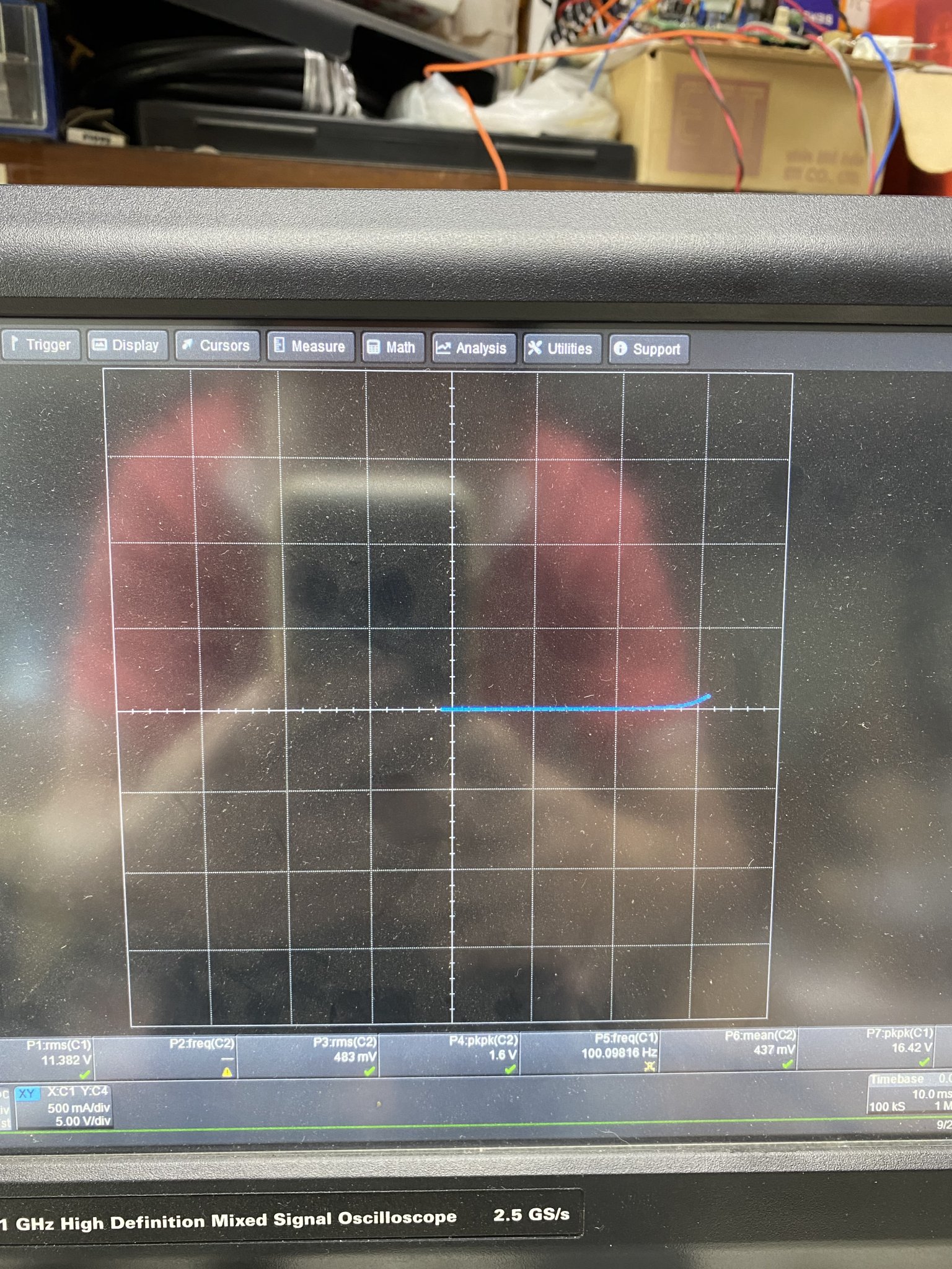

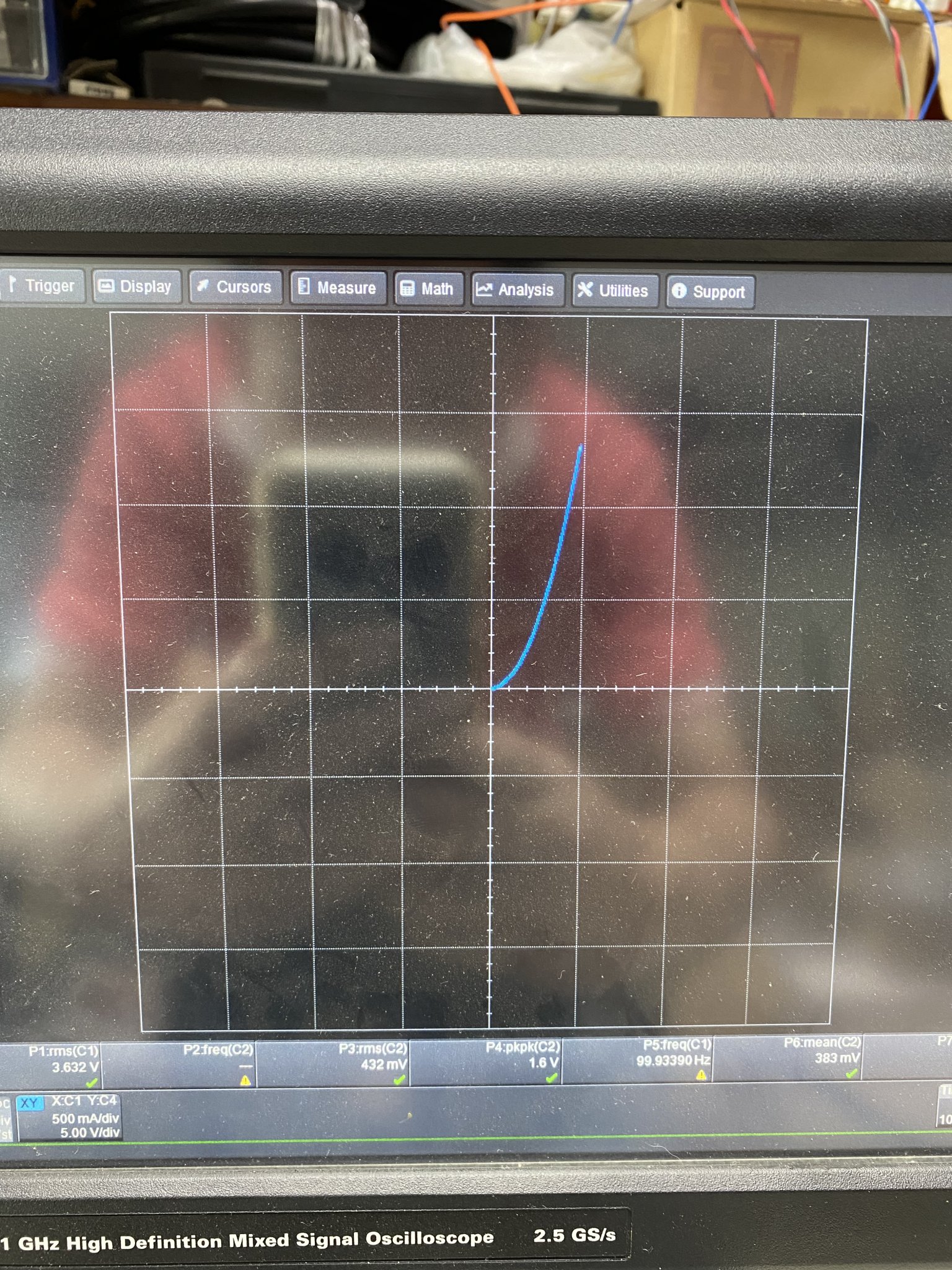

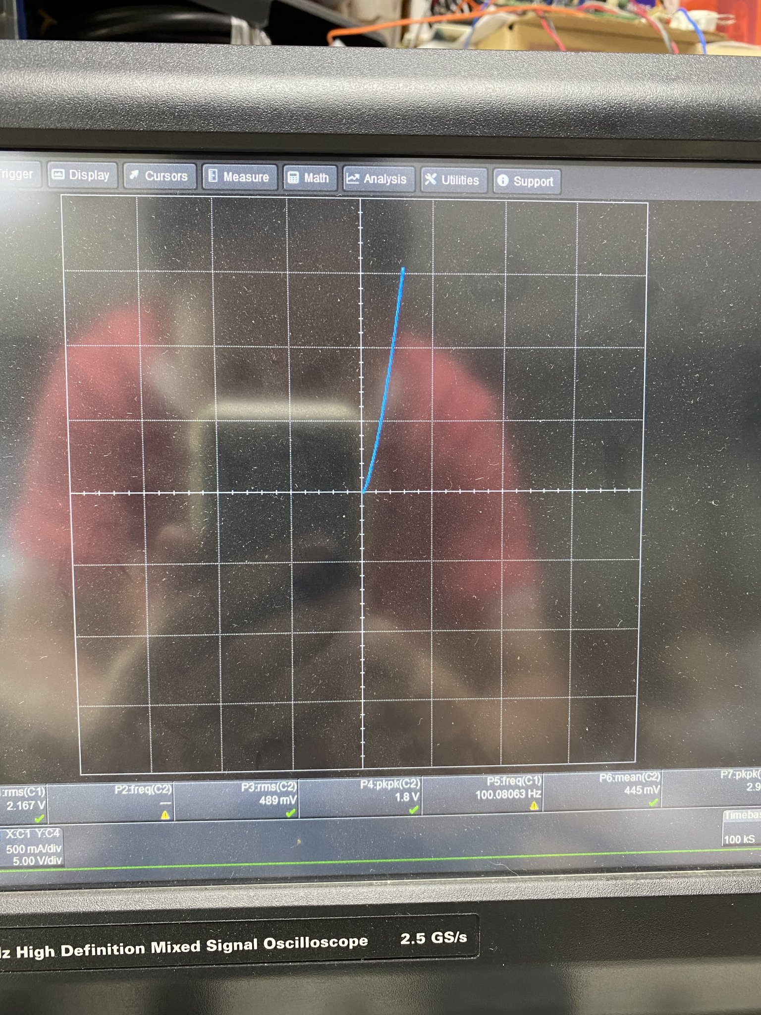

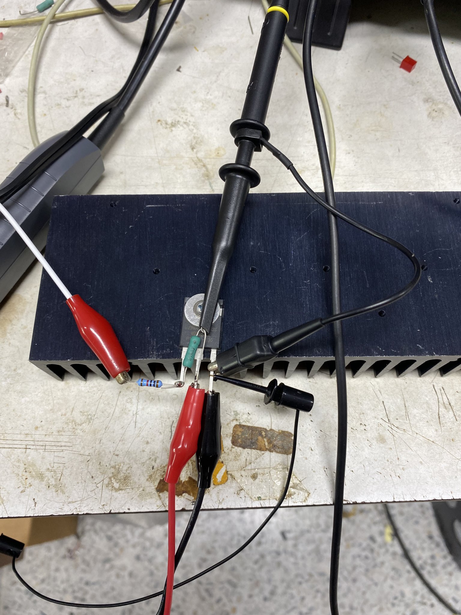

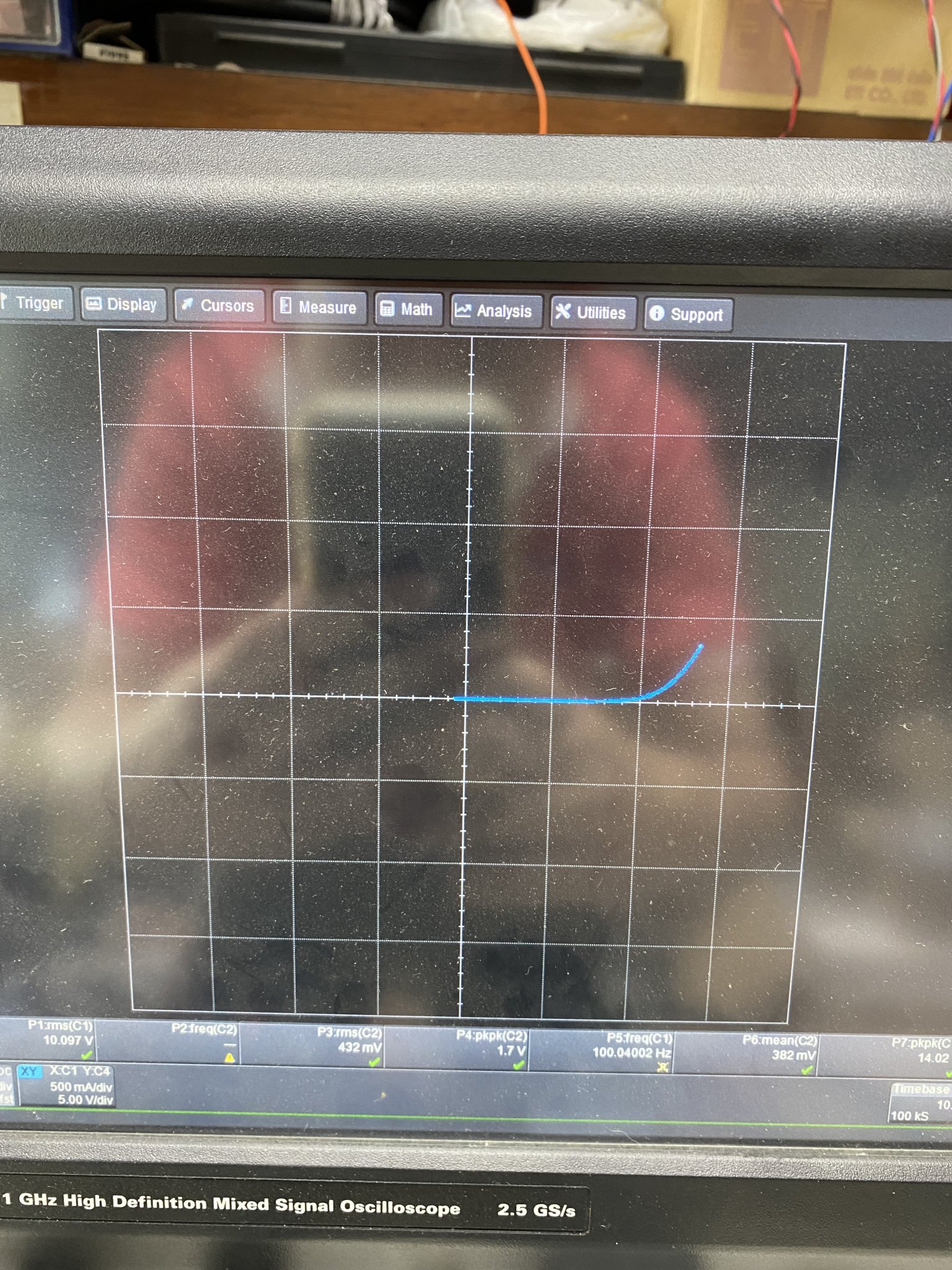

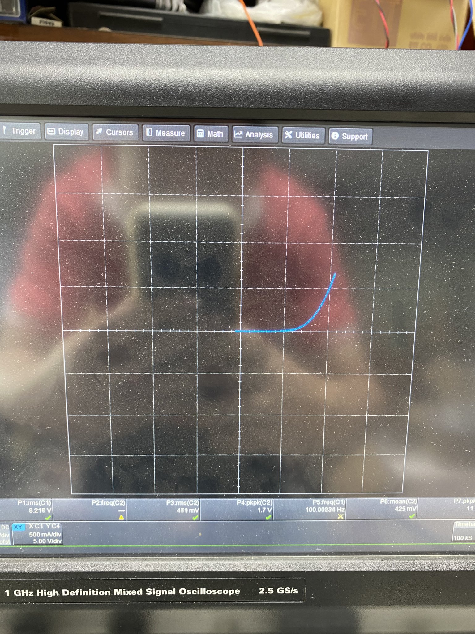

I believe that here it is known as Schade feedback after O.E. Schade, who used it on Pentodes to make them like Triodes.
My fast made v-i curve of this connection.
Sorry that I do not have high power curve tracer.
