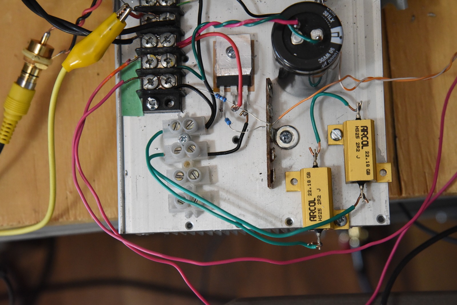

I couldn't go to bed without finding out how this circuit worked, so I reconfigured the source follower test amp to common source. The new circuit does not have a bias supply, so the circuit is simpler than the common drain amp.

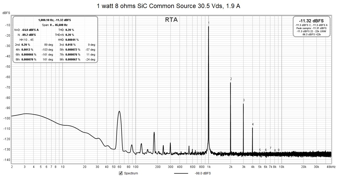

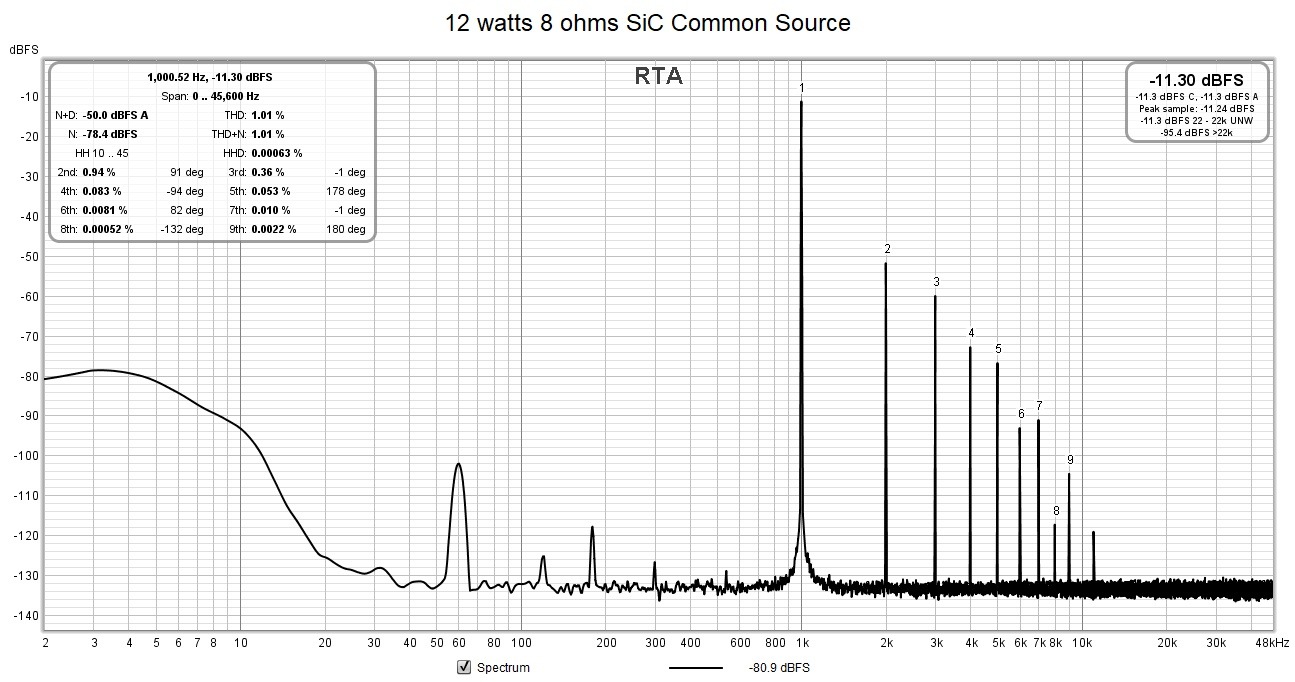

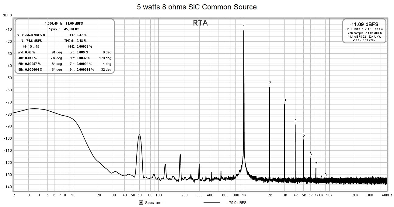

When everything was hooked up, I verified that it was indeed working and amplifying a signal. At that point, I had to do a quick distortion measurement, or I would definitely not get to sleep. After firing up REW, and fiddling around with the power supply voltage, I was pleased to see the amp put out 1 watt into 8 ohms with about 0.2% THD. Not super low distortion, but good for a single-ended common source amp.

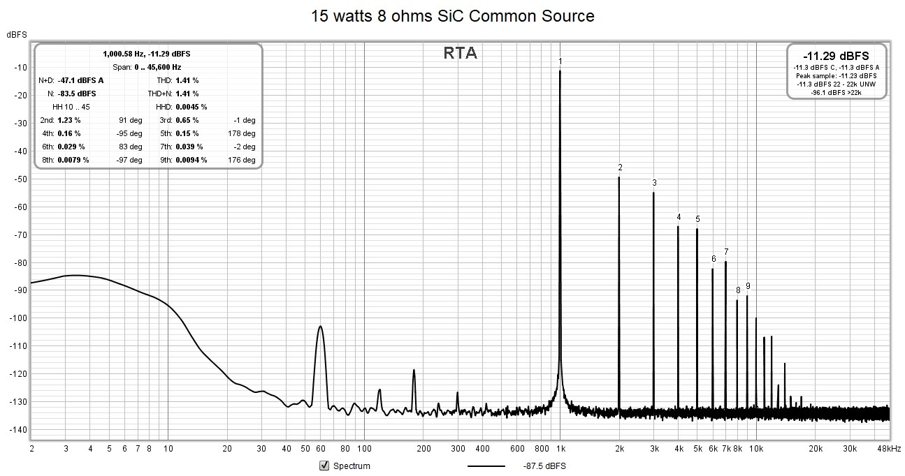

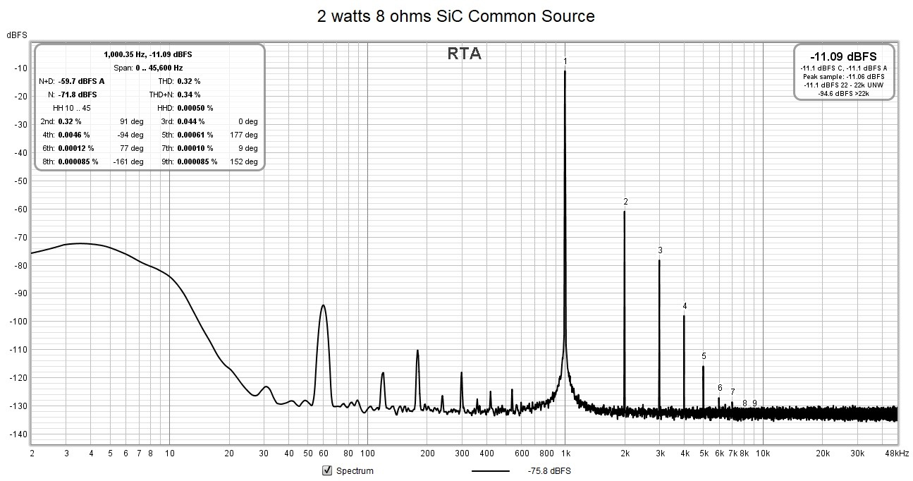

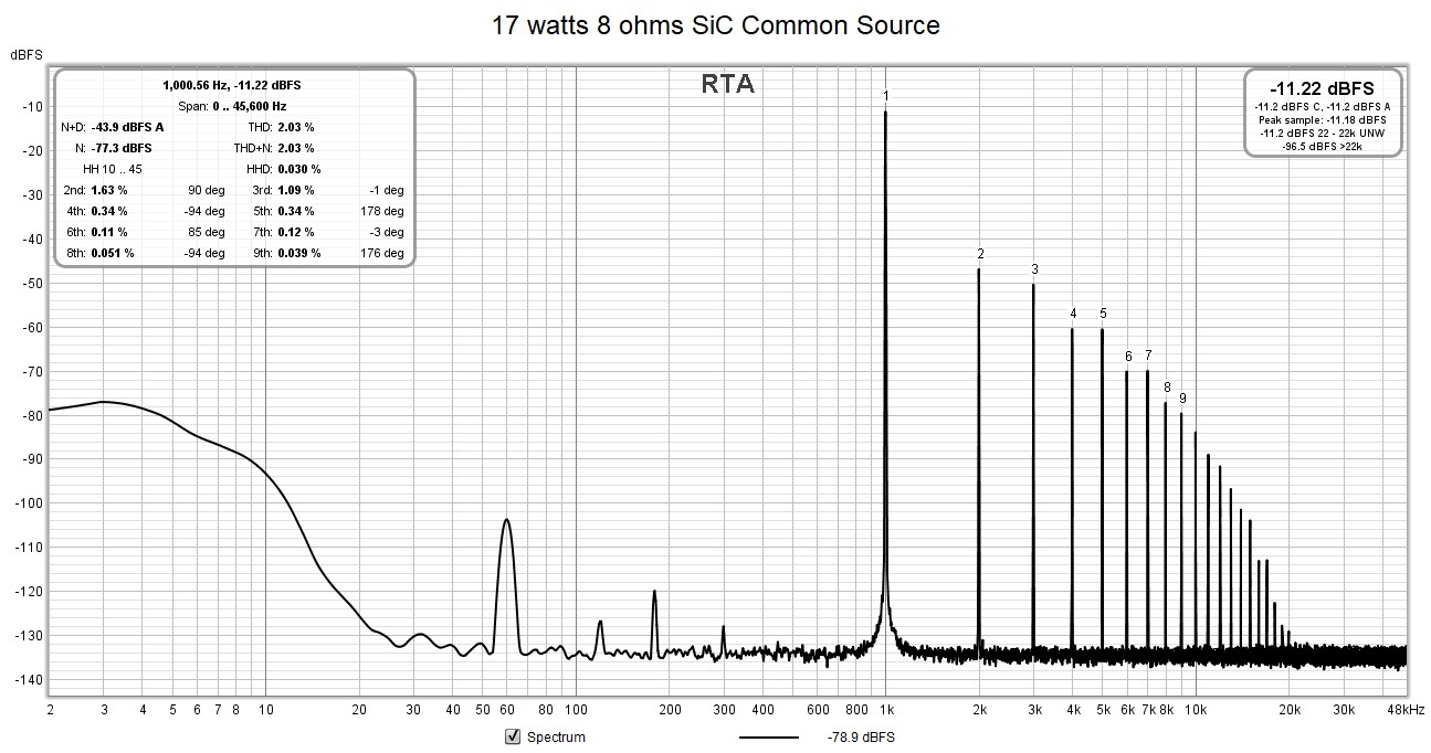

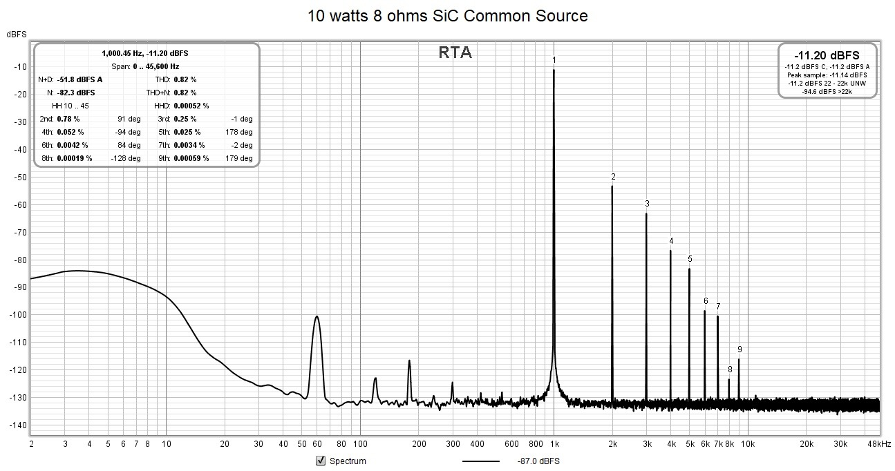

Today, I varied the power supply voltage without changing the 4.4 ohms of source resistance and found that the power supply of 42 volts produced the nicest balance of harmonics. I could get lower THD but the 3rd harmonic would start to dominate. With the 42 volt power supply, the operating point was 30.5 volt Vds at 1.9 amps.
Total harmonic distortion reached about 1% at 12 watts into 8 ohms, 1.4% at 15 watts, and 2% at 17 watts. Gain is 1.8x.
For the 1 watt output distortion test, the signal source was my 1 kHz oscillator. For the subsequent higher power output tests, I used the prototype SiC preamp to boost the oscillator output to the power amplifier under test.

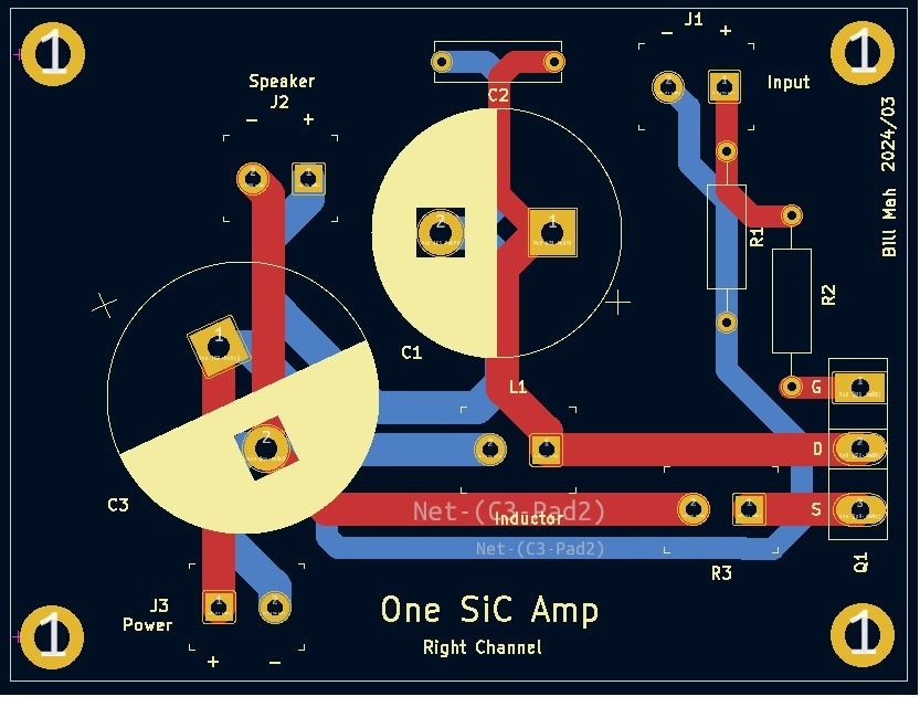

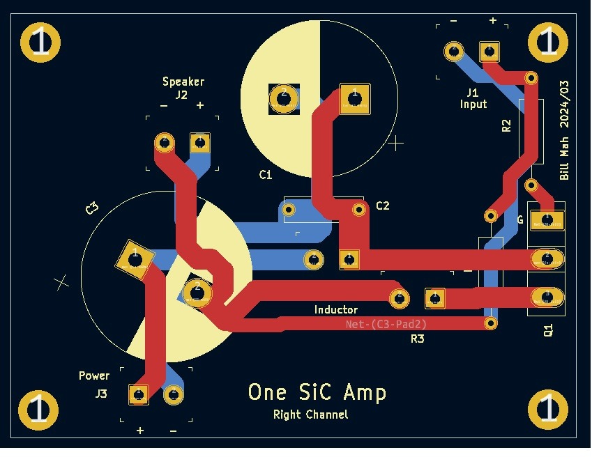

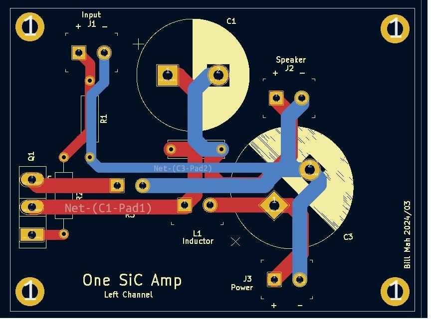

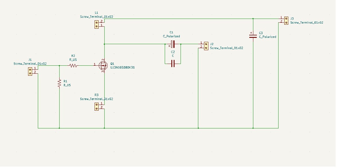

I've already got too many amps, but I want to build this SiC common source amp. For one, I only have one pair of common source amps, the BAF 2015 THF-15S monoblocks amongst several common drain designs, so it needs some company. This SiC design sucks a lot of power and will be heavy, so it will be a monoblock build as well.
I put together a couple of PCB designs on KiCad, one for each channel. Very few parts, so the boards are small. The source resistors will be mounted on the heatsink, as they dissipate about 25 watts.
The SiC transistor dissipates about 70 watts, so with a combined heat load of about 100 watts, the Modushop 300 x 40 x 210 heatsinks should work for each channel. An Antek AS-3216 300VA 16V transformer wired in series will provide the power for each amp.

Over the last week or so, I've been coming back to the PCB layouts and making small changes that are hopefully improvements.
I wasn't happy with the input loop area of the right channel so that was changed to minimize it a bit more.
I moved the output bypass capacitor to shorten the traces to it. This will reduce the inductance and offer less impedance to the higher frequencies, which is what the bypass capacitor is supposed to do.
The last thing I did was to separate the returns to the ground point at the negative terminal of the decoupling capacitor. The idea was to reduce the interaction of the high return currents with the lower return currents, hopefully resulting in less noise.
I haven't designed many PCBs but I have been reading a lot lately about their layout, so I am trying to apply that information to my work. Hopefully, I've bottomed out on the Dunning - Kruger curve and am on the upswing.

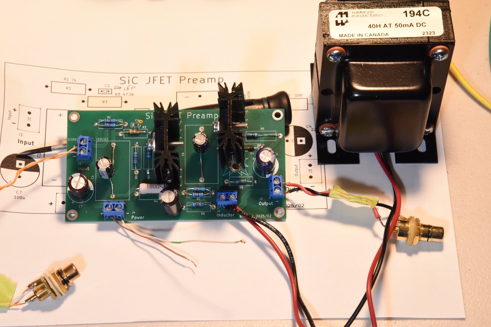

The adventure is alive and ongoing. In particular, the SiC preamp circuit is being used as the voltage amplifier in my 100 watt SIT follower amp project (https://www.diyaudio.com/community/...nt-resist-the-sirens-song.421505/post-7942974). I had circuit boards made and the design has been verified correct. This voltage amplifier stage was just what I needed to drive the SIT follower output stage to over 100 watts output into 8 ohms. Tests show that for 84V peak to peak 1 kHz output, THD is 0.0037%. I still intend to build this as a stand-alone preamp once I finish the 100 watt amplifier.
I intend to build the SiC follower amp as well. It will be perfect as another summer amplifier. I still need to design a PCB for it, though.
For now, I'm concentrating on finishing my 100 watt SIT amp, and then it's back to the SiCs. The SiC fever continues.

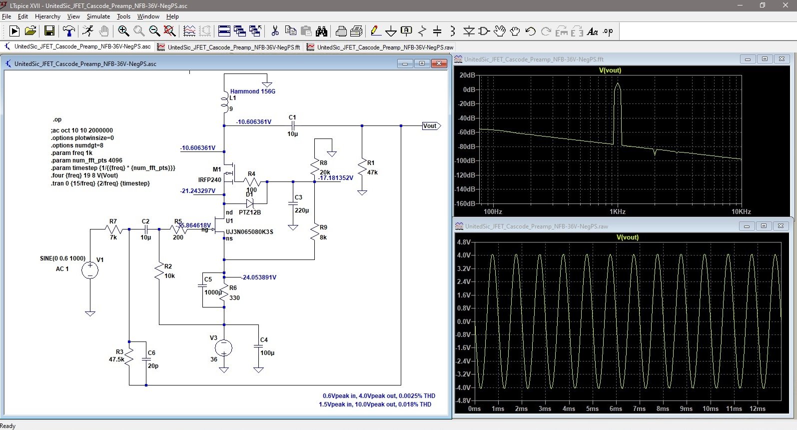

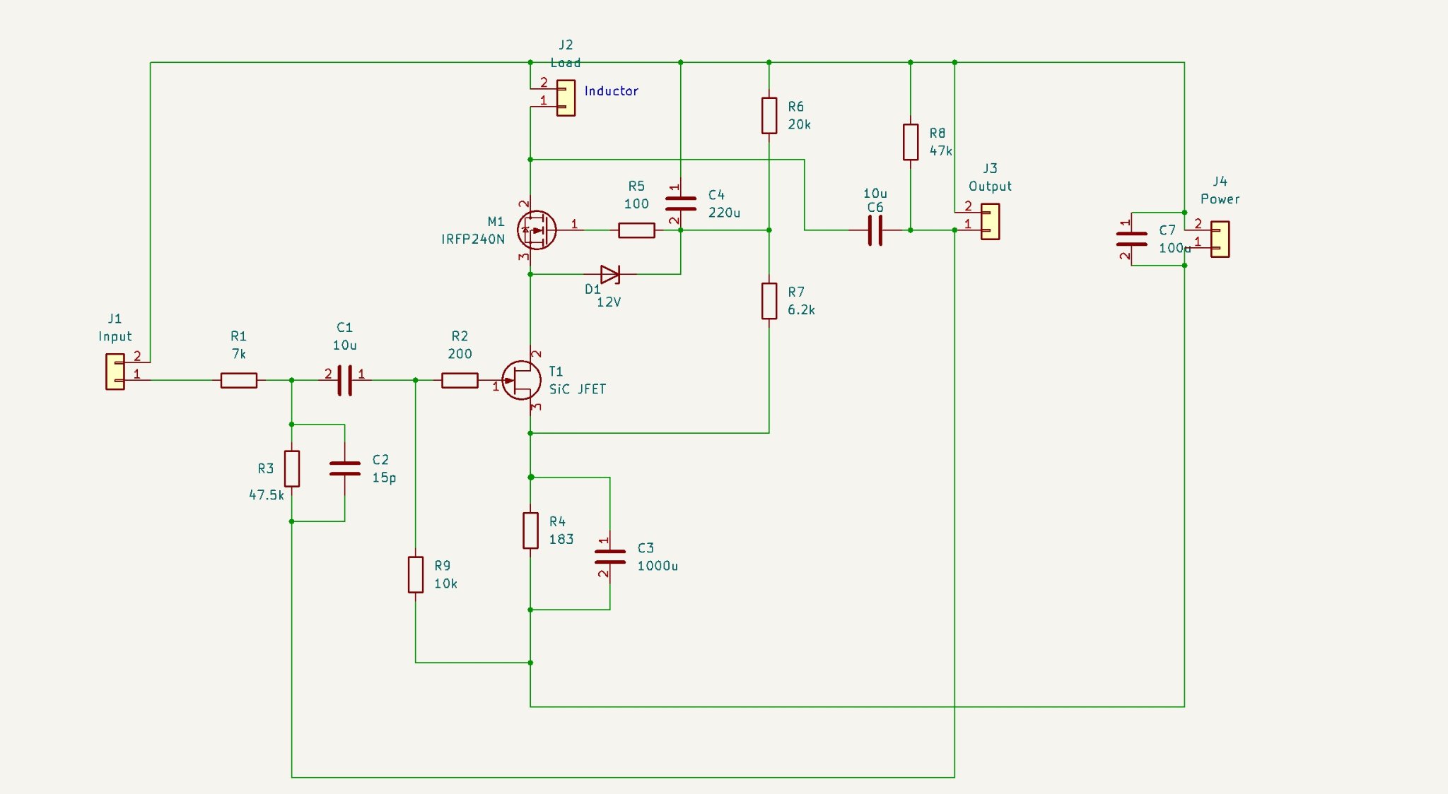

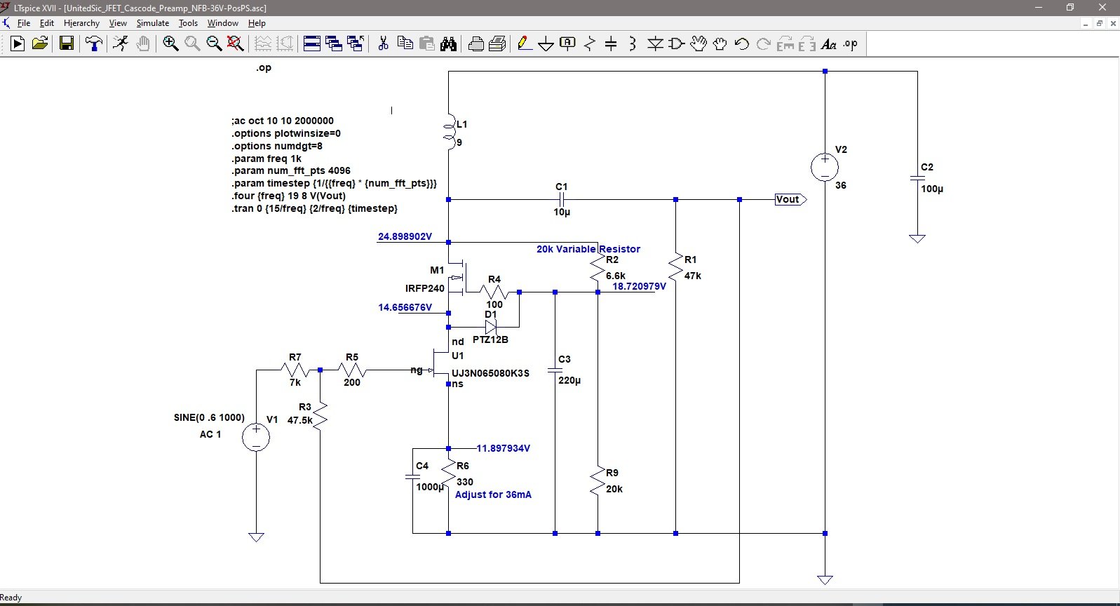

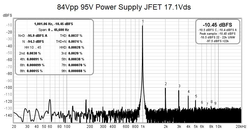

What would be the latest SIC jfet preamp schematic? What would be the lowest rail voltages for this to work ok? Hammond choke is used for better PSRR or I could use some tube HV regulator for that? Then what would be the max rail voltages?
Attached is the schematic of the preamp that I am using as the voltage amplifier for my 100 watt SIT follower amp. It uses a -95V power supply. I have powered it with up to 125V to 130V power supply. Larger output swings with lower distortion comes with the higher power supply.
To get an idea of how the circuit would behave with a lower supply voltage, I ran simulations with LTspice and I have achieved reasonable results with a 36V power supply. The distortion is a little higher and the maximum output voltage is limited to somewhere over 20Vpeak-peak (10Vpeak) before distortion starts to increase rapidly. Still, at 8Vpp out, the THD is 0.0025% and at 20Vpp out, THD is 0.018%. So, with some adjustments to the cascode voltages and current, a wide range of supply voltages can be used. A negative or positve power supply can be used with minor changes. From my previous experience, LTspice has provided results with this circuit that are reasonably accurate. Certainly, the circuit is worth testing out.
The choke is the load for the cascode amplifier circuit. I started using chokes several years ago when I was modifying my Luminaria Sony VFET preamp. That's when I discovered that, like for tube amps, choke loading has several advantages. These include low distortion due to the high load impedance (flatter load line), high gain, and low voltage drop. A resistor load would have higher distortion and voltage drop, while a solid state CCS requires a much higher power supply voltage.
Also for transistor gain stages, the output impedance is quite low so cheap chokes work well, unlike with tubes.
For the 36V power supply LTspice simulation, I used the Hammond 156G choke. This is a smaller, cheaper choke than what I am using for my voltage stage in my SIT amp, but it shows what can be done. Simulations show flat frequency response through the whole frequency spectrum.
The circuits that I've shown uses negative power supplies since I'm powering the voltage amp with the output stage power supply which is positive ground (negative voltage out). No separate supply required for the voltage amp. However, a positive power supply version only entail some small changes

Looks great. This is good for a SIT

  • Can you share the .asc. - I have the UJ3N065080K3S model, but attaching that to a jfet symbol does not work - so rather ask a reliable source.
@pinholer could you also please share the positive psu version? Is there a difference in performance between these two positive or negative psu? Do you have experience with another preamps that you could describe the sound from this SIC Jfet preamo? What would be the preamp consuption mA-s?
I have donut 2x16V and 1a. Maybe I can use this for that? For the negative psu I need quidence for that.
Could M1 be some other power mosfet?
Here is the LTspice model that I used

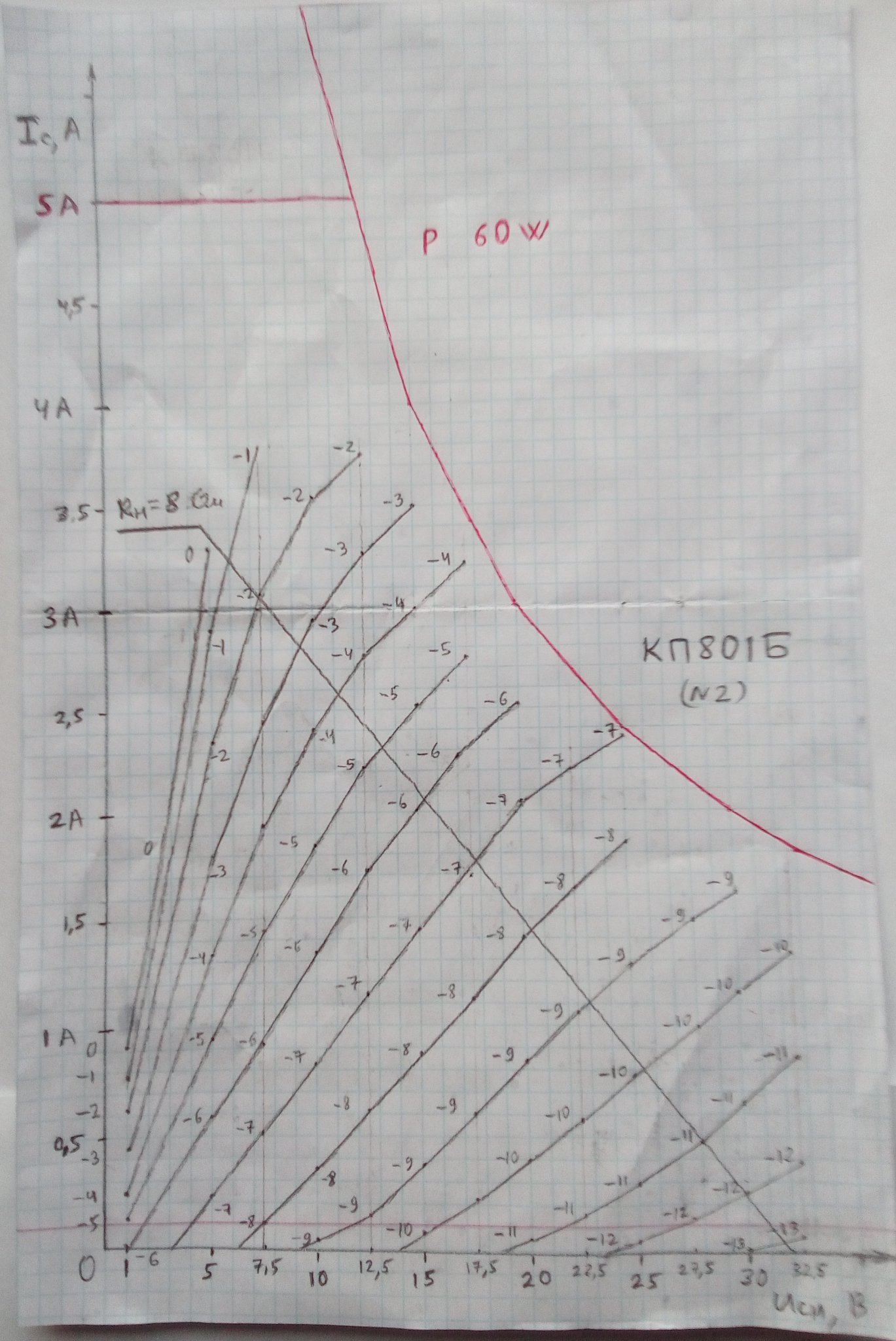

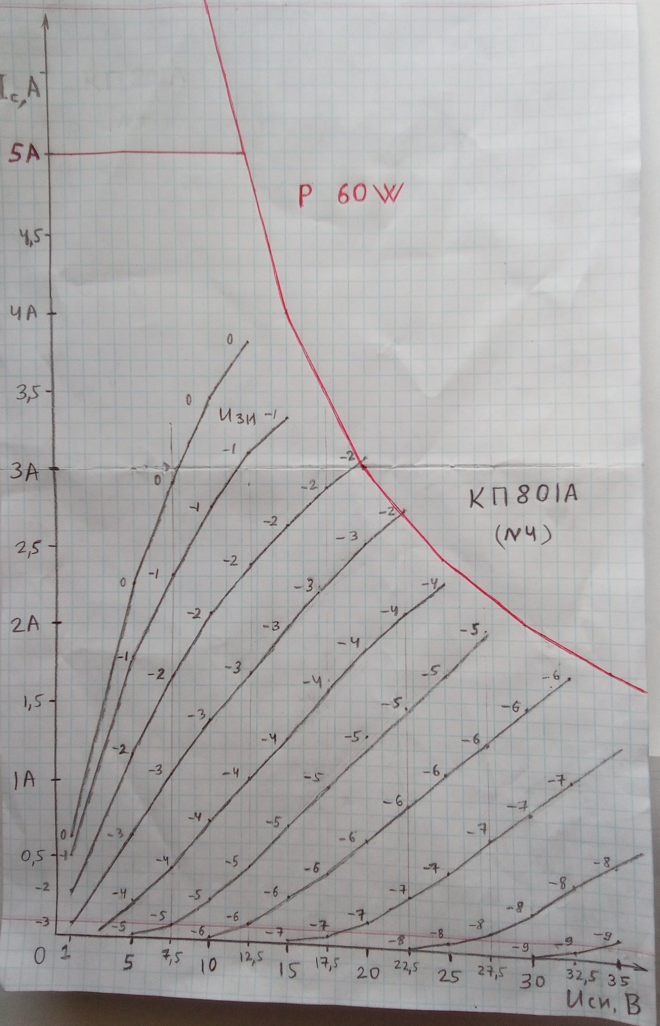

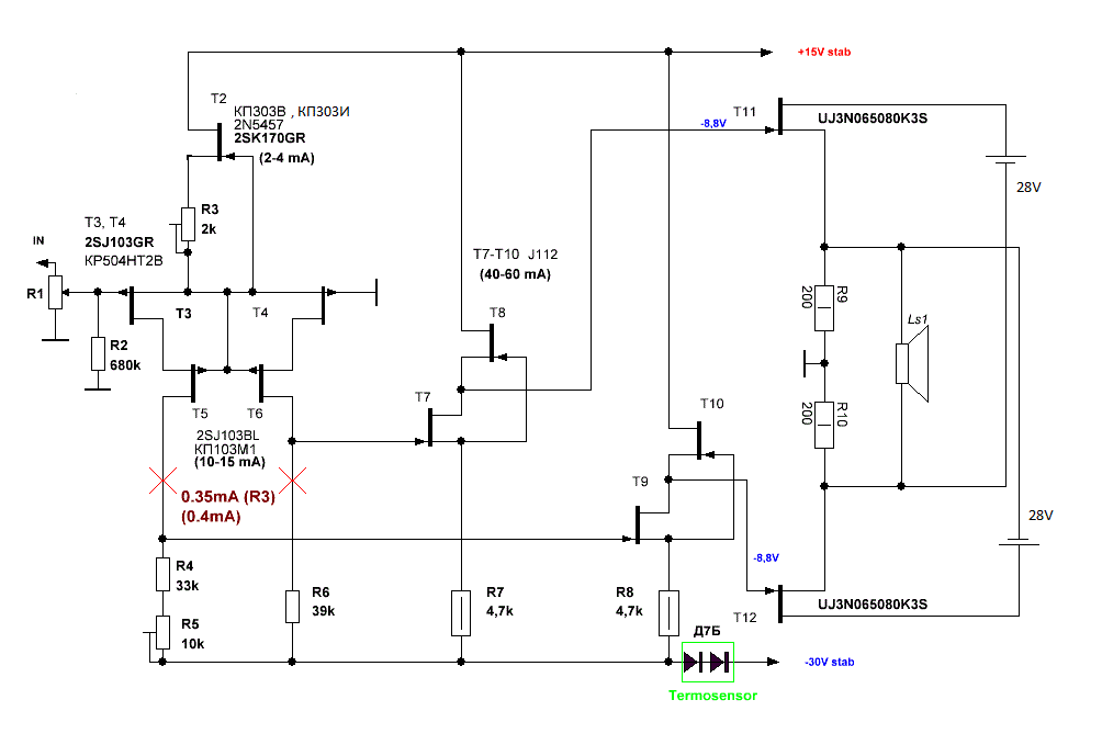

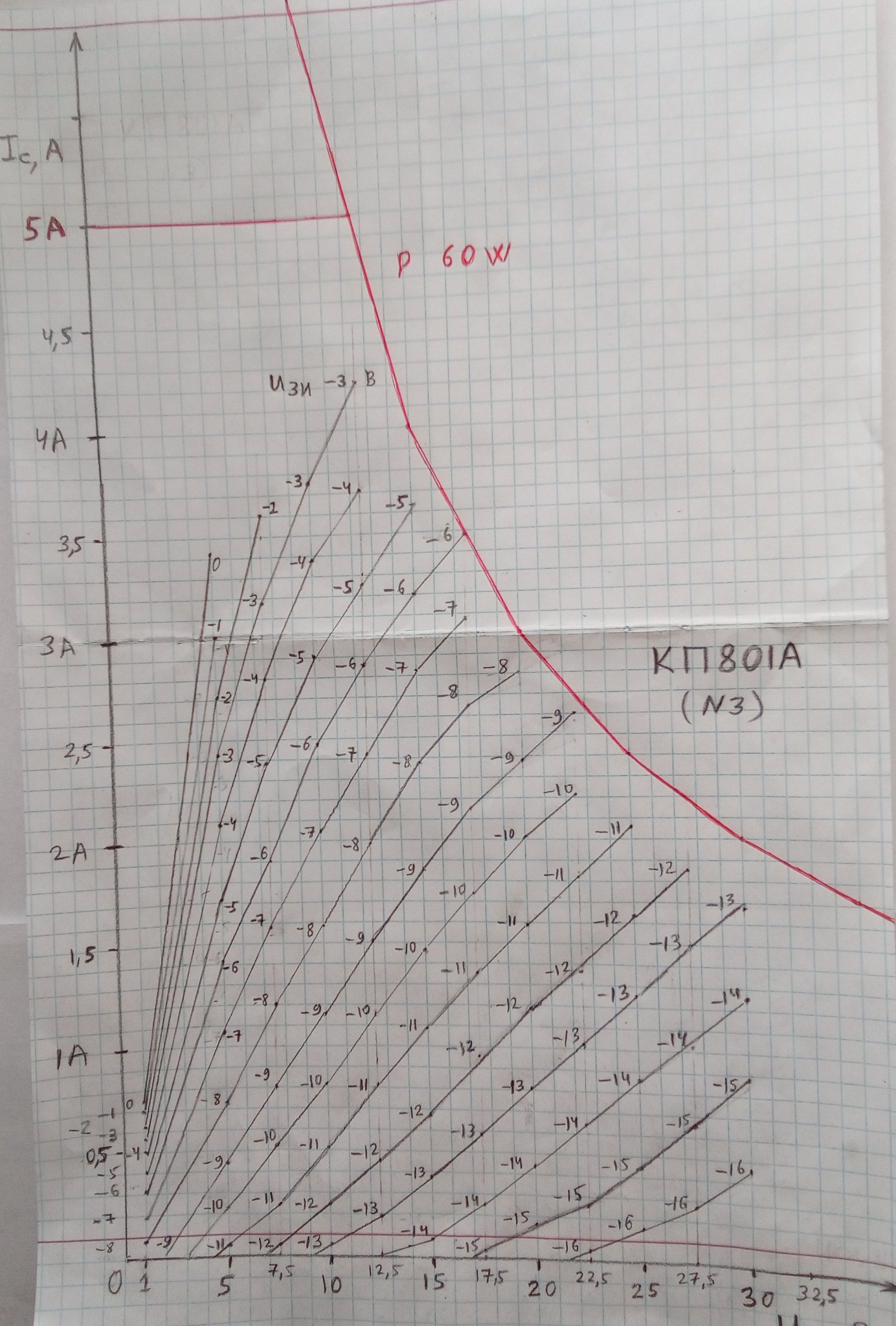

I’m also thinking about building an amplifier based on UJ3N065080K3S. I have two of them. Previously, I assembled a circlotron using SiC. But SiC requires thermal compensation; when heated, their current increases. Now I'm looking for a suitable SE circuit. I like your work with SiC.
I modified the circuit for a positive 36V power supply and made adjustments to the MOSFET biasing to match the negative power supply circuit values. This results in both circuits functioning identically. The current through the circuit is 36mA.
You can series the toroid secondaries to get 32VAC and after rectification and filtering, will probably get 42V to 45V DC output. I recommend CLC filter for efficiency. Your toroid can power this preamp with no problems.
As indicated on the schematics, M1 is an IRFP240 MOSFET.

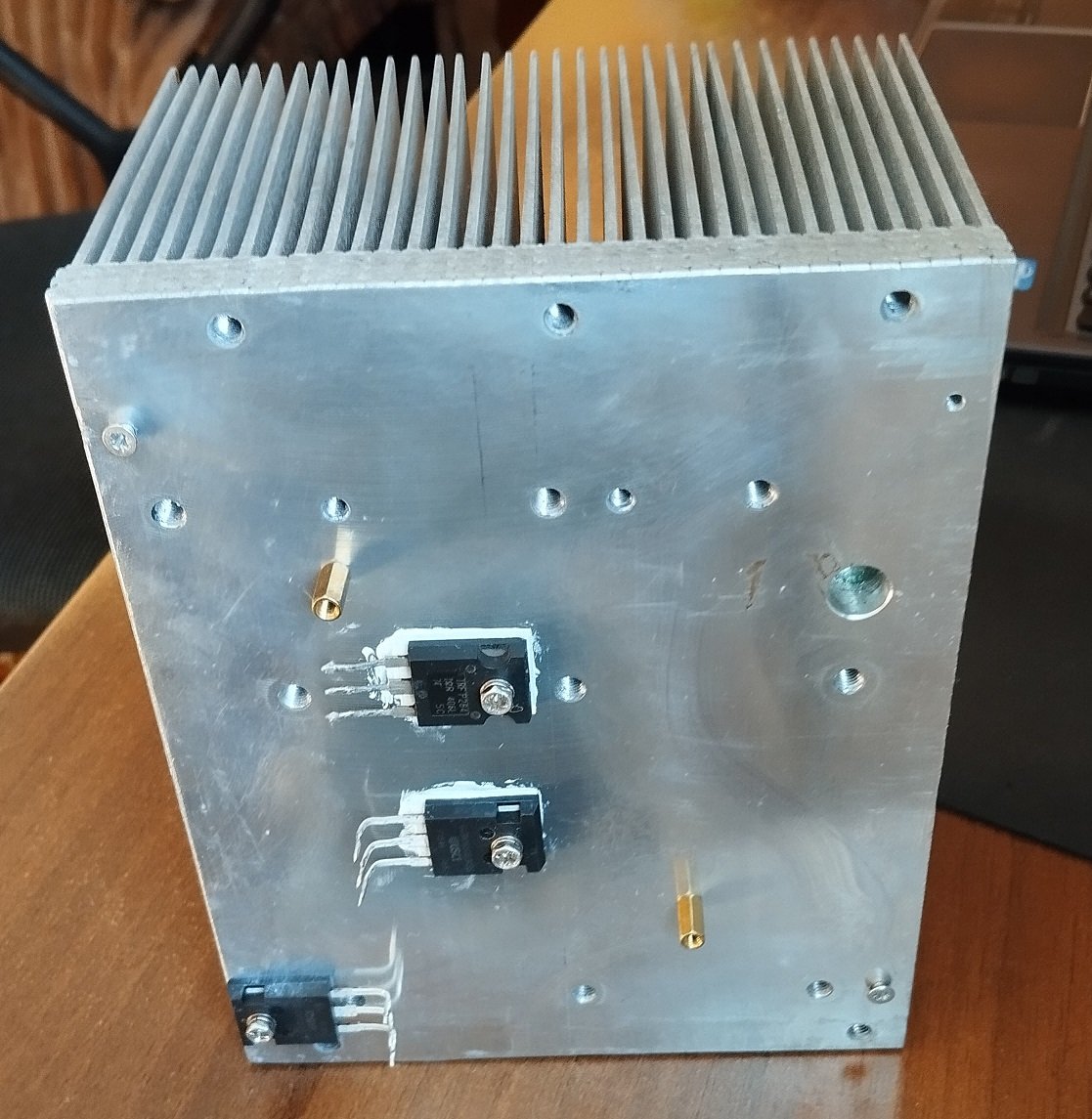

When I had my common source single-ended version of the amp prototyped, I listened to it for a period of time and I did not encounter any runaway current issues with temperature. However, it was source resistor biased so that would help prevent that problem.
I really liked that amp. It was simple and sounded good. The only downside was low gain, but that can be solved with a SiC preamp.

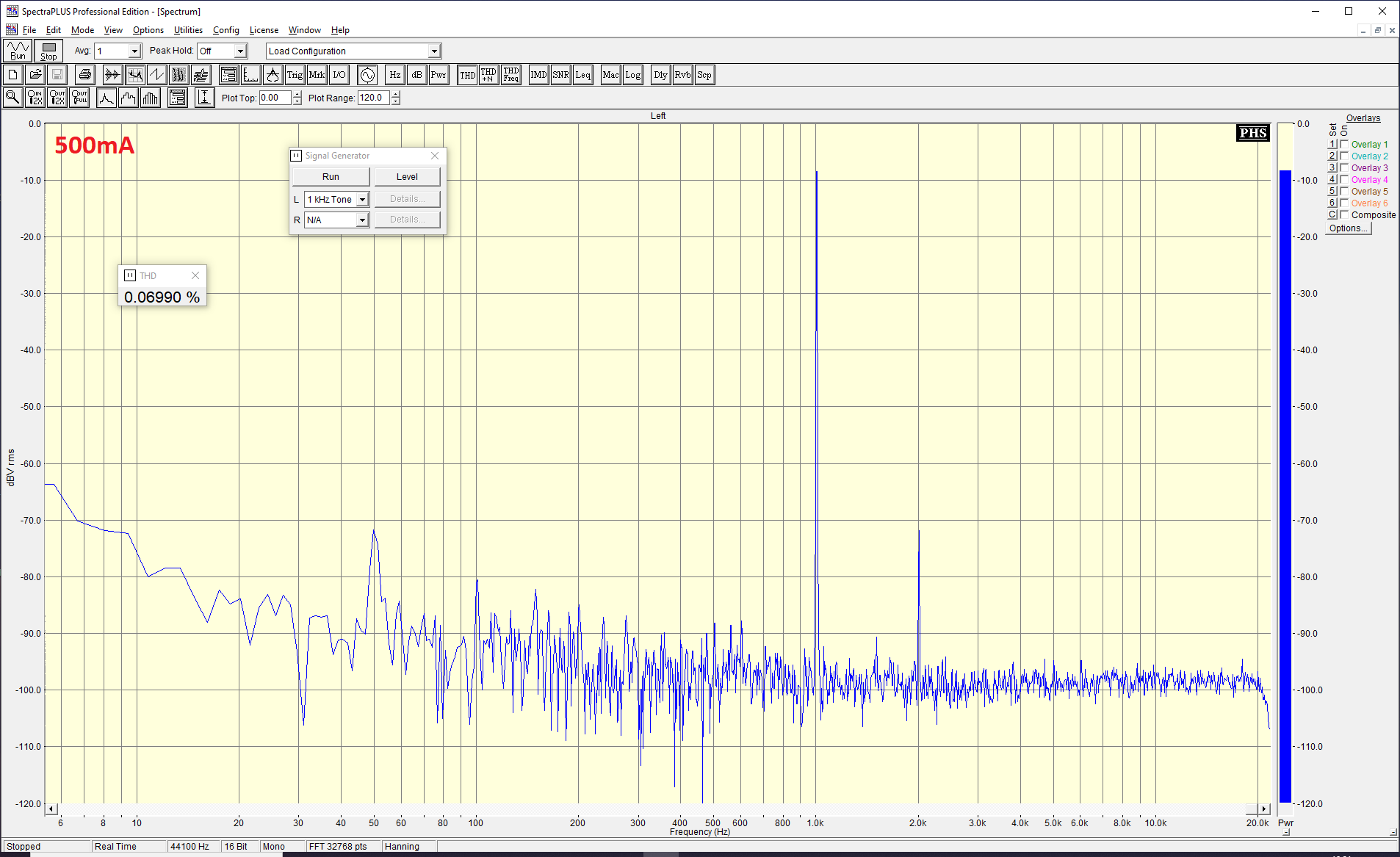

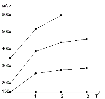

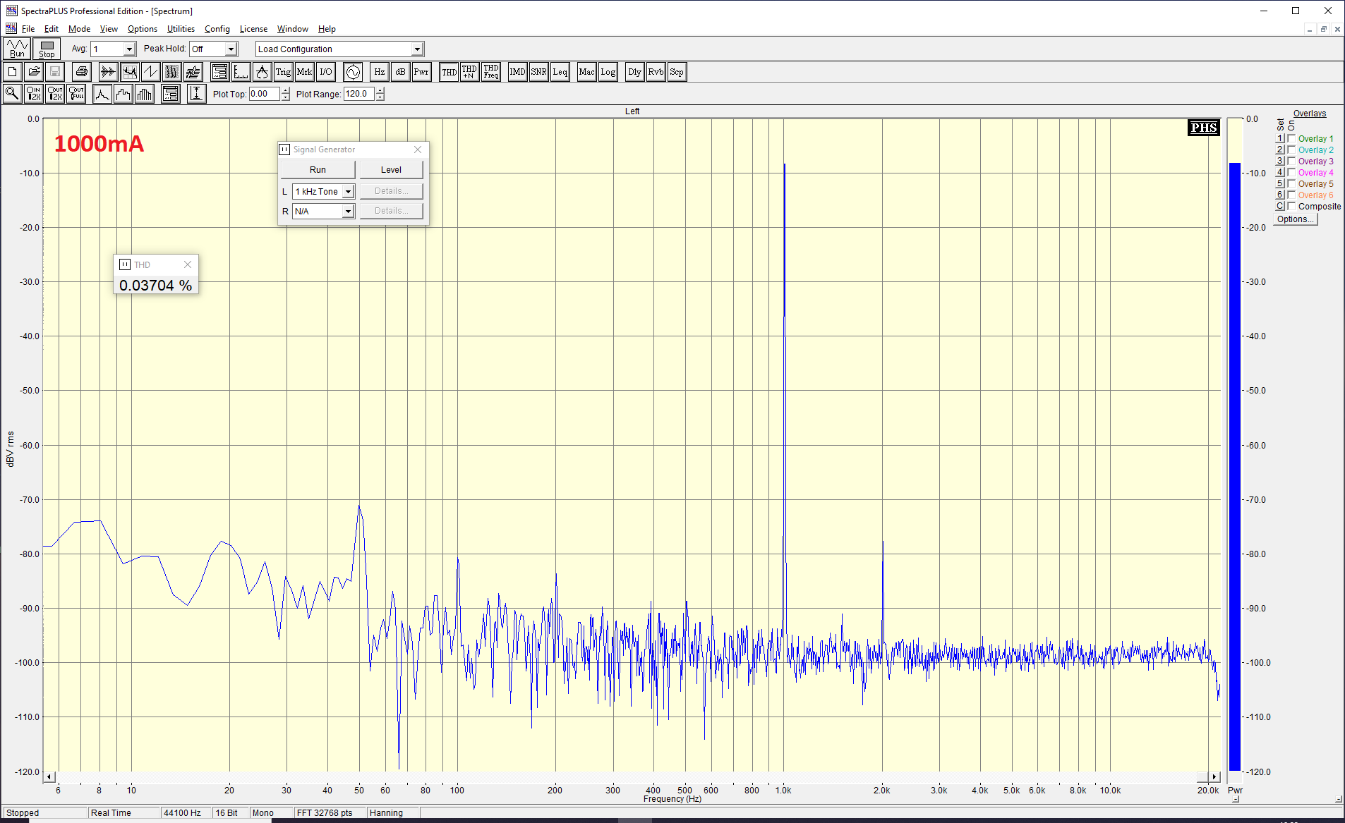

The dependence of the THD on the quiescent current. 1W/8R
Output transistors uj3n065080k3s.
Without thermal stabilization, the current rises slowly. When the cold amplifier is turned on at currents of 150 mA, 200 mA and 350 mA for three hours, an increase in the current is visible on the diagram.
If, when you turn on the amplifier with cold radiators, set the current to 150 mA, then the thermal sensor is not needed.
P.S. I would like to add that such parameters were obtained in the circlotron circuit without general feedback.
