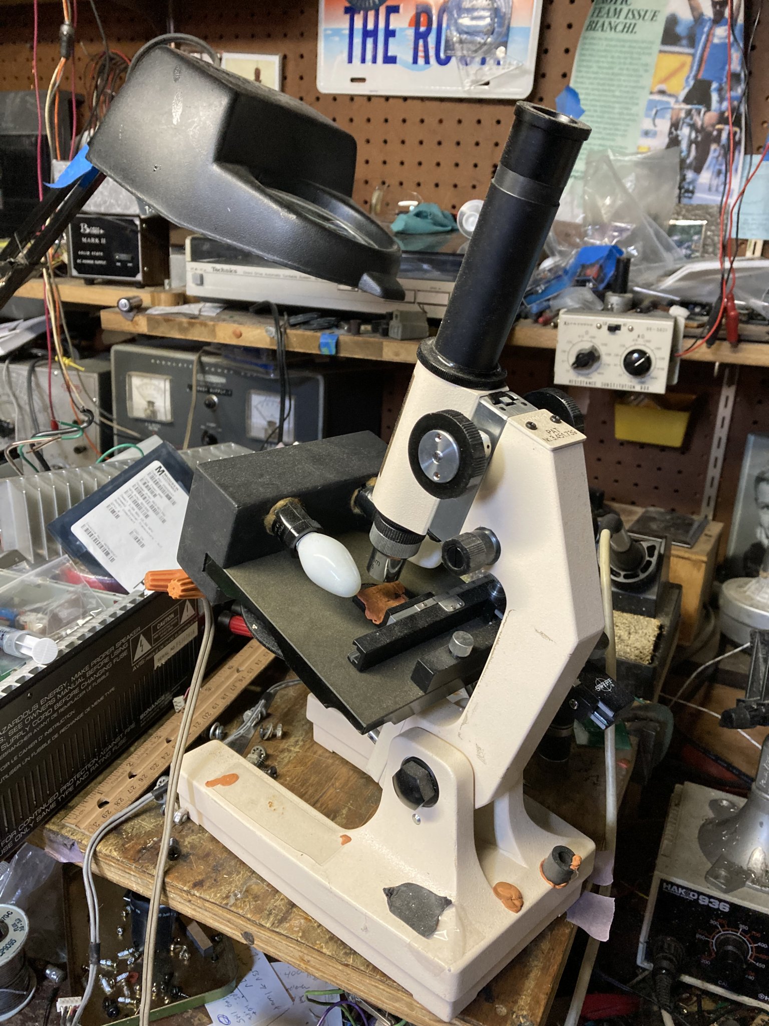

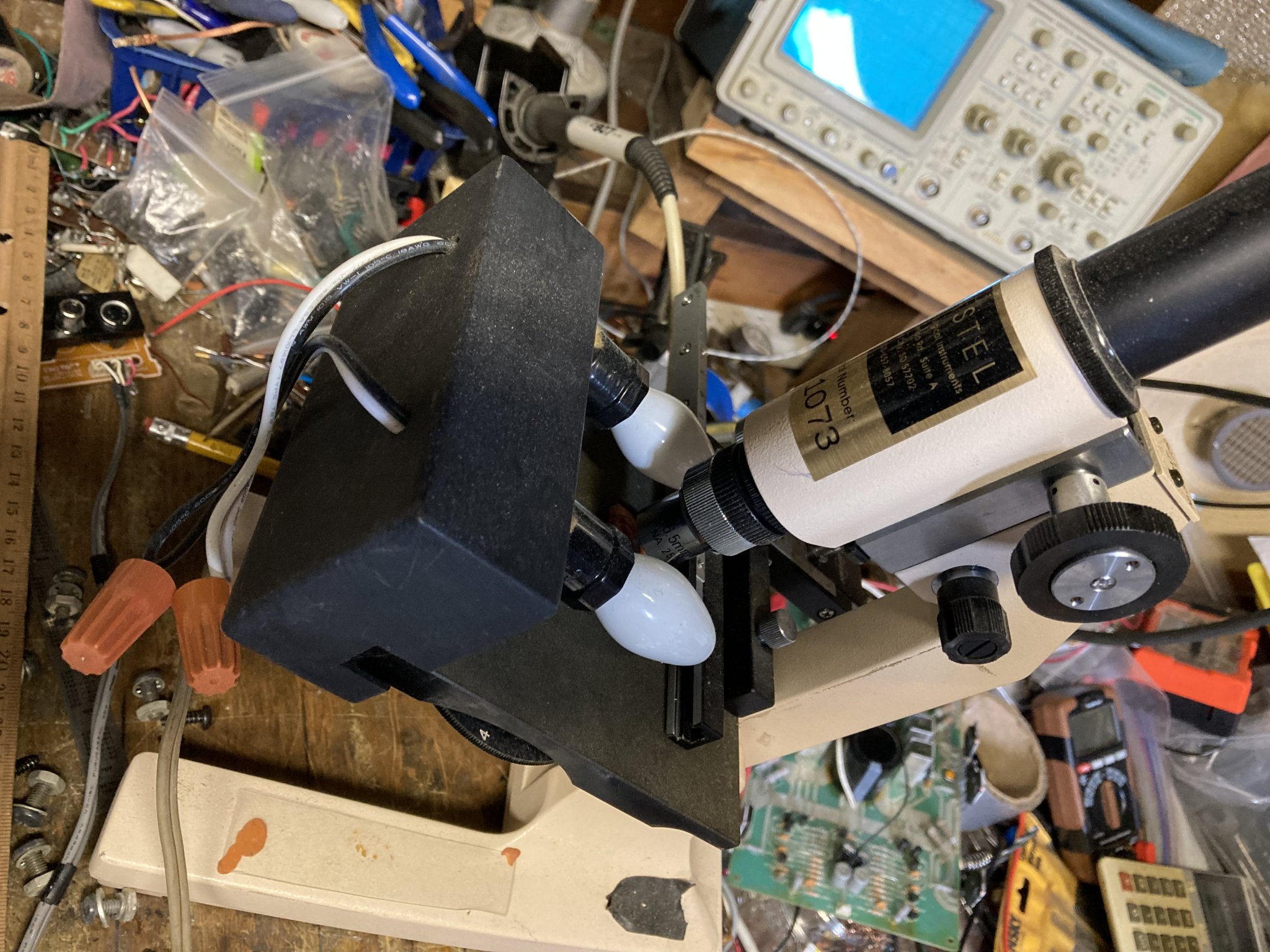

I made this from a generic Swift microscope with a mechanical stage (can't position stylus freehand), black spray-painted 2x4, and two night light bulbs/sockets. It's basically a clone of the SEK. What you need is the Shure manual with its photos of wear patterns (I found a copy on the web for free years ago). Search eBay under medical and lab equipment category.
Looks good. I'd been wondering about something similar but using a couple of super bright LEDs on goosenecks. I'm inspired to give it a go...
