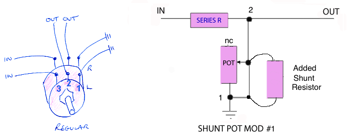

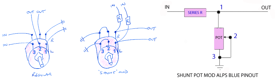

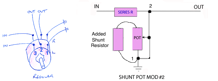

Richiesta di chiarimenti. Quale dei 3 disegni allegati è il modo giusto per farlo? Quello che voglio fare è usare:
1. Un resistore in serie da 12K
2. Un resistore aggiuntivo da 24K per convertire un log pot da 100K in uno da 19K
3. Un vaso di tronchi da 100K
Le opzioni sono:
1. mod blu alpi (ma con 24K aggiunti)
2. mod n. 1
3. mod#2
Proverò a costruire questi tre per vedere come funzionano, ma se qualcuno può indirizzarmi mi farebbe risparmiare tempo!
View attachment 1237960View attachment 1237961View attachment 1237962
Well, I built mod #1 and it works. I don't know how good the log scale is, but it seems in the general ballpark.
I would like to make the shunt with the potentiometer and resistor in parallel (24K ohm resistor) like Andy did with his mod.1. If the attached diagram is correct I should jumper pins 2 and 3 of the Alps and ground them and then put the 12k ohm resistor in series at the signal input on pin 1 and take the output from pin 1. I'm not clear where I should connect the parallel shunt resistor (24k): to terminals 2 and 3 or 1 and 3?

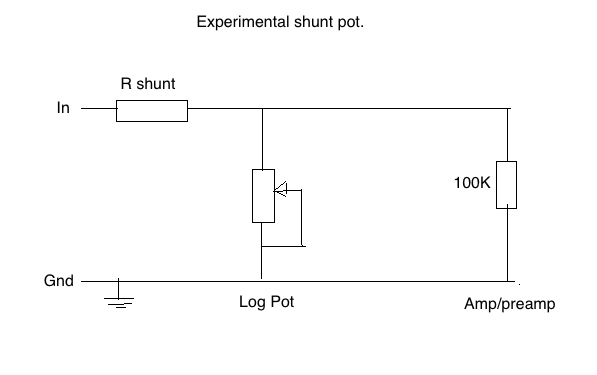

Good idea - drawing coming. I replaced the Holco shunt resistor with an 8.2K 10W wirewound Ayrton-Penny type and that sounded audibly better. In fact pretty good.
The 100K resistor on the input of the amp/preamp, a type 26 DHT stage feeding EL12n outputs, could benefit from being 470K for these experiments. I have the volume control and the various resistors in an external box for convenience.
Careful that you don't impose too stiff a load on the tube preamp, which will distort when loaded too much.
