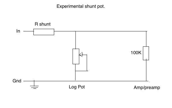

Good idea - drawing coming. I replaced the Holco shunt resistor with an 8.2K 10W wirewound Ayrton-Penny type and that sounded audibly better. In fact pretty good.

Ok, the series resistor should not be called R shunt, that's confusing.
It's the pot that is the shunt resistor.

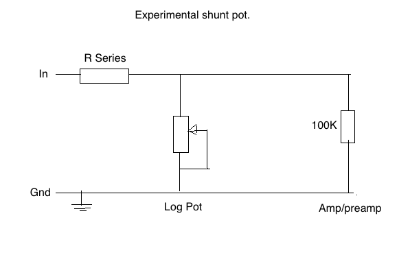

Thanks for that - drawing corrected, end of a long day experimenting.

I'm encouraged by the good sound of the wirewound series resistor. I've been listening to it and it's a big step up from the Holcos. I don't associate 10W wirewound resistors with shunt pots but they do sound nice. The Takmans seem to be all the rage with shunt pots.

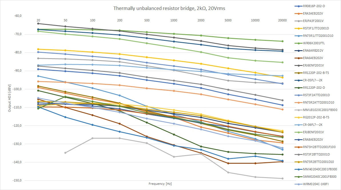

DACT and Goldpoint have both switched to using regular thick film surface mount resistors in their attenuators. Both sites attest to them.
I tried a thick film resistor as cathode resistor in filament bias several years ago and didn't like it at all. Haven't really considered them since. The SMD devices may be different but I'll never use them - everything I build is point to point. But thanks, that's an interesting observation.
If you want to use SMD resistors, dynamic parameters (for example distortion versus temperature) may varies a lot.
Some years ago one of your friend measured many SMD resistors:
https://audiodiyers.hu/viewtopic.php?f=80&t=1387&start=150 (sorry, only in Hungarian language)
Generally larger (0805,1206, MELF) and thin film are better than 0603 thick film.
MELF is interesting.
https://eu.mouser.com/ProductDetail/Vishay-Beyschlag/MMU01020C2001FB300?qs=YmMt7wOBEV4bSX0Ih7Km5Q==
Susumu and Panasonic also quite good.

Andy the Vishay Dale are non inductives Ni-Cro like MillsAndy best SQ Vishay Dale RN60-65

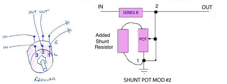

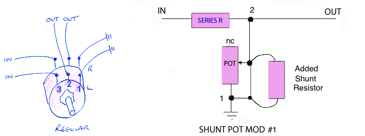

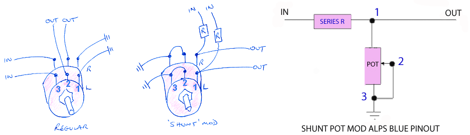

Request for clarification. Which of the 3 designs attached is the right way to do it? What I want to do is use:
1. A series resistor of 12K
2. An added resistor of 24K to convert a 100K log pot to a 19K one
3. A 100K log pot
Options are:
1. alps blue mod (but with an added 24K)
2. mod #1
3. mod#2
I'll try and build these three to see how they function, but if anybody can direct me it would save time!

Well, I built mod #1 and it works. I don't know how good the log scale is, but it seems in the general ballpark.
