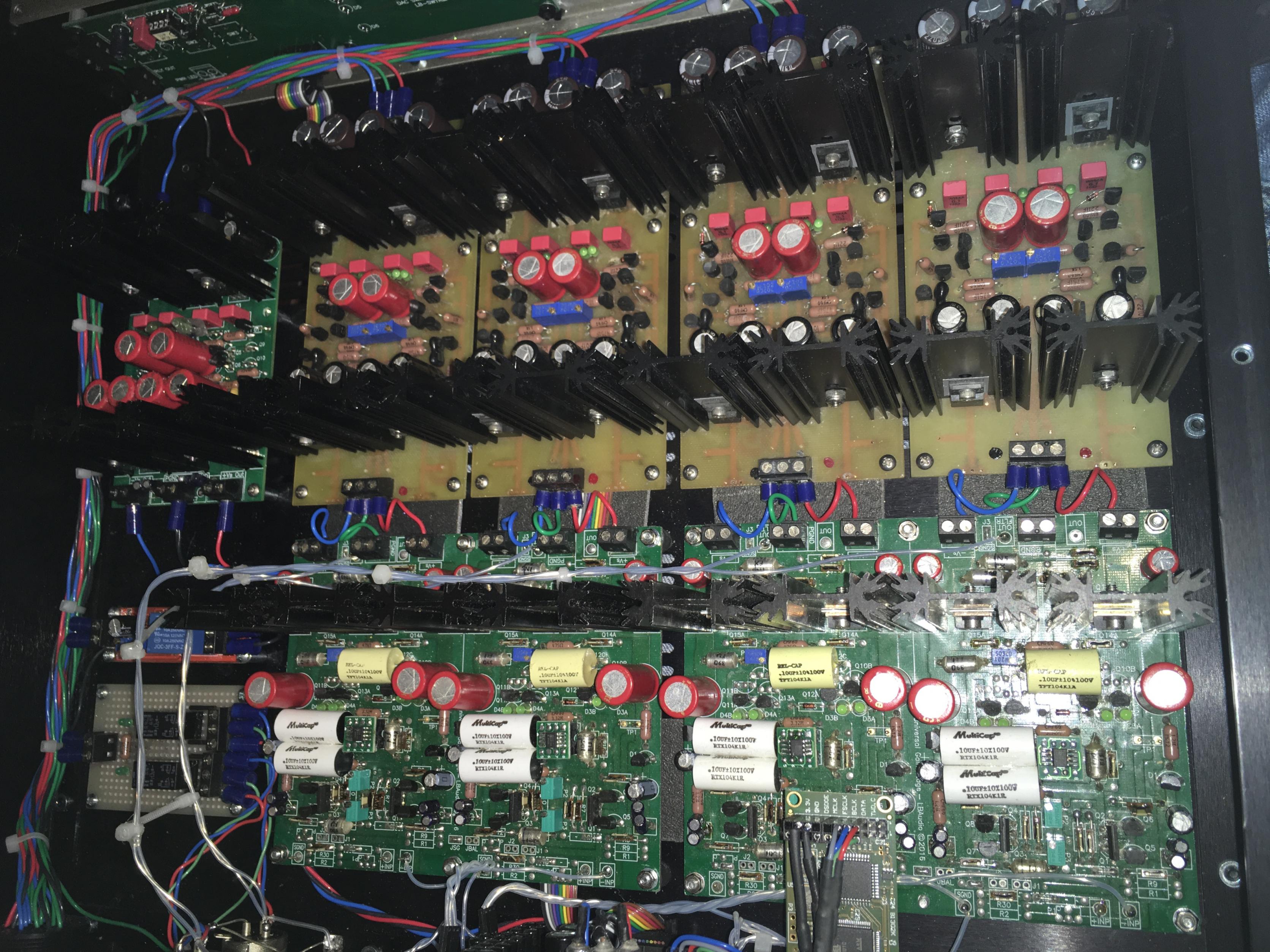

Shunt Regulator
Yes, no parts list - almost all the parts are discontinued, if you can find them then we’ll talk about the resistors
Input 2sk389/2sj109 or matched pair 2SK170BL /2SJ74BL
Cascodes 2SK246/2SJ103 nice if you match pairs , but not necessary
Drivers 2SK982/2SJ148
Power devices 2SK2013/2SJ313 or for high power 2SK 1529/2SJ 200 and 2SK1530/2SJ201
E102 current sources
LM329 for vref , you can make quieter
Maybe you can read the resistor values from the picture, maybe I have a list somewhere,
I changed LM329 Vref to LEDs
I can take more pictures so you can see all the resistors. There are 10 Borbely shunts in this balanced DAC , it uses Erno’s IV converters biased at 90 ma
Theres a 2 ma current source that got replaced with a 1.5 k resistor, but lafter I put in the original current souces and it worked OK

Considering both the EB-906/255 and EB-806/273 :
- the input positive and negative shunt currents, adjusted respectively by R1 and R2, will set the allowable positive and negative load currents
- the desired positive and negative output voltages are adjusted respectively by P1 and P2
All the rest will remain the same. Do you know the values?
Mother told us to say "please".
However looking at your post 14 it seems you are able to figure it out yourself,
isn't it ?
Post 18 : this is nice, all required values are there. For 24 V replace Zener D1
(D5) with Z11 or Z12, for 150 mA maximum R1 in the current source is 4 Ω.
So choose R1 smaller according to shunt and regulator supply current.
Bimo, what is C3 (C17) good for ? Please explain.
