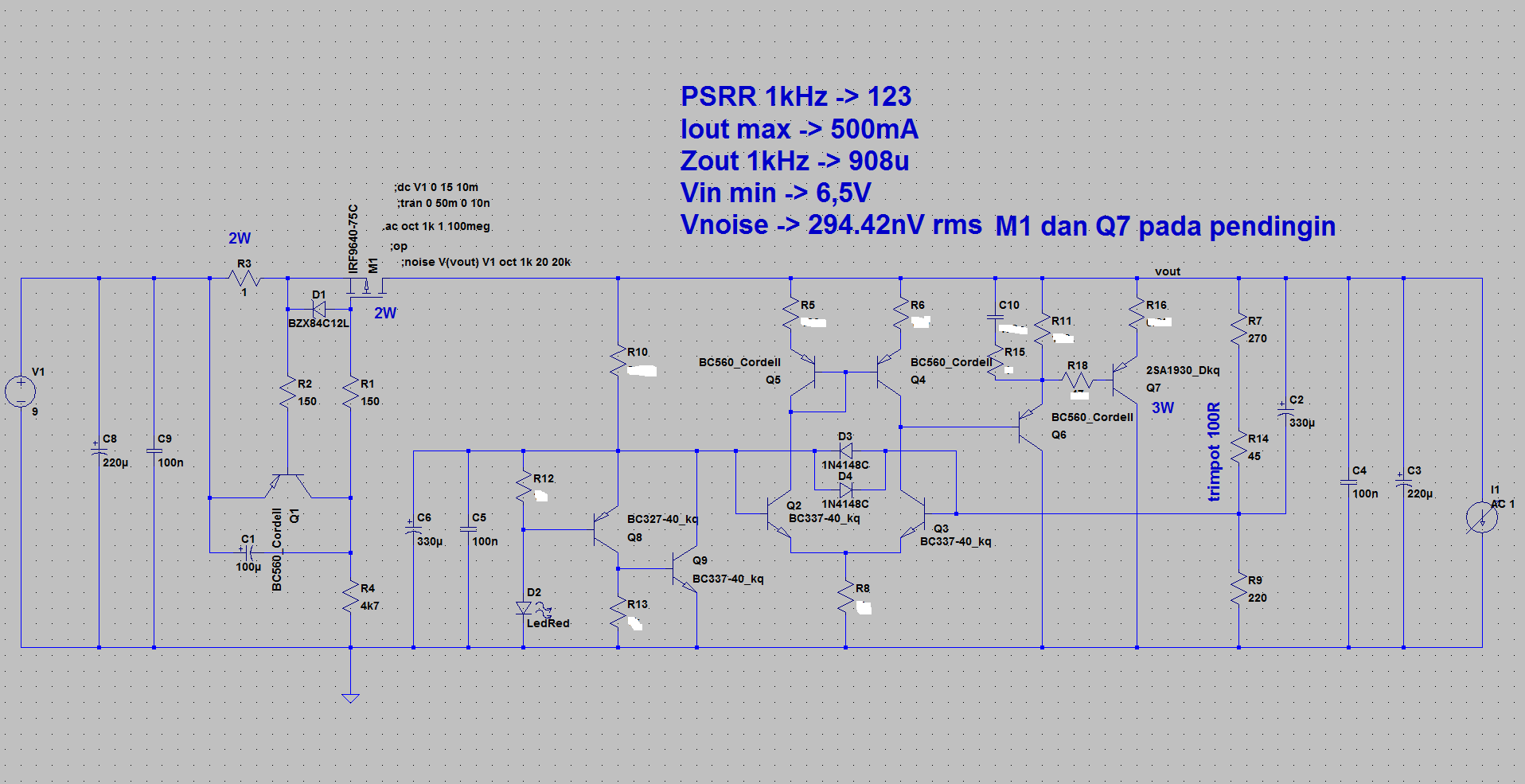

Bimo, what is C3 (C17) good for ? Please explain.
C3/C17 for improve PSRR of the constant current source.
Did you draw this schematic ?
Did You ask me?
I design the schematic, sim it with LTSpice. My friend made pcb layout. We share it at local audio community.
It is similar to that of Borbely it seems.

Yes it is. But I use BJT, instead of JFET. I do not know the value of resistors and capacitors in Borbely version. In simulation it worked. It have good PSRR, low noise, good transient response, etc.

Are they original Borbely values? I know that Borbely series regulators driver resistors are 33pf. Where did you get 220pf?
I need to look to be sure, its been a while since I built them. But 99% sure its 220 pf. I got the first kits directly from Erno.
Yes it was 33pf on the Millennium 200 amplifier's series regulator. (this cap isn't on the pc board or parts list, but it was a later note I got from Les Bordleon who bought the license to continue some of Erno's designs.

I suggest to try bipolar outputs also. It may need re-arrangement of the drive.
I did it in 5V shunt regulator, but I do not share it. The constant current source still use mosfet. It tested.

The Jung Gled uses Zetex transistor with very low rbb for low noise, BC 237 and BC 337 are not as low. the current mirror in Bimo’s shunt is interesting
