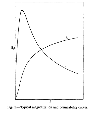

Permeability is a tool value, not a ultimate parameter to reach for. You need low permeability in some SE transformers to avoid core saturation from Idc. I thought this would be basic knowledge to understand. If you start with a higher core permeability than needed for your SE application, you'lll need to airgap it anyway. A permeability of 440 is pretty fine for achieving 35H on a hypothetical transformer with 4000 primary turns, which is pretty fine for a 2A3 output transformer.
How do you come to the conclusion that low permeability alone results in low bass perception?
https://www.mennovanderveen.nl/images/onderzoek-ontwikkeling/publicaties/download_1.pdf
According to Menno van der Veen, cores for SE OPT's should have high permeability.
His AES lecture is about the behavior of the output transformer at SPL's at the treshold of our hearing, and his conclusion is that high permeability cores have enough permeability "left" in SE applications (airgapping) to have crucial benefits.
He compares a GOSS core with socalled annealed VM111 lams, and his conclusions confirm the advantage of using higher permeability cores.
This also happens to be my experience (just a pity that at the time, 2007, Menno apparently did not have access to higher permeability cores).
Nanocrystalline cores represent the SOTA wrt permeability for OPT application.
Avoiding core saturation from Idc is an other subject.

Small signal means 1 mW not 1W.No that is not true...
IF somehow magicaly it is true then the amplifier will have dramaticaly different transfer in the low end with 1W and 10W power...
BUT IT IS NOT THE CASE
You can easily prove to yourself by measure the device with small signal input and large one.

If I have 26H for 1 mW and 34H for 1W, the frequency response with 300B will be 3 dB down at 4Hz and 3Hz, respectively. L will keep increasing but not as much until max Pout.

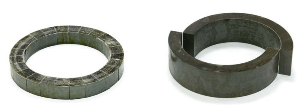

Because he is using toroidals with fancier material. For the same material, usually toroidals have higher permeability than C cores and loose laminations.https://www.mennovanderveen.nl/images/onderzoek-ontwikkeling/publicaties/download_1.pdf
Then if you want to use a large core with tiny gap and want small core loss at the same time need to use fancy materials.

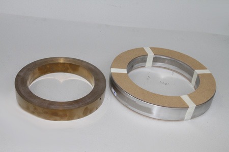

Funny that you continue to talk about "fancy" core material; amorphous and nanocrystalline cores are quite normal today. Tamura has amorphous core transformers; Monolith Magnetics has HiB GOSS, amorphous and nanocrystalline transformers. And Lundahl as already mentioned. Actually you can call EI M6 "prehistoric" when discussing quality transformers, good for 'middle-of-the-road" transformers but not for the best quality.

Guys, don't forget, we are talking about SE OPT which is per say biased with the DC, so even with the small signal, the core is in the middle of the magnetization curve. Correct me if I am wrong.
Taking into account size and output power, they are GOSS. May be M3 may be M4. May be 0.35mm, may be 0.27. After all it doesn't matter much. Winding layout design is what matters most. Air-gapping toroidal cores is not a big problem for today.In the past on several occasions I tried to have a conversation with Menno on core materials but he has always been very reluctant to exchange ideas (not so with Per Lundahl; discussing with Per has always been a joy, and now he also has some amorphous and nanocrystalline stuff).
I am pretty sure Menno's toroidals are 0.35 mm stock quality; how airgapping is applied for the SE OPT's I don't know.

Is there anyone who has experience with modern core materials as nano, amorphous and such? Any different technics in windings using those cores?
