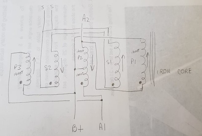

You will see that the basic windup looks simple :- primary consists of 2 complete primaries I'll call them P1 and P2, secondary is similar I'll call them S1 and S2 - windup is:- 1/2 P1 - S1 - P2 - S2 - 1/2 P1, the direction of the windings P1 and S1 are the ones in dispute, the final connections will depend on the direction of the windings, ie if all windings are in the same direction then paralleled windings will connect start to start and end to end, and if P1 and S1 are wound in reverse then they are connected start to end and end to start, as long as they are connected correctly the transformer will work, if they are connected incorrectly the windings will cancel each other out.
How does the direction of the windings affect the final result ? this I don't know, probably the only way to find out is to make one of each and compare in a real world situation in an amp. I believe P1 and S1 are wound in the opposite direction to P2 and S2 - in this case wind would be 1/2P1 - S1- reverse the spindle direction - wind P2, wind S2 - reverse the spindle direction - wind 1/2P1, this is how I've done it.

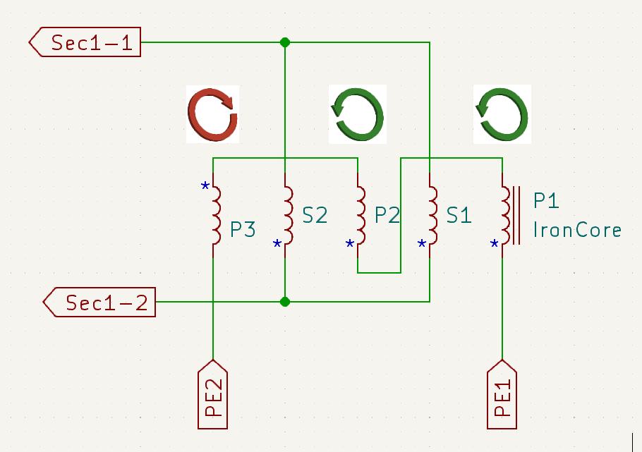

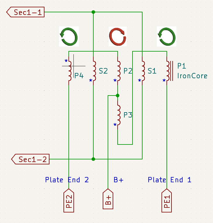

@50AE, did you mean this kind of winding arrangement?

I don't think that is how I connected the windings, I'm 99% sure my diagram is correct, it can be confusing - the dot indicates the winding start and the arrow indicates the winding direction - I have left out the ultra linear taps as they only confuse the diagram further.

In conditions this is a SE transformer, PE1 represents the anode end, PE2 represents B+ end, and the outer B+ layer is reverse wound so that B+ end is closest to the secondary, then yes, this is correct and will give you a free lunch of P\S capacitance reduction.
OK, thanks. Applying same logic PP transformer B+ layer (usually in the mid) should be reverse wound? Outermost layers of primary must be 1/2 of inner ones, so I have drawn this explicitly.
You could that, yes, however in this case, by doing that within a mid package shifts this capacitance into the primary region. This is not necessarily a bad thing, where within most OPTs there is plenty of headroom to dump P\S capacitance into P-P capacitance. I find it useful to balance Cp and Cs, which can bring a very even frequency response despite variation of driving resistance. I usually aim, for 1:1 Cp to Cs ratio.
As for the outer primary packages of the interleaving there will be increased voltage potential difference, where the capacitance path is bottom outer 1/2 primary -> core (floating) -> top outer 1/2 primary . But for most OPTs we can assume a thick bobbin with air in between and not a core touching full filling factor, so high distance and low epsilon take care of this.

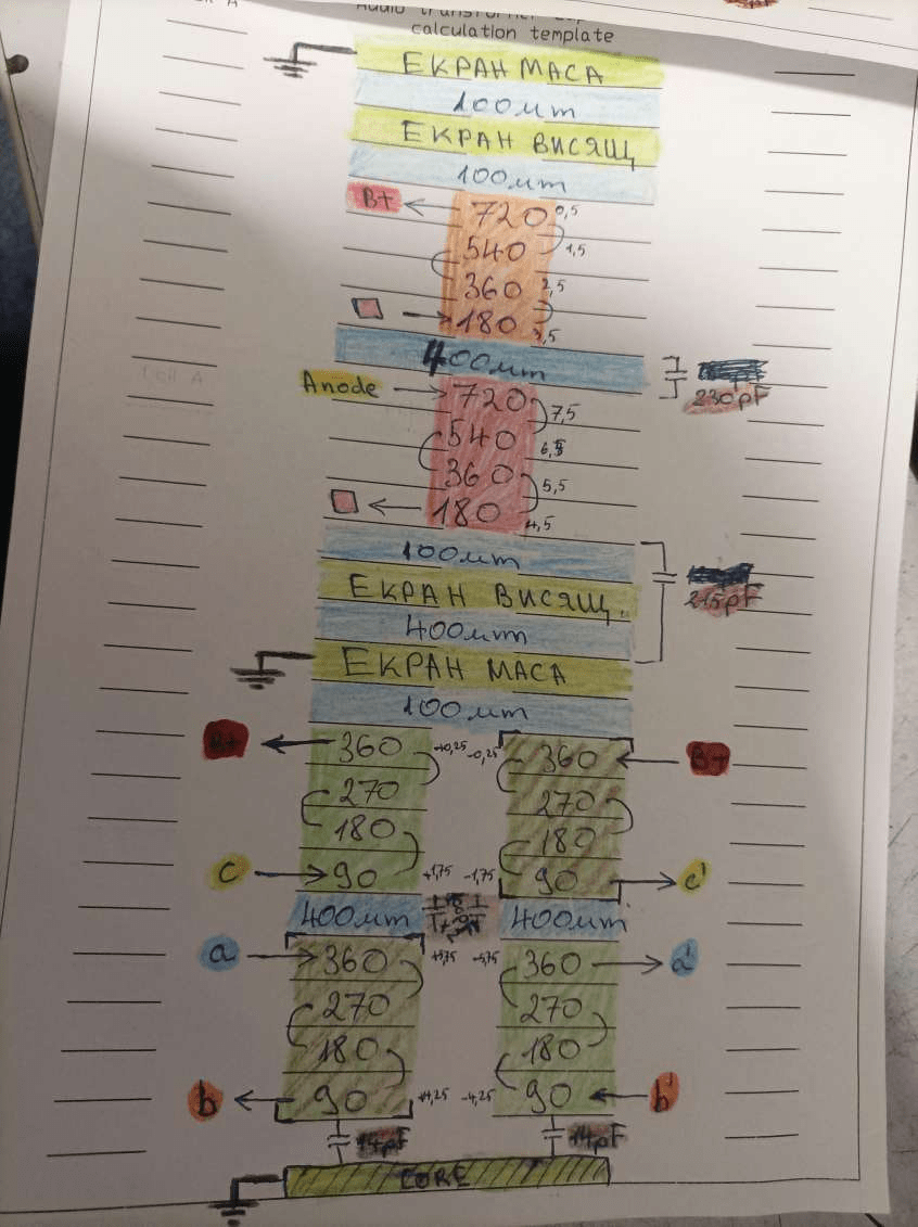

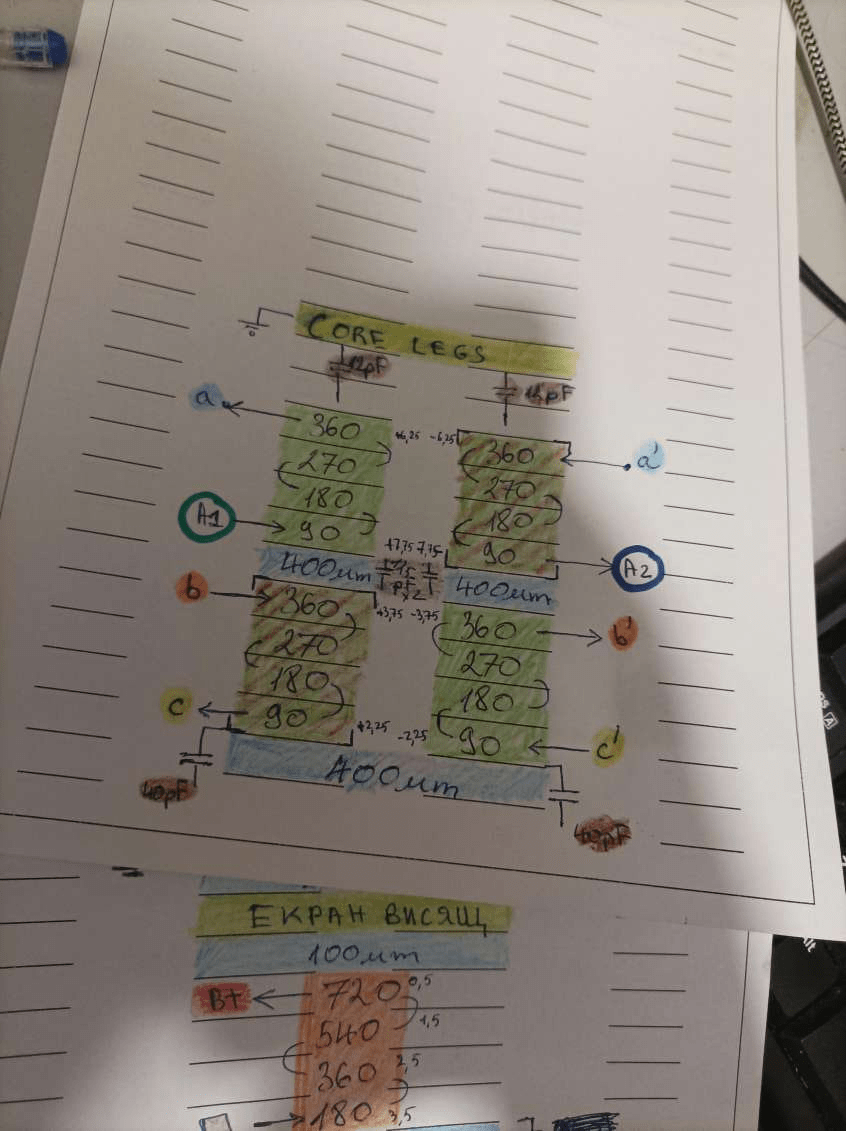

Probably my 40th or 50th sketch of designing a SE - PP 1 : 1+1 phase splitting transformer with the aim of delivering perfect amplitude balance between both halves over the whole frequency response range. All capacitances and leakage inductances have been balanced, including the primary shunt capacitance, where disbalance there will also affect the secondaries. This design is single-bobbin, although I also have double-bobbin designs, however with a different interleaving approach and different screening techniques.
Core grounding is also important, as floating core at specific potential will also affect secondary disbalance. In this case, there is double electrostatic screen. First screens are only floating and average the voltage gradient of the primary layer. Then secondary grounded screens balances the capacitances between the secondary packages, illustrated in green. The packages in brown-green are reverse-wound secondaries. The primaries are depicted in red and orange, where the red package is also reverse wound to shift capacitance towards the primary region. The secondaries are vertically split.
If this design turns out successful, I'll share it to the forum as contribution. For now it is just a teaser.
Always a pleasure to read from individuals with so much knowledge who also wish to share it. The truth is that I have never faced such a challenging task, neither with output transformers nor with phase-shifting interstages. I can't remember the number of transformers discarded because they didn't meet the design requirements.
We seek quality within certain parameters. This has no limits: the eternal battle between leakage inductance, capacitance, primary inductance, and efficiency. Achieving perfection in all these parameters is practically impossible unless weight or space are also infinite
When we perform calculations for leakage inductance and capacitance, and assess how these parameters impact the high-frequency band, we quickly see that capacitance is much more concerning. Typically, leakage inductance tends to roll off well above 150 kHz.
Apart from everything mentioned earlier, considerations such as adding gap between each layer and determining the minimum space between the primary and secondary windings are important. It's beneficial to wind the primary, especially in the upper layers, with a much larger surface area in the same direction. Take a look at the photo on this website; you can see how capacitance decreases significantly. This approach has yielded good results for me in transformers with heavy loads, such as those designed for the 211.

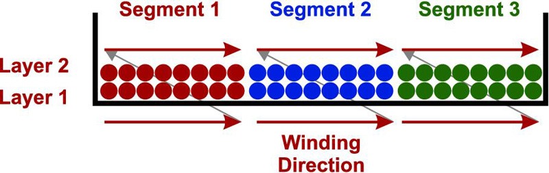

As for vertical sectioning, in literally 98% cases of audio transformer design, I find little practical use. Yes, it does split self-primary capacitance of the layer, however:
1. In case it is sandwiched between two low-impedance secondary layers from both sides, you lose the benefit - from a square reduction of capacitance vs sections to 0.7 vs 1. (From small recollection, I believe 0.7 was the lower achievable capacitance reduction factor of a sandwiched vertically sectioned primary (Crowhurst))?
2. In most OPTs, self primary capacitance is already low, due to the high layer count (low voltage gradient) and high amount of series connections of the primary.
3. Your biggest offender is the P/S capacitance, especially at anode layers.
4. Vertical sectioning is valuable for air-core chokes. In ferromagnetic chokes, vertical sectioning "benefits" get shunted by the core. There is an optimum amount of vertical sectioning, where an extend beyond that increases capacitance instead of decreasing it. It is also depicted in transformer literature.
5. It is also valuable for kV applications, where you would require an ample amount of insulation between and low voltage gradient between layer ends.

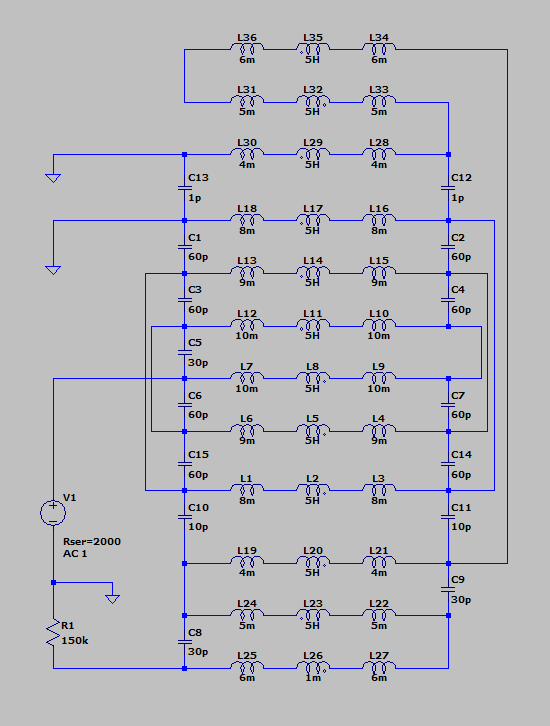

Here's one of my modelling attempts on LTSpice. It depicts a transformer with a 1:1 ratio, S-P-S configuration, with 6 secondary and 6 primary layers. The purpose of the model is experimentation and observation, how different Ls, Cp and Cs values interact. The main drawback with modelling is, you have to be aware, theoretically of all Ls, Cp and Cs beforehand, of their values and placements, before sketching the model. Note that additional primary to primary leakage inductance resonant tanks are not added to this model.
As you can see :

you only can change d ( separation distance between the plates ) x nº layers but if reduce the layers the Leakage inductance grow up
Once you calculate the desired leakage inductance, only the distance 'd' remains.. always is a balance of everything, sure maybe there are more ways to optimize.

Yes, this is one part of solving the problem, calculating the static capacitance. However in transformer, you have effective capacitances, which are the result of static capacitance multiplied by capacitance factor.

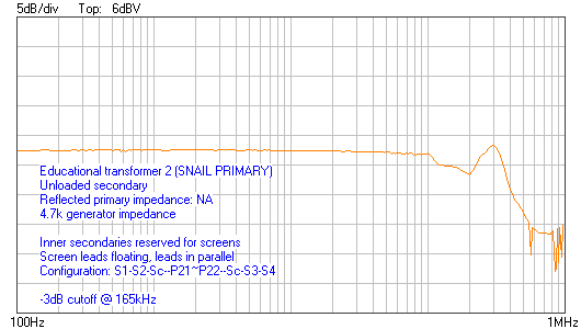

You can take the interleaving to a further step, however at the expense of winding complexity. Like this.
P6, P5, P4 // Secondary // P8, P10, P12, P11, P9, P7 // Secondary // P1, P2, P3.
In this scenario, you'll be winding the inner primary region into a snail-like progression, where the Anode layers start at the middle, then progress outwards, towards the secondary layers from both sides.
That will increase primary package capacitance by 4 times compared to normal winding. Considering however there is plenty of headroom into the primary region, one could safely do it for most cases.

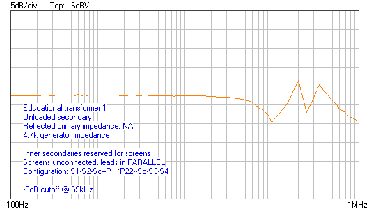

In this frequency response comparison, you can observe the power of capacitance dump. In this case, a S-P-S interleaving with ~70mH primary to secondary Ls. The first example features a Panode to PB+ standard winding progression. The second example has an internal Anode layer with a snailshell-like progression towards the secondary. The transformers were built for experimentation and demonstration purposes. We experience an increase of 4 times into the primary region, from 104pF to 416pF. However the P/S capacitance has decreased from 410pF to 2,52 pF. You can see that primary capacitance alone is much less harmful than P/S capacitance, especially in this case, where secondaries are connected in series.
Reactions: neodymium
