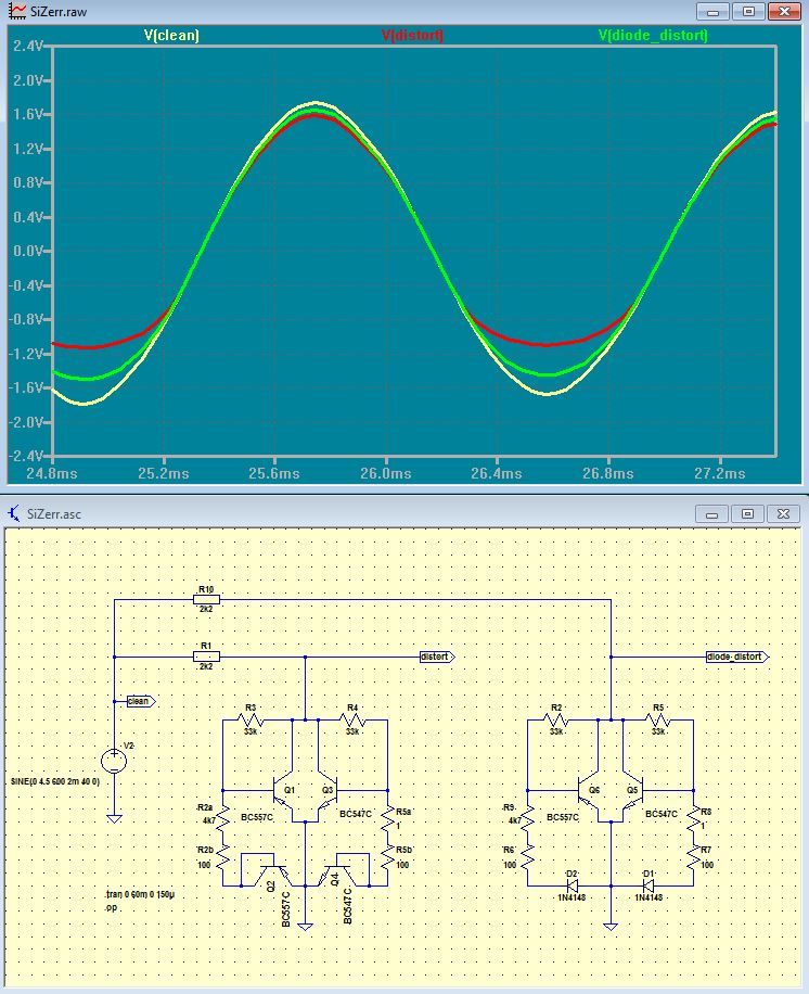

some years ago I found this circuit on the net.
never tried it
I know little of how to use LTspice but I did figure out how to replace parts (badly). But I took the above circuit and tried to simplify it. Sorry about the picture rather than the run file, don't know how to attach a file either, not doing too good am I? I got it to limit each half cycle to 0.8V, 2.2k gives about 0.9V. Should be enough to drive a Class D module. Didn't want to post a big picture, turns into the decaying sine wave as the signal decreases.
@ printer2
with the diodes in the right direction you will see a similar result.
Output level is just a little bit lower.

According to the schematic you showed the low pass is after the feedback loop, not inside.All charm of this circuit is its principle: when distorted signal is filtered through low pass filter and returned to the input as "negative feedback". It was a patent (or maybe several) for it as "Tube sound circuit", also similar negative feedback principle was used.
The feedback installs a treble boost on the output of the OpAmp, and the 22k pot blends over from OpAmp output to (-)-input summing node (where we have a gained copy of the input signal with no treble boost). Nothing very special and I doubt it would sound any good to me, just the usal hard clipper with some frequency response shaping. The transition from clean to distorted and back can hardly be called soft with this type of circuit, either it hardclips or it doesn't in any given moment with nothing in between like a gradual increase of distortion around a threshold. Of course there's nothing wrong with it, if you like the sound then fine, but calling this "tube-like" doesn't make sense to me.
Look at C4/R9, along with R7/R8 - a low-pass shelving filter that low-passes the clipped and distorted signal from the output before it's fed back to the inverting input.According to the schematic you showed the low pass is after the feedback loop, not inside.
As you say, low-passing the feedback path creates a (shelving) treble boost in the forward frequency response. Combined with the lowpass / treble cut formed by R10/C6, I think this creates a hump in the frequency response at the output - a broad, low Q boost to the mid and high frequencies.
I came to the same conclusion. That's usually what you get when you have lots of negative feedback around a circuit that's being driven into clipping. Global NFB makes clipping harder and more abrupt, rather than softer and more progressive.The transition from clean to distorted and back can hardly be called soft with this type of circuit, either it hardclips or it doesn't in any given moment with nothing in between
That said, I haven't heard or tried the pedal in question.

I don't know, like and tried both. But it seemed like there was always more Asymmetrical stuff and a lot wanted to do that. I would go that route if you are wanting that sound. Every thing else man definitely the Symmetrical stuff, God flamethrower thing absolutely etc do that lol
@ printer2
was wrong, with the Diodes it does not show up this Level of distortion as with the transistor based diodes.
It seems the Spice model you used for 1N4148 doesn't have the same forward voltage drop as the Spice model for the diode-connected BC557/547 transistors. Whether this is also true in real life or not, I have no idea.
