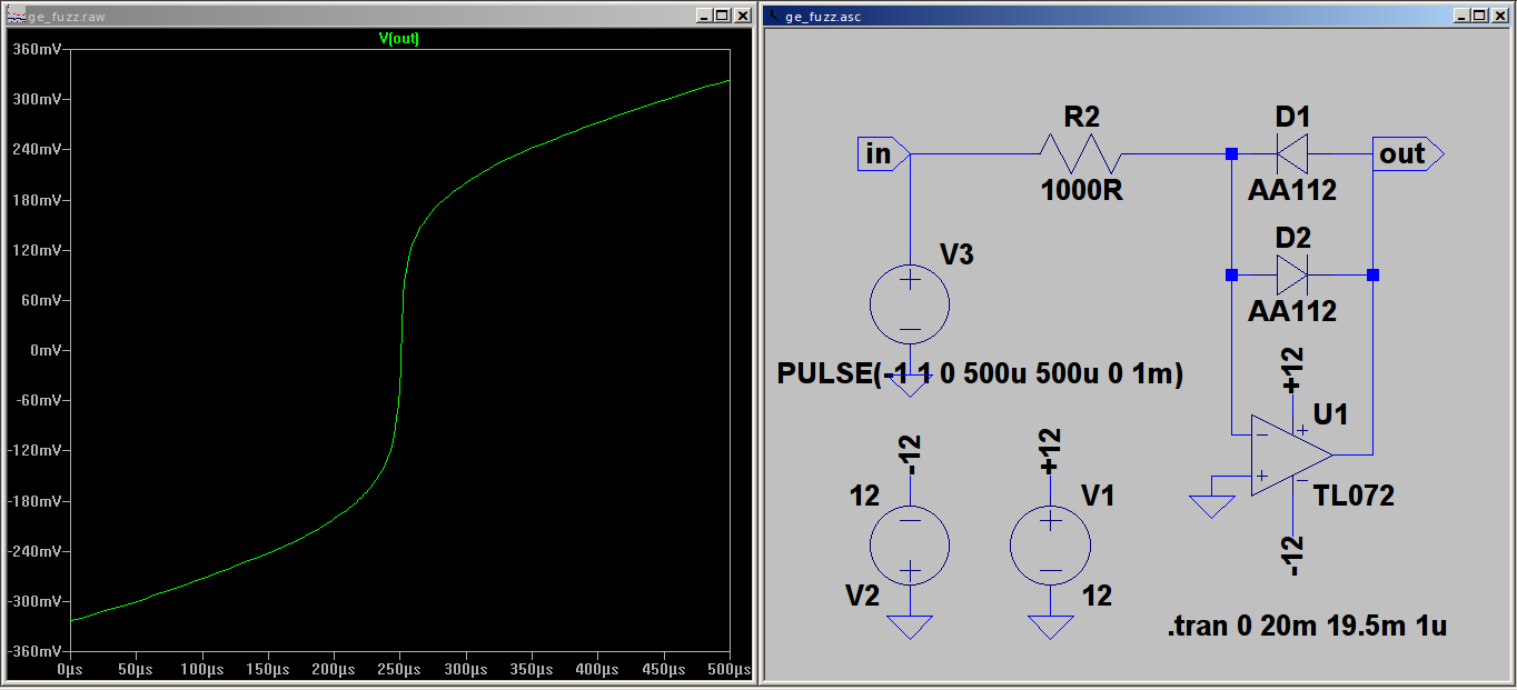

I did not simulate, I did a breadboard test with 2 antiparallel Ge-Diodes. Some AA112 if memory serves me - but this is long time ago. At that time I had no access to circuit diagrams of commercial fuzz boxes.
What happens if you increase the value of R2, R5, and R6? Looks like you would need less output current from the op-amp to turn on the transistors?...you need a beefy opamp...as it must be able to drive 10mA output current easily to 10V
-Gnobuddy
This particular circuit is analytically tractable - the current through a diode is a nearly perfect exponential of the applied voltage; when the diode is driven with a constant current instead, as in this circuit, it has the inverse response: the output voltage is the natural logarithm of the current, which in turn is directly proportional to the input voltage.I did a quick and dirty sim of AA112 fuzz. With a triangle input signal the output of a half wave equals the transfer curve.
To be a little more exact, the output voltage of this circuit is directly proportional to the logarithm of the absolute value of the input signal (because the second diode takes over when the input changes sign.)
Before there were digital computers, this circuit used to be used in analog computers - to calculate the logarithm of the input signal! (There were later improvements to reduce temperature coefficient, and widen the range of inputs for which the output is an accurate logarithm.)
-Gnobuddy
Voltwide's sim is a classic, I recall it as the my first working opamp circuit back when I was a kid and needed more distortion that what could be had from an old tube radio I used to use as amplifier.
While the transfer is smoother than with silcon diodes there are drawbacks. Output voltage is very limited, it's noisy, gain at low input level voltages is determined by ill defined leakage currents and while paralleling a resistor is fine to stabilize the gain it decreases gain significantly. To get more gain to begin with we could scale down the input R (the gain is R_leak/R_in) but then we see another problem popping up: the intrinsic forward path resistance which is higher than with silicon which linearizes the voltage because the current starts to get dominated by this resistance once it is higher than the "true" junction resistance for a given current, the diode becomes more and more a simple resistor.
Of course, given the simplicity of the circuit it's hard to beat.

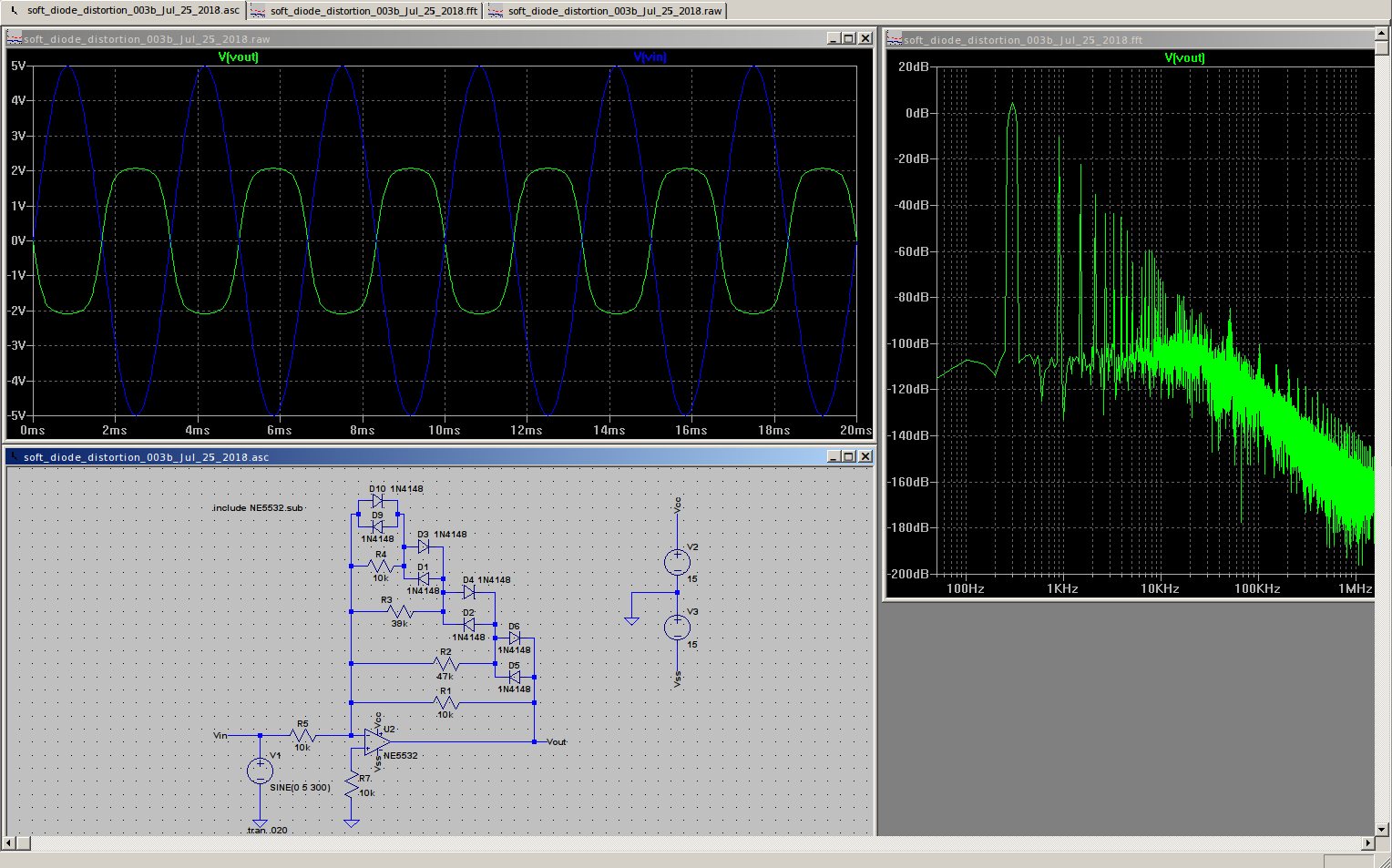

I have made only 3 diode stages, that's enough for guitar. Values are:
R4=47k
R3=15k
R2 = 2.2k
R1||D1||D2 are omitted.
Rin 2.2k is driven by another non-inverting Opamp with gain 22x. Distorion/overdrive is controlled only by guitars "volume" knob.

Thanks for sharing!I have made only 3 diode stages, that's enough for guitar.

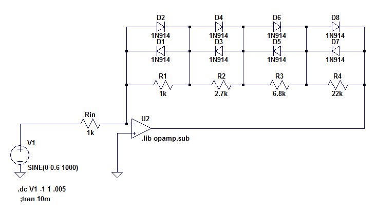

Years ago I had a similar idea, but I arranged the diodes to switch additional resistances in parallel, rather than bypassing more and more resistors that are in series. I would think the same transfer function (Vo/Vi) should be possible with either circuit (but using different resistor values, obviously.)
The FFT shows higher harmonics trailing off in level quite rapidly, and even overdriven to this extent, only 2nd, 3rd, and 4th harmonics break into the top 40 dB of signal dynamic range. Harsh-sounding higher harmonics are quite weak.
It has been a very long time since I built the circuit (1990s), and I was not much of a guitar player back then, so I can't really tell you how it sounds. Consider it a starting point for some experimentation.
As with Guitar.mod's circuit, this will want a buffer stage with gain ahead of it, and probably some frequency shaping to keep it from sounding dull and muddy.
I used an NE5532 in the LTSpice simulation, but a TL072 with its JFET input stage might be a better choice for this particular application.
-Gnobuddy
