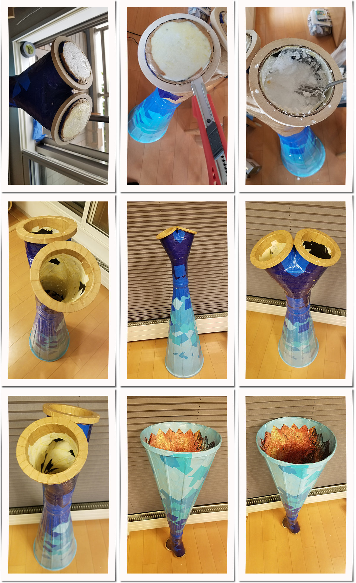

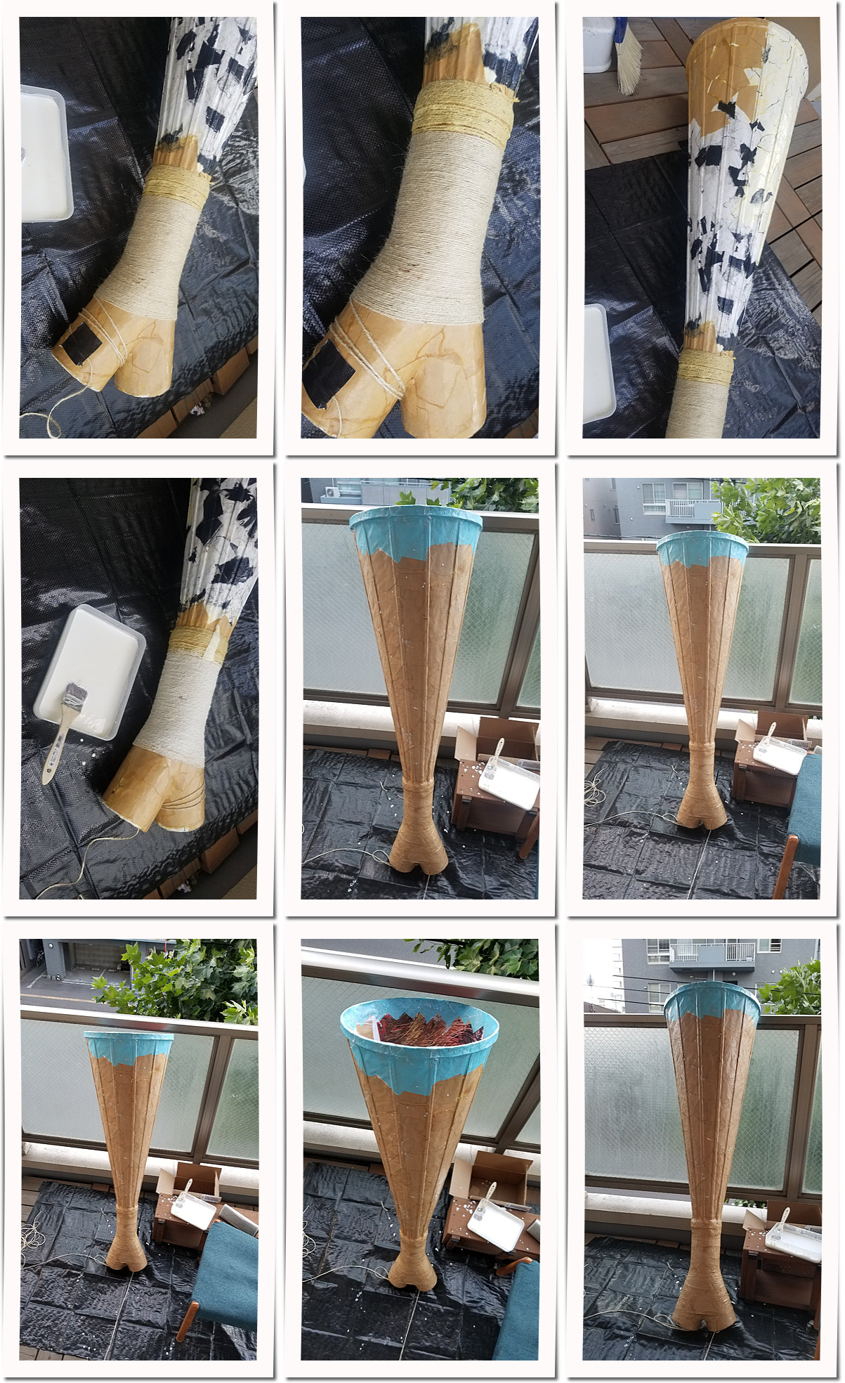

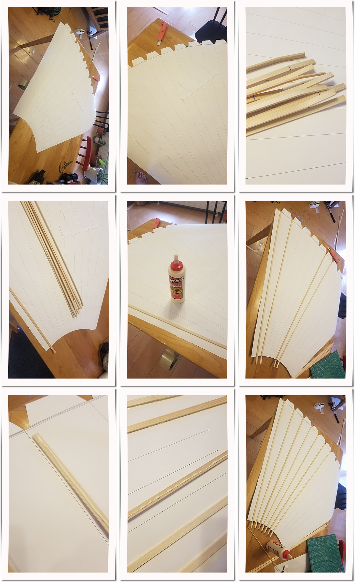

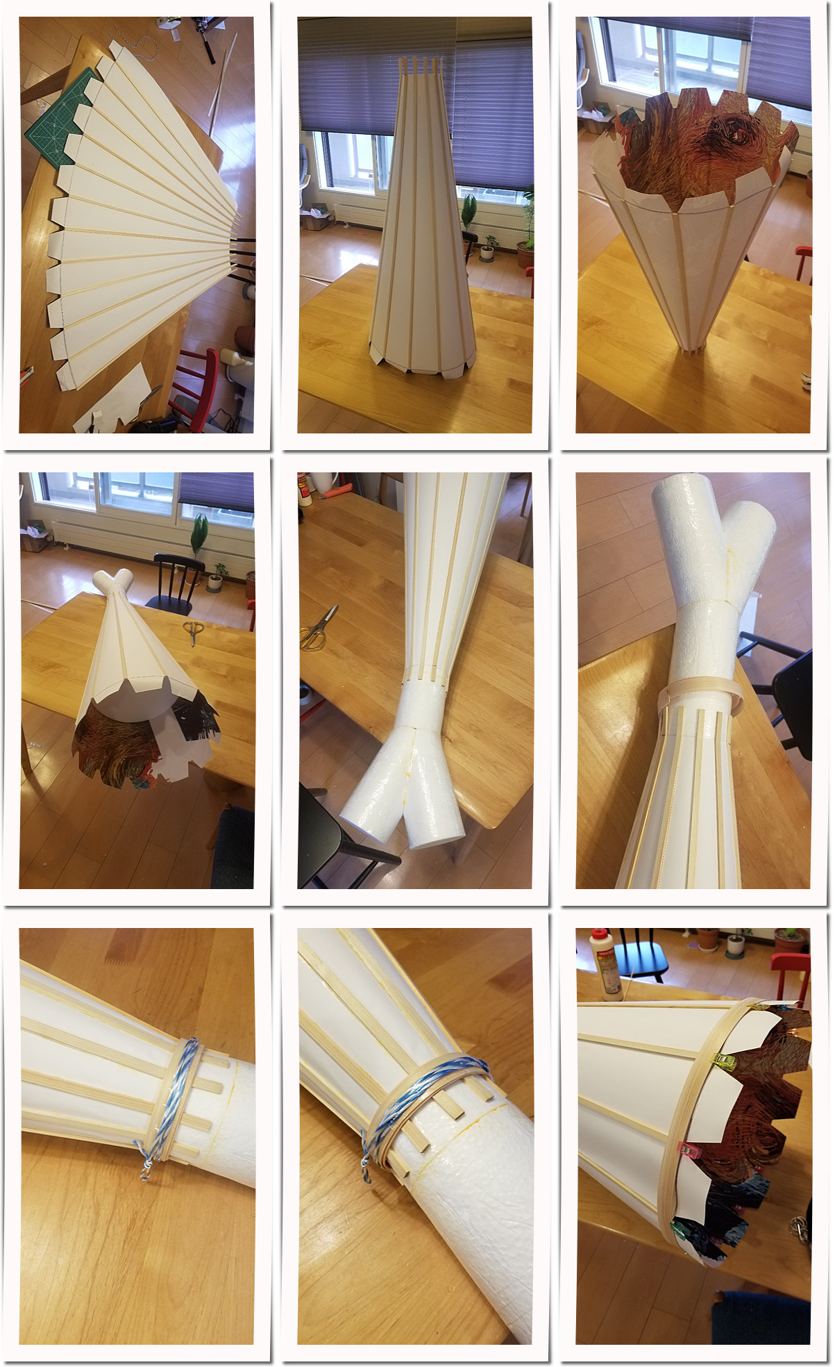

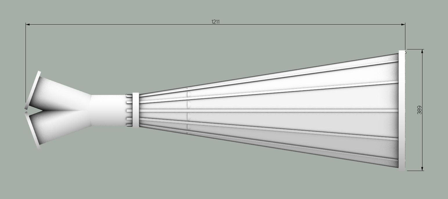

Work in progress. Building the first horn version with two 90mm drivers that I have on hand. 1200mm overall length.
Based on other projects on this forum, decided the fastest way to test the concept was paper mache. Designed the pattern in Rhino3D and unrolled it. Laid out on a thick paper that was printed on one side. Built a wood battened cone and laminated thin wood into supporting rings around it. The Y channel plug was built from EPS 100mm rods, cut to the angles determined by the CAD. Applied a few layers of paper mache, thick rice paper, then craft paper, wrapped the top section with soaked rough twine to get a thicker stiffer core and craft paper sandwiched it. Wood rings for speaker mounting. Finally colored paper to make it less scary looking when I am out in the world bouncing noise. Construction photos.
Conical horn finished weight is 1.4 kilos, has a good feel to it, wood keeps the shape very well. Sealing the speaker housings in and testing today.

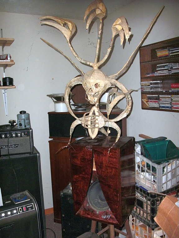

I can't draw, never did art other than a lopsided mache speaker head for 5 inch driver plus a Vulture-na-gig made with copper tubing, wire and paper mache - never got finished.
paper mache if strong would really be fun for little Karlson type speakers and "K-tube"

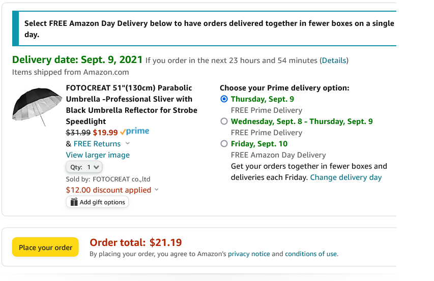

Hi Art
Regarding use of a parabolic umbrella -
What and where are the losses "through" the umbrella?
Could one use the umbrella as a mold or at least an armature with fiberglass & epoxy or wood glue and paper mache to reduce losses?
Is there a practical way to retain folding and line it with something to reduce losses?
A Faital 3fe25 or 3fe22 done like that article would work.
I'm still trying to find a larger bowl than 22" with appropriate shape but no luck so far.

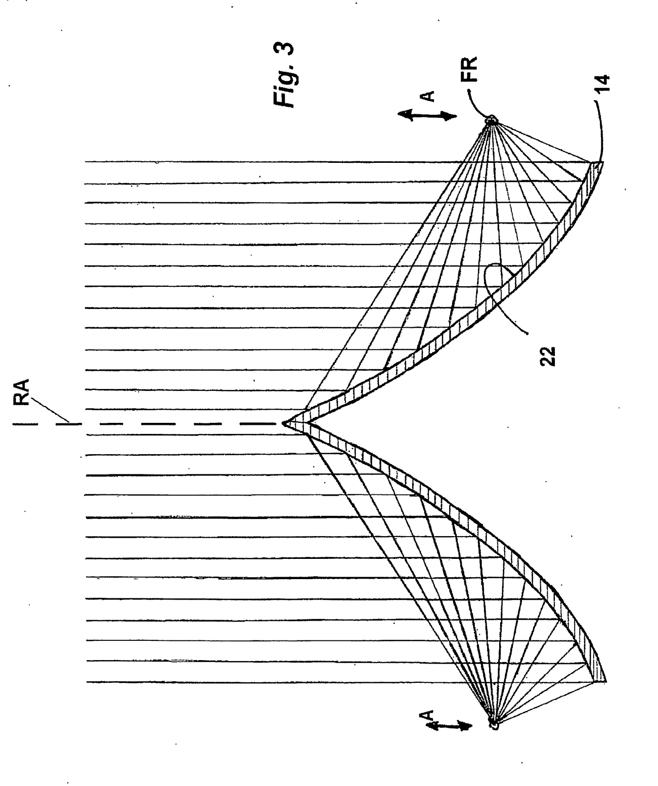

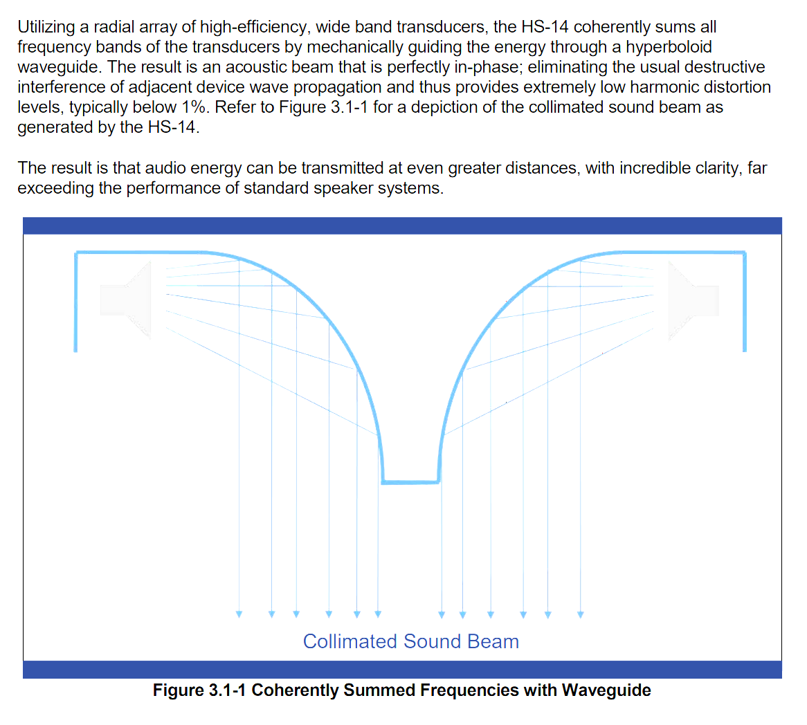

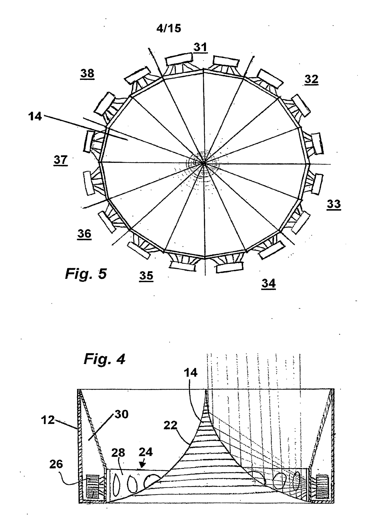

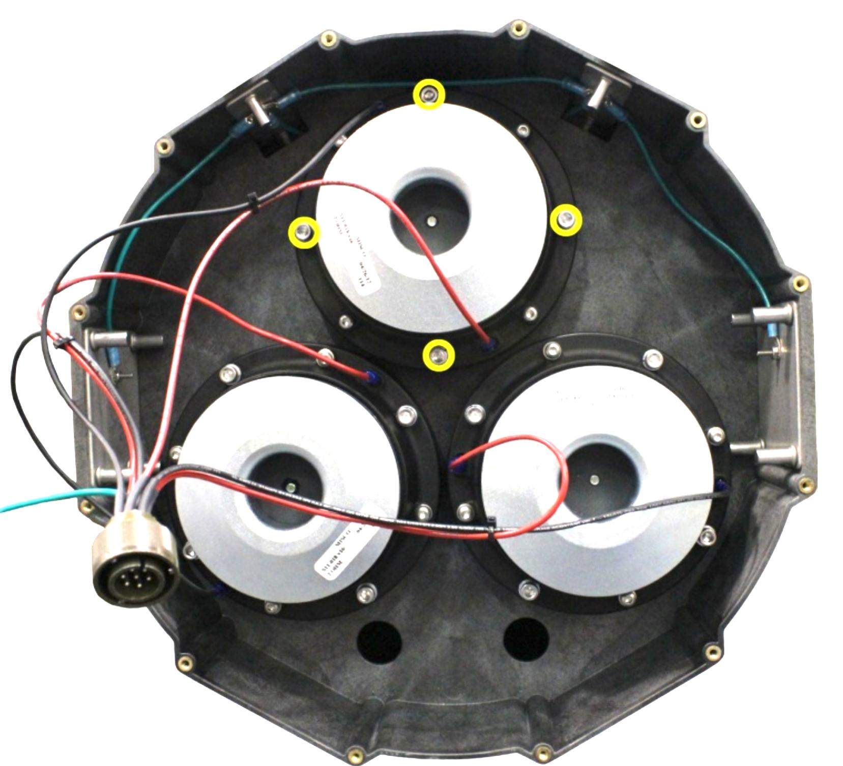

Following Art's #14 post in extremely narrow directivity speaker design looking up Curtis Graber's Hyperspike patents in published documents. Very interesting approach.
They invert the parabolic dish and put multiple speakers around the rim.
The spike in the middle of the dish. Appears to be more like an angel food cake pan in the production product. More central column surface to bounce off of.
Large transducers in the production model. Appears to drive a piston-like plate moving air into the rim of the inverted horn?

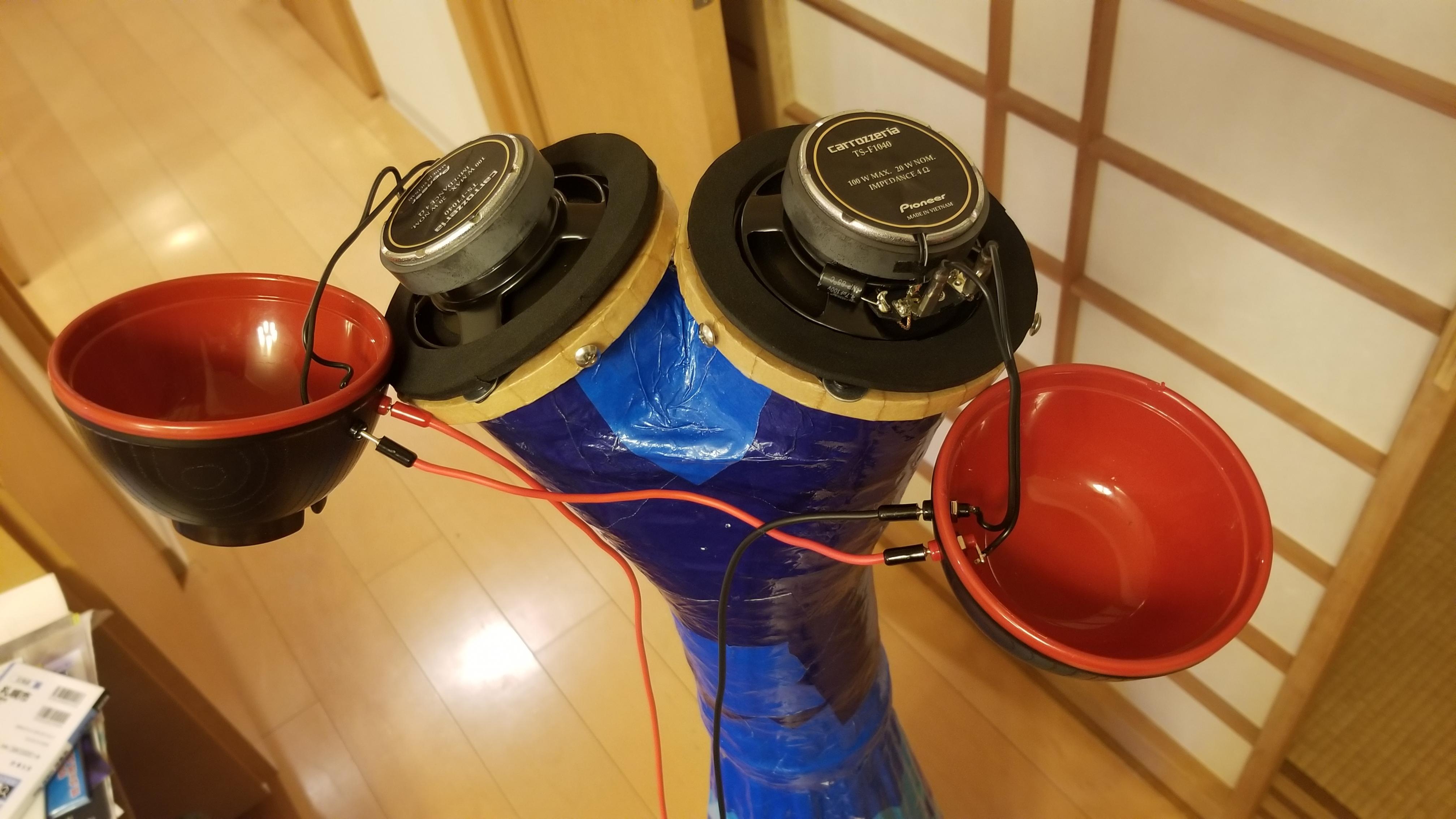

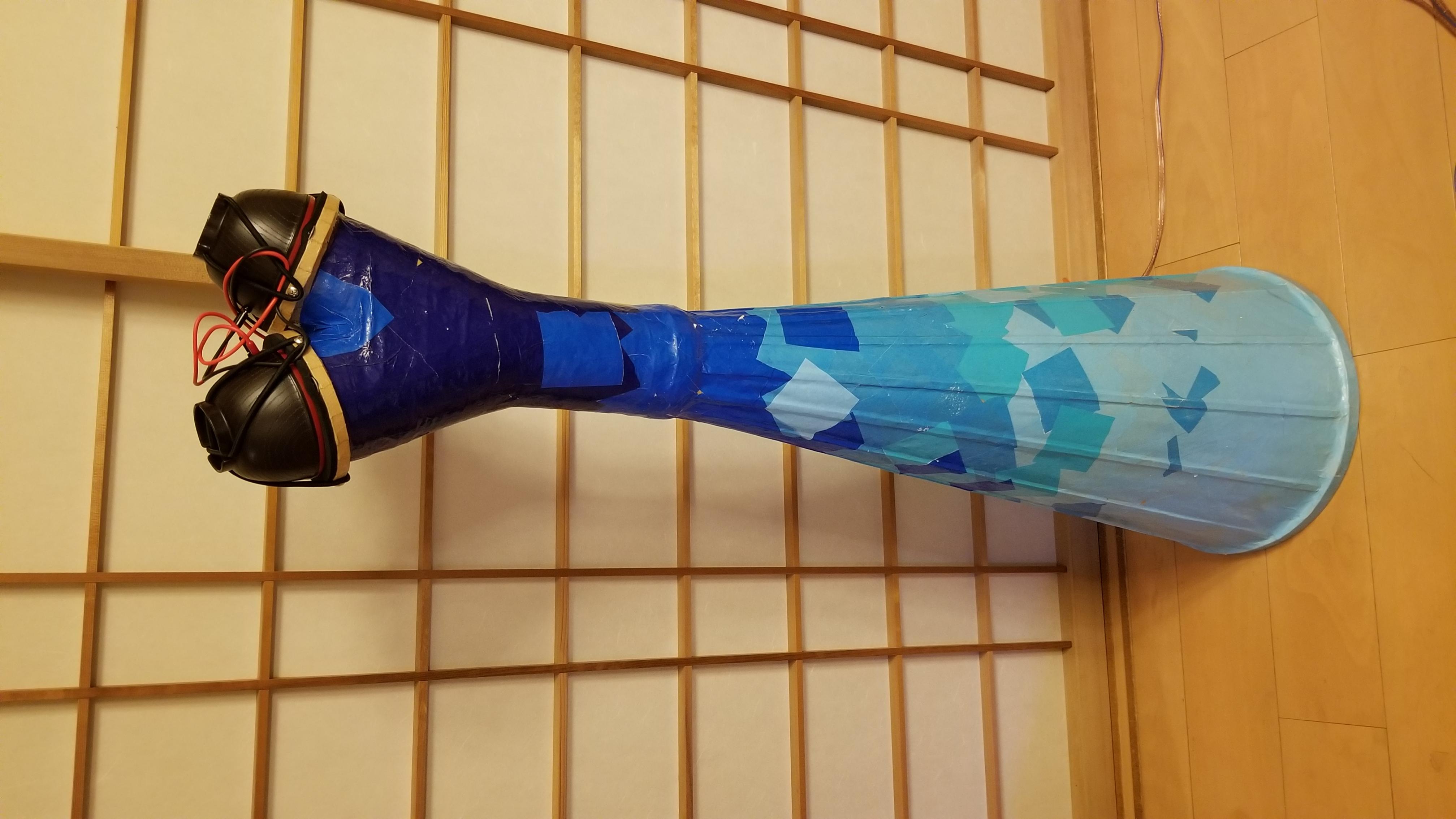

Functional prototype for testing. Indoor test cable tethered to amp initially. Works really well! It paints the synth sound around the room as expected. Will have to try in a larger outdoor acoustically reflective space to see the effect of distance and spread. Right now if you close your eyes and move the sound pattern around the room you can feel the space in a way that is completely new. As the operator of the device, you feel the main low frequencies close and the main sound being directed back to your ears.
Working on the portable amp and battery now.
The bowls are actually insulated double wall shells, quite a nice little containment.
