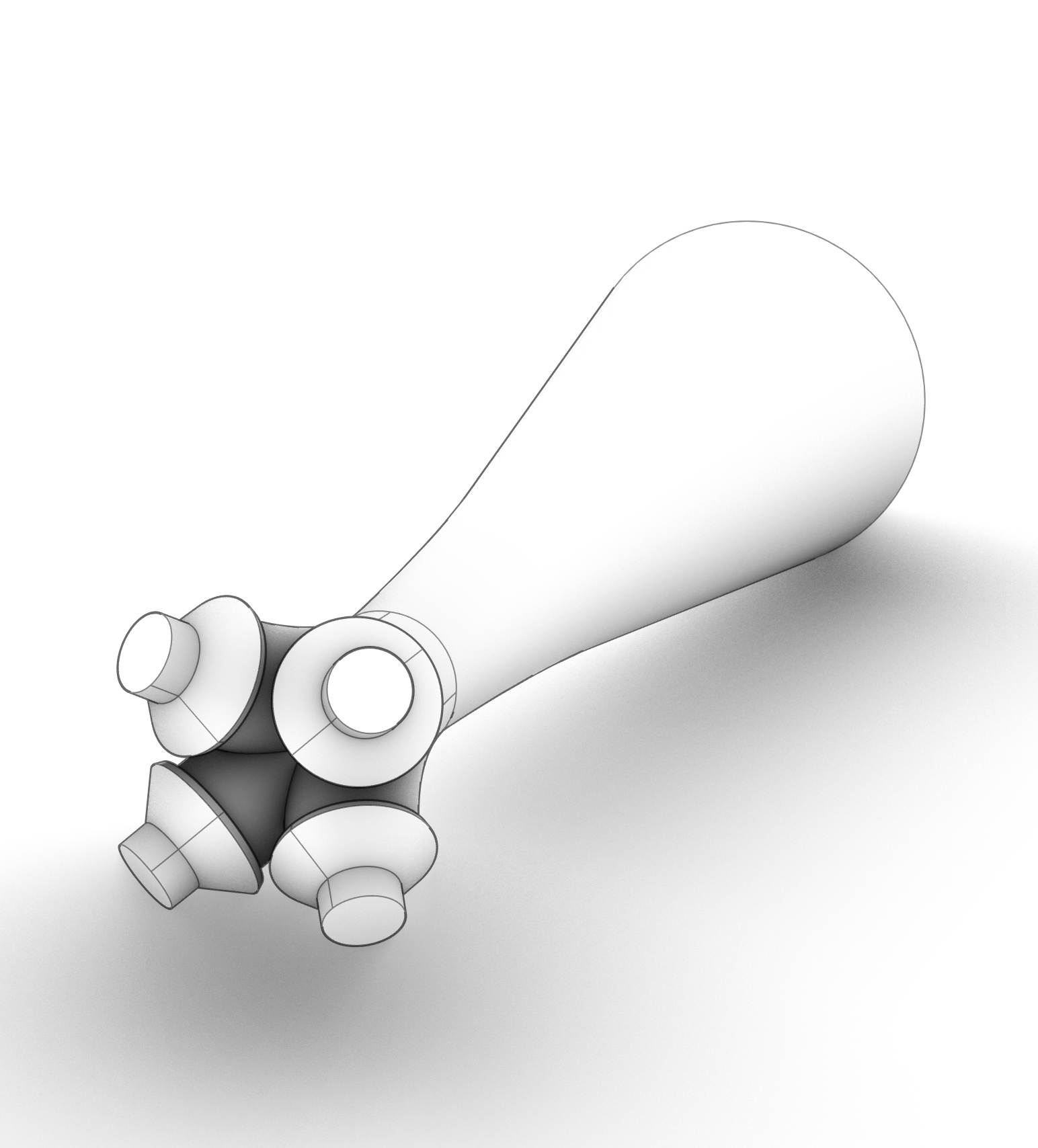

and i was thinking of the classic form that i've seen before which is configured like this
and in the last rendering without actual dimensions the fact that the channel after the last bend appears to reduce in size how is that not an acoustic low pass...?
The purpose of the rendering was to illustrate the mathematics of the parabola curvature.
In that illustration width of the channel slightly decreases as the diameter of the slot increases, the calculated dimensions result in a cross-sectional volume that slightly increases along its path. It was a concept. The prototype has a uniform width.
