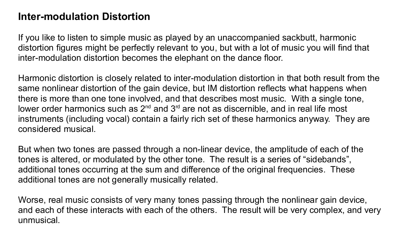

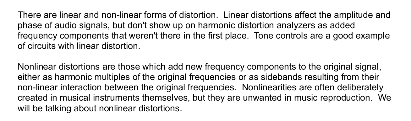

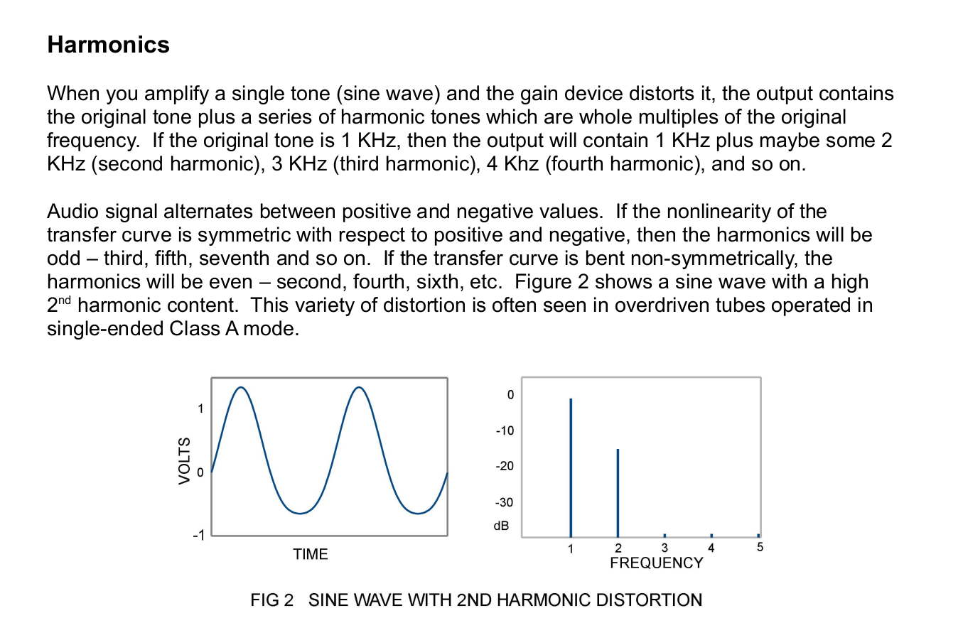

Din Don wake up greedy boyz 😛
at work.....learn at diyaudio.....https://www.firstwatt.com/pdf/art_dist_fdbk.pdf
