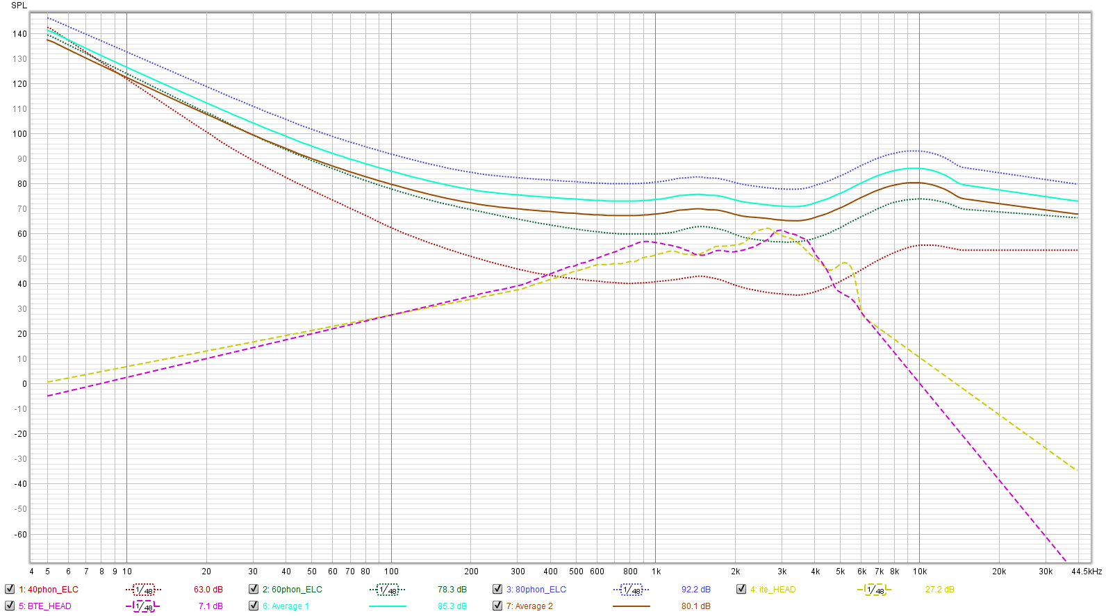

- The Harmon Curve is designed for headphones and I am not designing headphones so that clears that up.
- The House Target Curve is for EQing a room, whose purpose is to tune for the various room modes, damping, standing waves, and room acoustics all of which occur after the sound has left the speaker and as such should not be considered in the speaker design.
- Voicing a speaker with a V-shape or smile shape or any other shape is also perfectly fine if I want all my music to sound that way, but once set it's set, and a rather more practical/appropriate action would have been to adjust my bass and treble settings on the EQ instead.

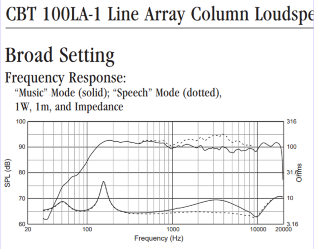

Isn't this also dependent on the speaker design?which occur after the sound has left the speaker and as such should not be considered in the speaker design.
Really? In mine I would want to switch in a 'speech' mode or high cut if they were passive xo...but once set it's set

Assuming you are playing back the recording at the same level as was mixed, flat response is more likely, on average, to result in "the sound as intended" than an arbitrary "loudness contour".So if my speakers are flat also then I should get the sound as intended.
That said, I seldom listen to recordings at the same level as they were recorded at, so often adjust the low frequency to reflect that difference.

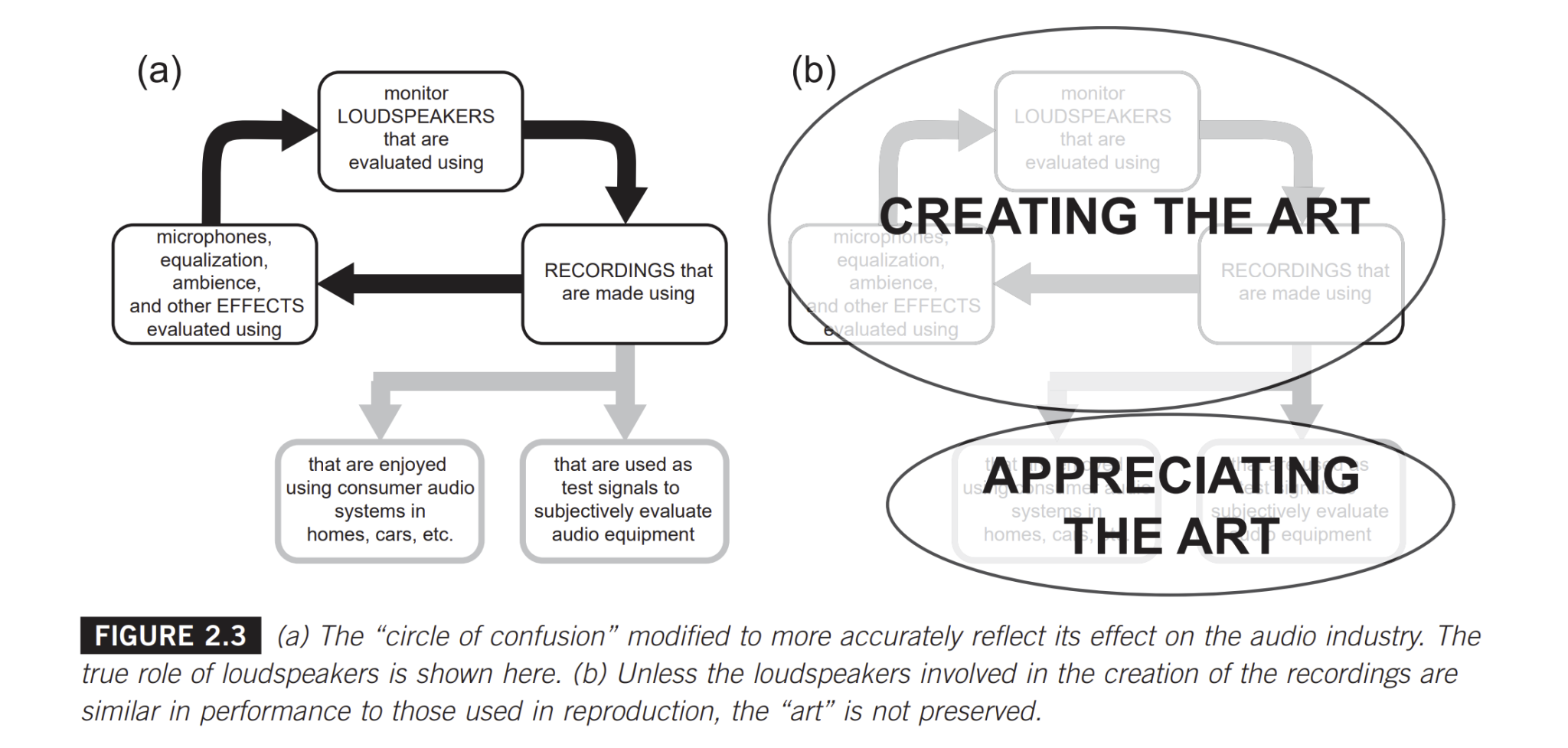

"Circle of confusion" The Floyd Toole book covers this.I would like to hear the music exactly as it was intended or recorded
From: "Sound ReproductionLoudspeakers and Rooms"

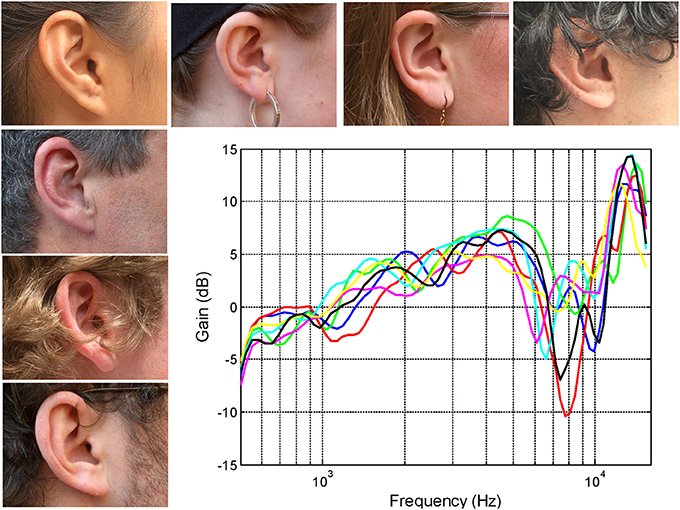

Back to designing for the head I always like this graph of a HRTF from a paper. It shows how different each person hears.
https://www.frontiersin.org/journals/neuroscience/articles/10.3389/fnins.2014.00237/full
Between the mystery of a recording's creation and the differences of a person's head from each other, I find it really comes down to just liking what you like along with some measuring to understand the preference.

The differences between heads are largely irrelevant with speakers. Everything an individual hears, produced or reproduced, passes through their single personal HRTF alteration downstream from the acoustic source. I'll never experience the world through your HRTF. A speaker that perfectly reproduces the acoustic vibrations a singing robin will be heard by all as a singing robin in both instances.Between the mystery of a recording's creation and the differences of a person's head from each other
Toole's circle of confusion is implying that recordings using EQ, reverb, and other manipulations are reproductions of original acoustic events. Those are electronic studio creations, novel productions with no strict manifestation in the real world. A comparative for judging accuracy of reproduction without an original acoustic is nonsensical. In those instances factoring the studio monitors is valid since, as part of the creation process, the studio monitors are part of the original acoustic event. Slipknot may indeed be more 'accurate' through Cerwin Vega than Revel in Toole's view. A robin doesn't care about studio monitors.
