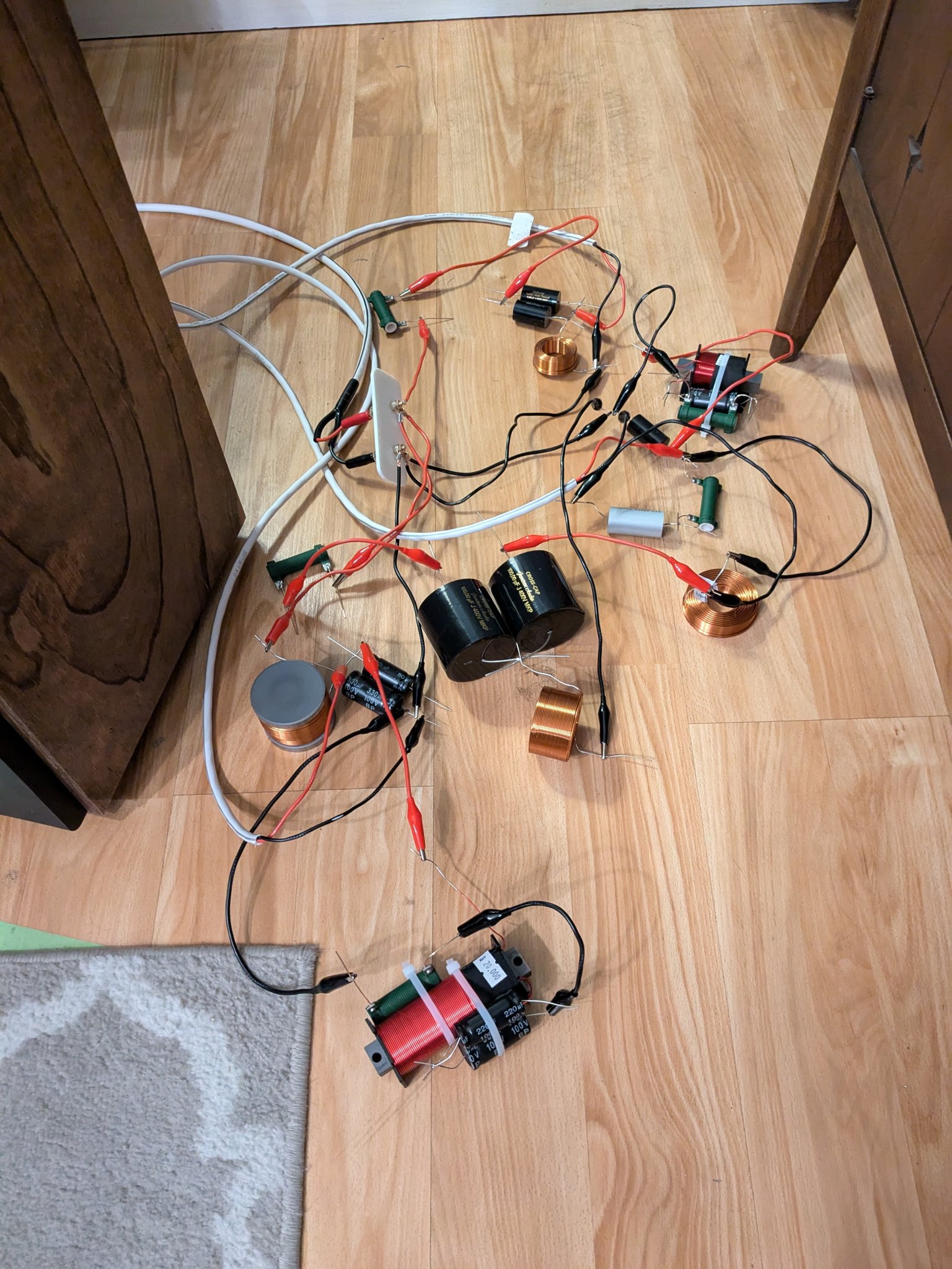

Assuming you haven't done a bunch of crossovers (sorry if this is incorrect), don't go into the process expecting the first try to be everything you were hoping for. Give yourself options and try them. Alligator clips are great for crossover development.

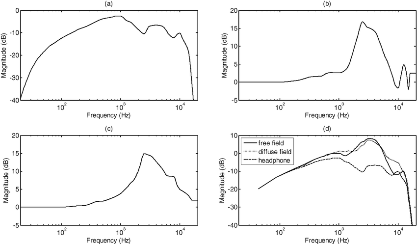

(a) middle-ear transfer function (b) free field to ear drum transfer function (c) diffuse field to ear drum transfer function (d) outer and middle-ear transfer functions for the three listening conditions: free field, diffuse field, and headphone.
https://www.researchgate.net/figure...um-transfer-function-c-diffuse_fig3_269099439
However, I think all this is adjusted for during mastering and therefore we only need to reproduce things as they are.
