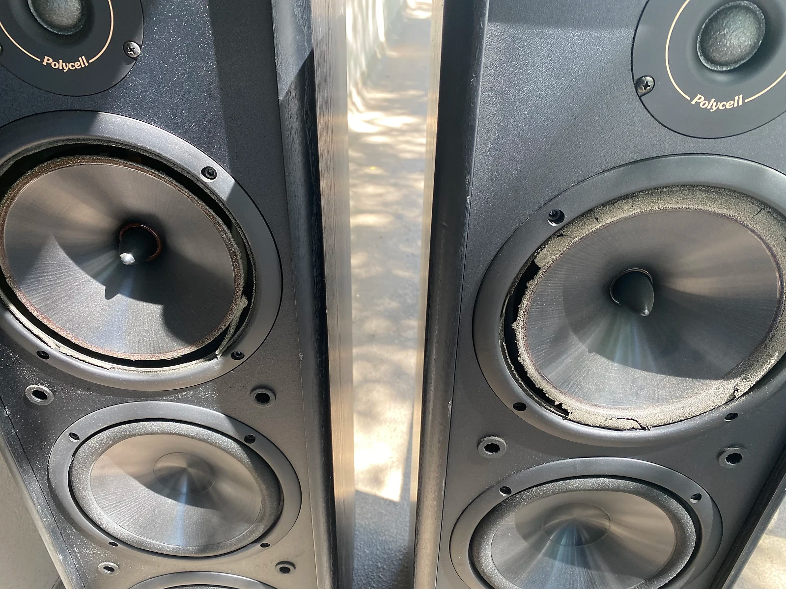

Torn foam surround has got to go. Experts can re-foam, that is not you. Small rips in the paper cone can be taped, but If you buy new woofers that problem is gone. Tweeters should be good unless abused by the wrong signal. Try cymbals or tinkley bell tracks to test tweeters. Mid, look & listen, they probably are not foam. I have paper+rubber surround speakers 59 years old that are fine (hammond organ). Disconnect woofers before a listen test, scaping voice coils from bad surround can short and burn your amp transistors.
DIstorted sound can be the e-caps in the crossover. Pull the woofers and look in there for cylinders with pinched ends labeled "xxx uf" or "mf" if the parts are old enough. These are time fuses to make people buy a new product. Partsexpress.com or simplyspeakers.com or madisound.com have replacements. 100 v rated ones sound better than 50 v rated ones, David Weems says in his book.
I wouldnt mind replacing the whole woofers but wouldnt know what to get
I gave you a link to replacement woofers in post #7, and indianajo has referred to them in post #18.
EDIT: Those replacements are $94 each which will let you realise what you are faced with financially.
P.S. Unless you actually test the speakers, you will not know which of the drivers does, or does not, need replacing, or which ones would be candidates for refoaming.
Refoaming disintegrated surrounds is by far the cheapest option.
Report back on the individual drivers once you have tested the speakers using the new cable you have ordered.

P.S. According to the photo posted by the OP, the foam has perished on the mids too.
A restoration which is not for the faint-hearted!
So After trying them out the 10 and 4 woofers doesnt work... I think its gonna too big of a repair for me

The 10" woofers and the 4" midranges don't work in both your enclosures? Certainly not a repair for the faint-hearted!
The Infinity RS-625 tower speakers to which you link can also suffer from foam rot (see my image below), so it's a case of inspecting carefully before you buy!
In fact, you should probably avoid second hand speakers that employ foam surrounds and look for ones with butyl rubber/PVC surrounds.

I think it is ok to refoam the speakers, which is simple compared to full diaphragm replacement. Did this with our quite old Infinities successful. The re-foaming kits were available somewhere in the Netherlands.
Indeed... I got 50 year old speakers with rubber surrounds still going strong ( new caps in crossover and new coil/butterfly in one woofer )...
But the foam surrounds I got in another set ( made in the late 90s ) gave up the ghost at 20 years. The factory shipped me a new set of PVC replacements.
